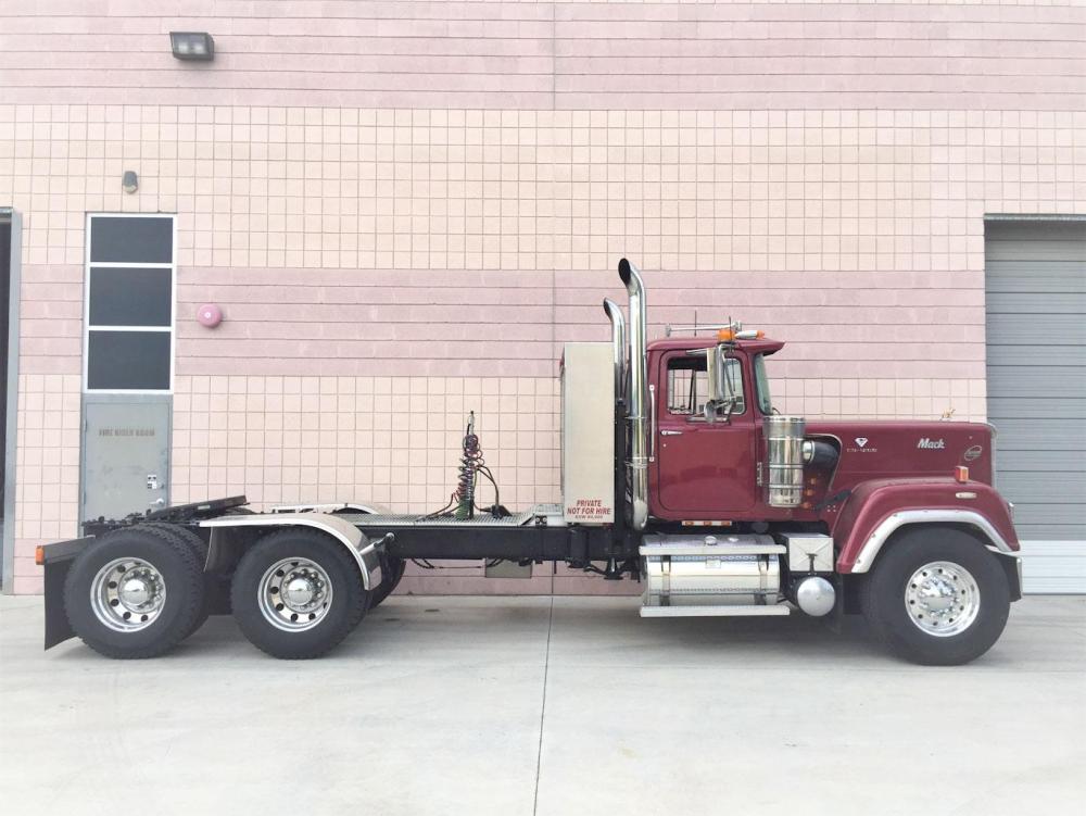

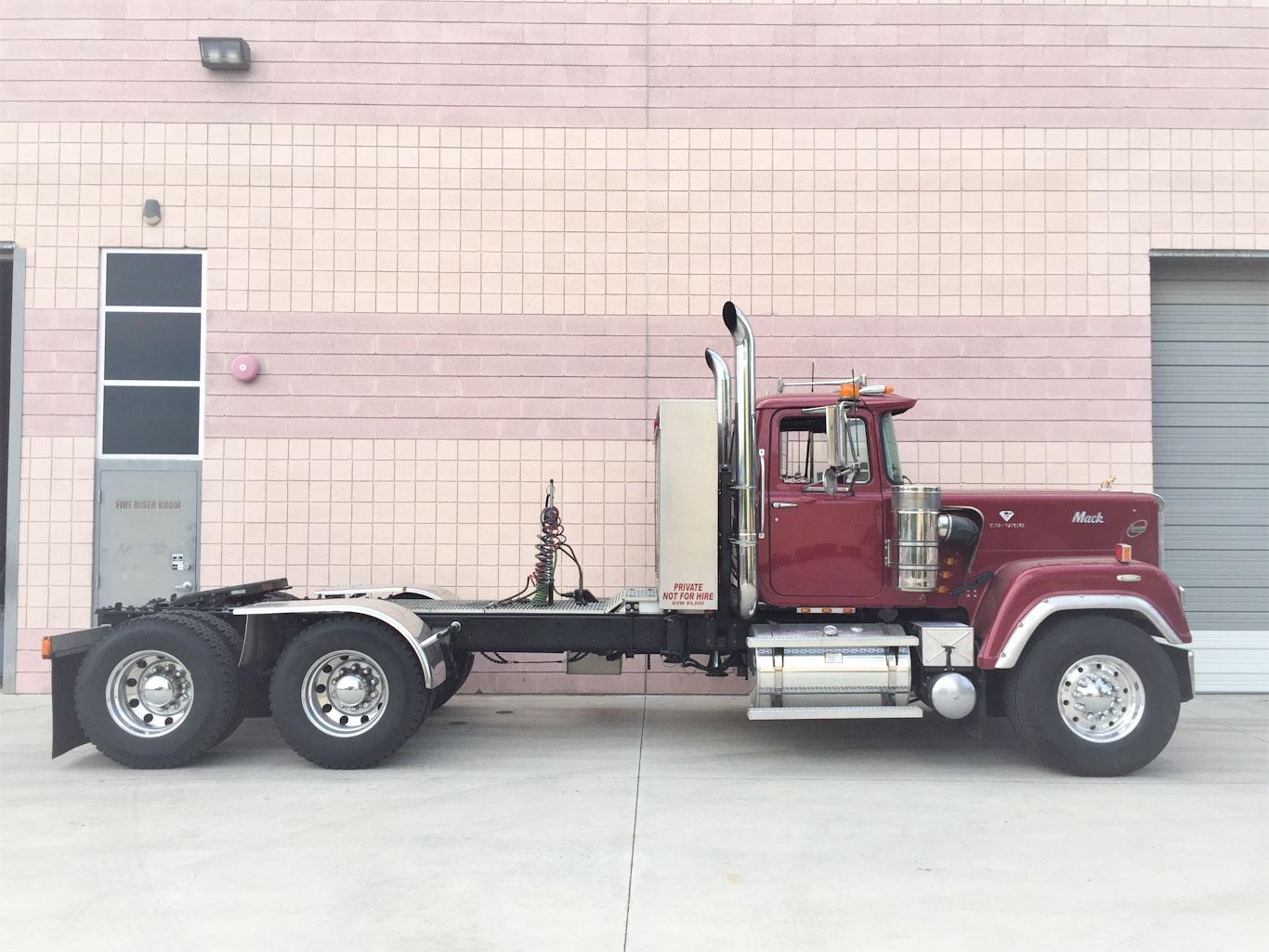

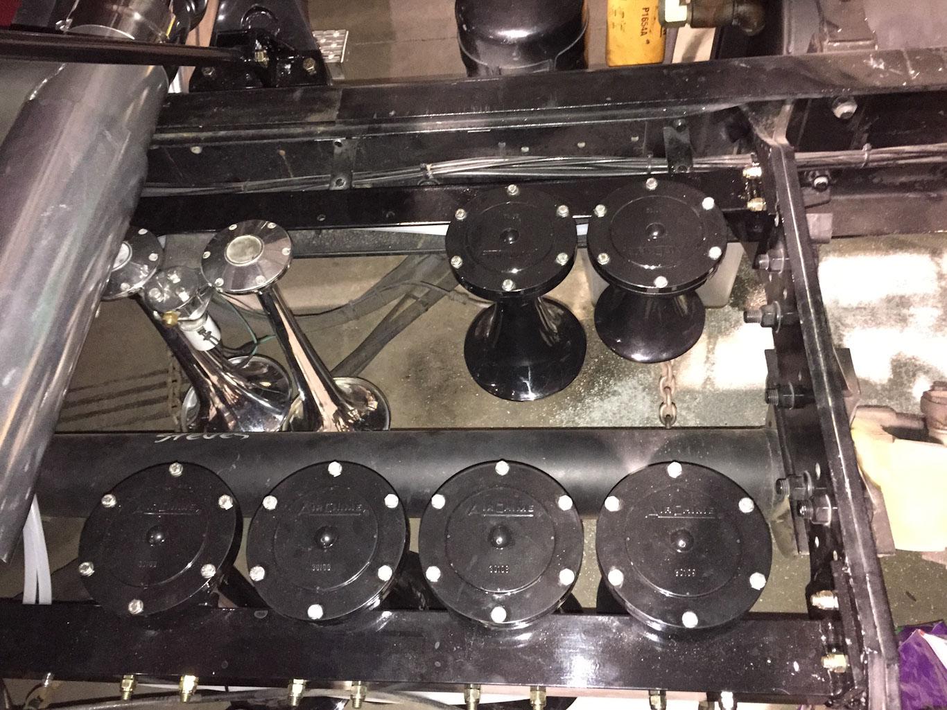

I reframed mine from the cab back last year. We got the rails from pg Adams, they however are not able to duplicate from the cab forward due to the complexity of the rail. I tried getting new ones from Mack, as I remember there was a good part number for them, but there was no response from Mack as to availability. So I eventually figured that meant no

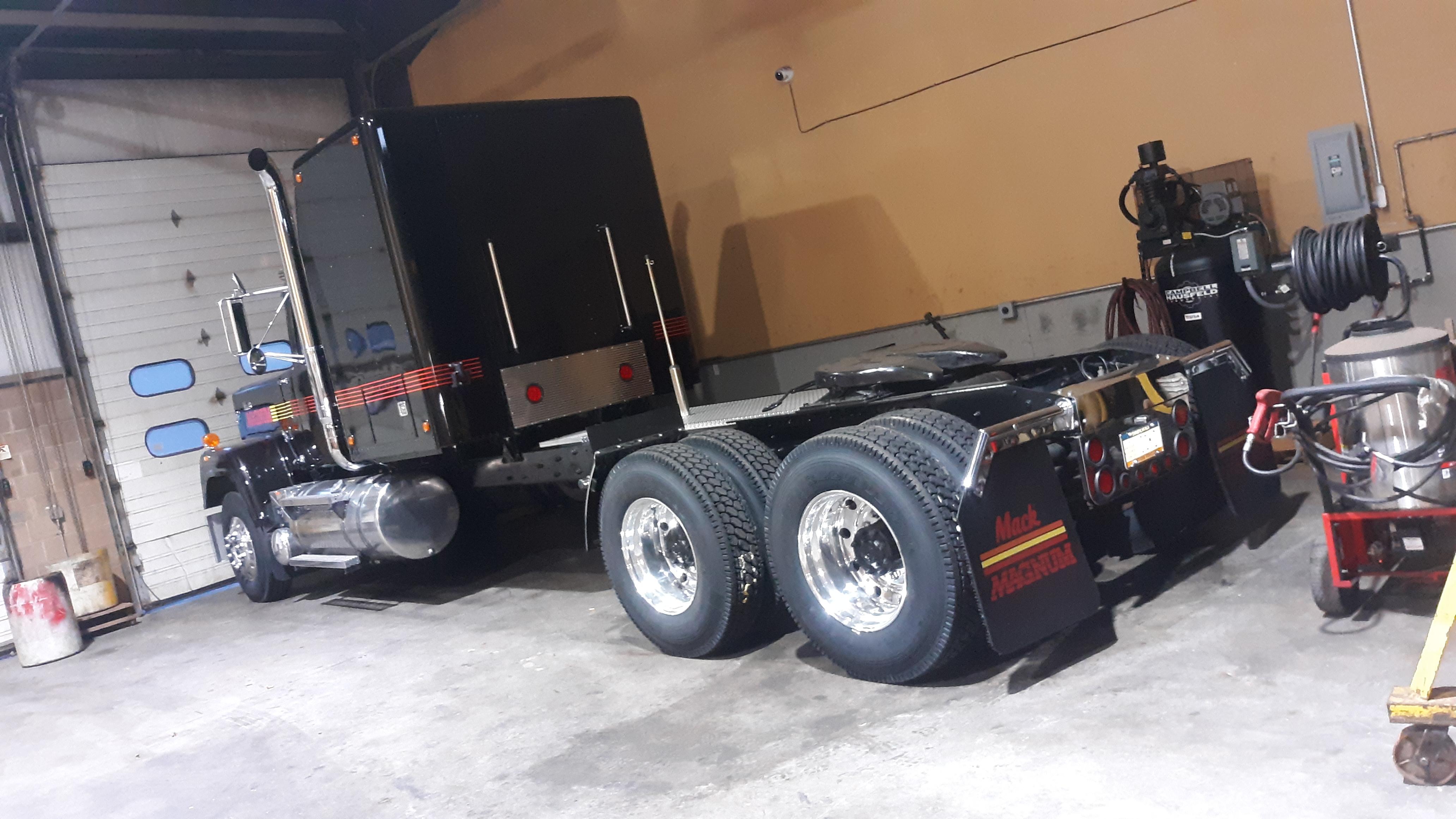

Smalls1184 do you have any pictures of the new rails you spiced in from the cab back? I'd like to see how you did.  Someone put older freightliner air ride on my magnum and I'm not feeling it at all. Looks good, rides decent but it pains me to see it on there.  I found a neway cut off that I am trying to get now so I can order rails from pgadams .
