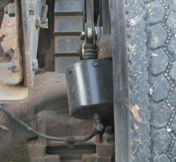

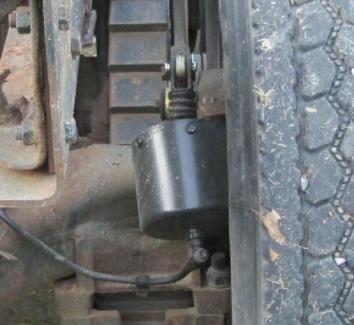

Not sure which type, I thought they were rotochambers, but they have a piston I'm sure...I want the steel early style spiders and brakes so I can put modern brake chambers on...plus, my spider casting (chamber mounts) are all bent!

Those are the piston type chambers, size 20 cubic inch. You should be able to heat those and bend them back, then install type 24/24 type chambers directly in their place.

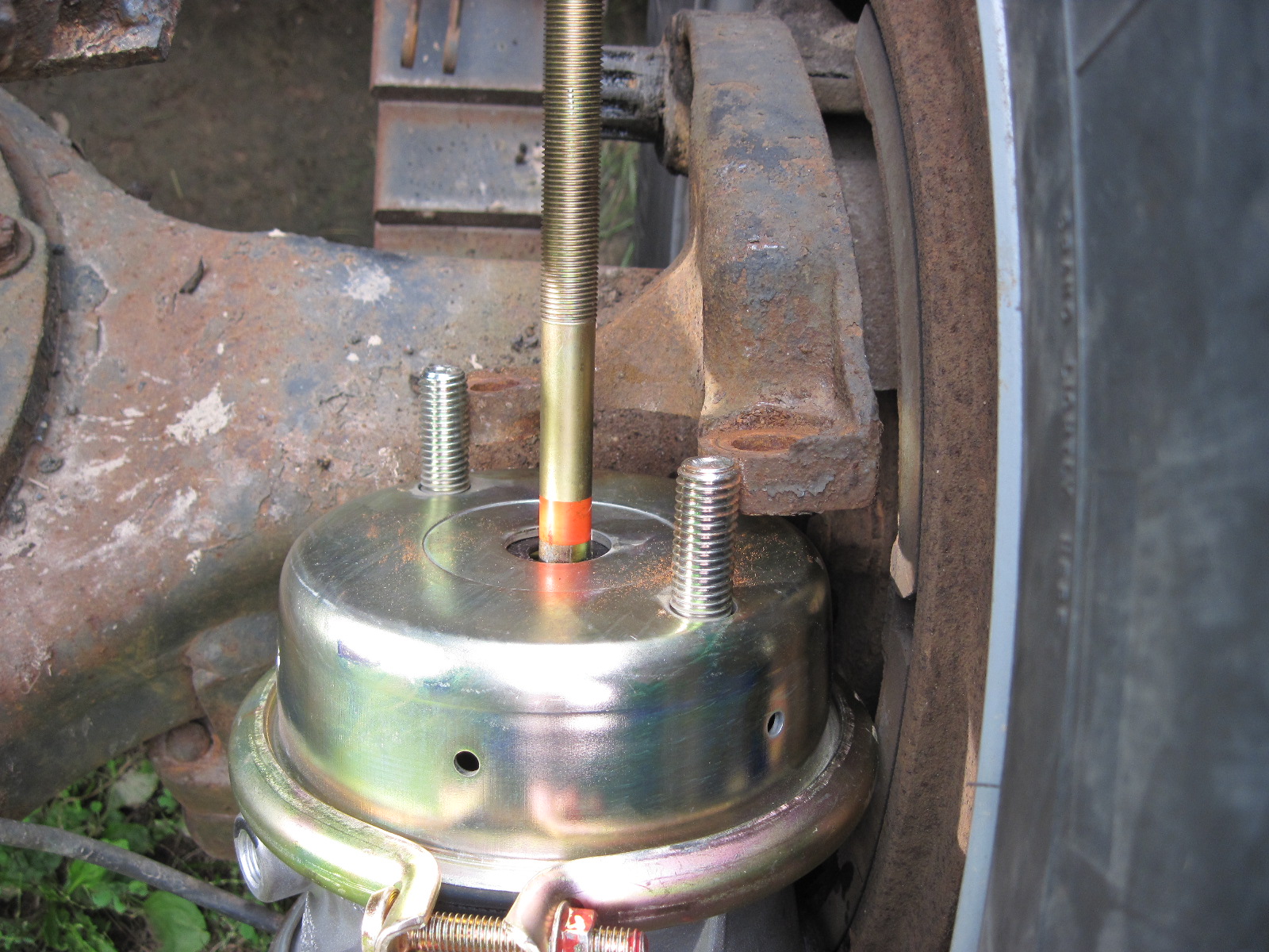

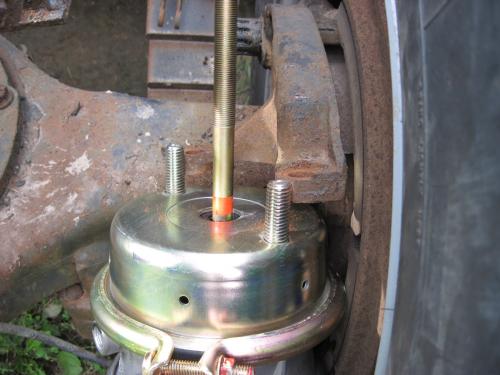

Bent or not, they will not fit!

I didn't realize you had the "thick" castings. No, they won't fit as shown. It can be worked with however. Would you be interested in four of the offsetting brackets if I have some made? It would keep the cost down to have more than just a few laser cut. You would then be able to run an offset slack adjuster and add spring brakes.
When I checked last, if they layout and cut 100 of them, they drop in price quite substantially.

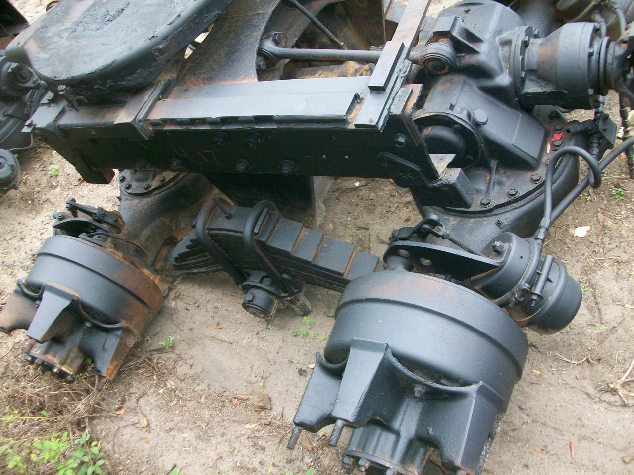

Thanks Rob, but I will probably replace the entire rears eventually for a more favorable gear ratio...plus, I really want 4 spring brakes, and even with offset brackets, I could not use them (without "clocking") on the front rears as the chambers point "backwards" and spring brakes would hit the springs...
They style I really like (mostly aesthetics) are the early version stamped steel where the front rears face forward and are angled down....I just have to find the years and models they came on,,,

My 72, 77, and 78 R models have that style. I plan to use the 72 spiders on my 58 B model as a drag winch truck with four spring brakes also.
