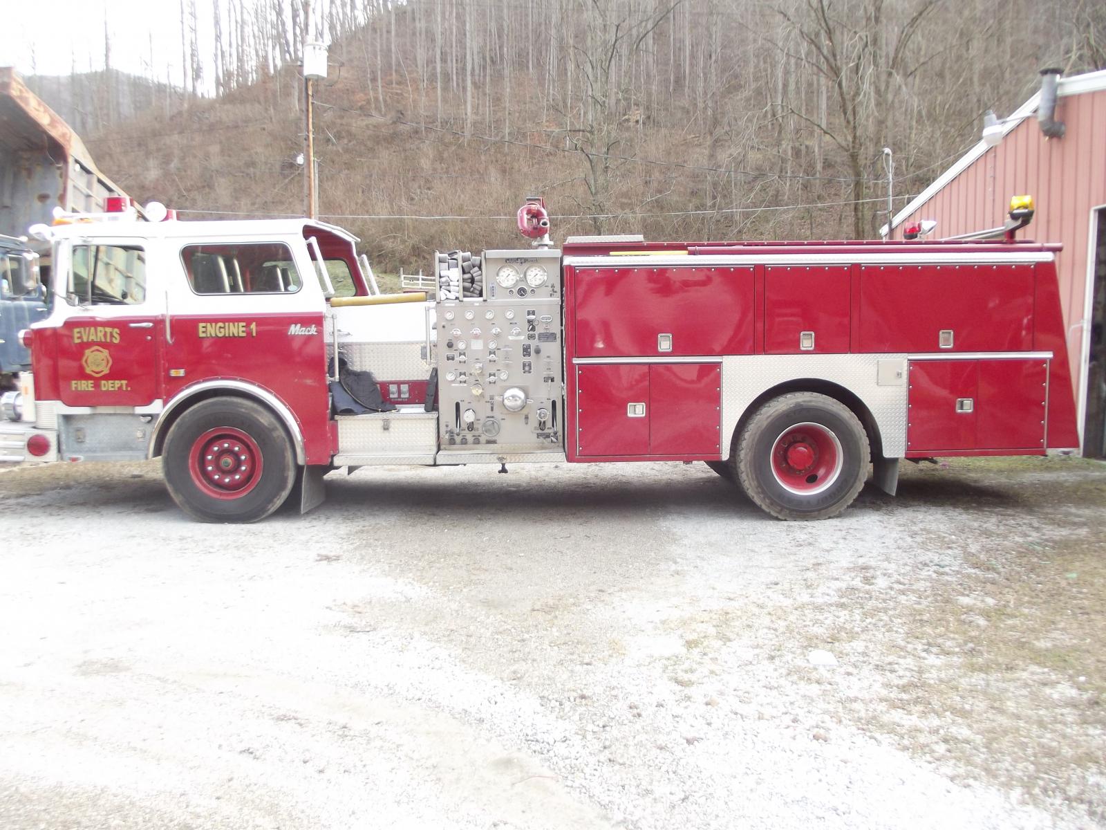

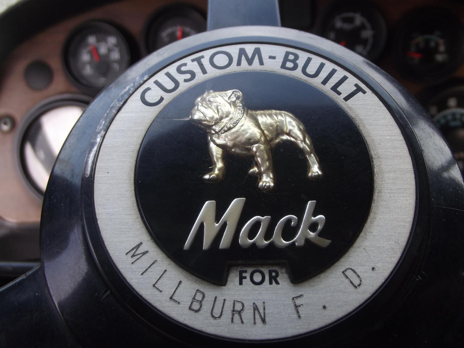

all 4 batts are new but that dont mean much as could be a bad one. i just got back from checking truck out and i think you might be right about the draw they have 6 lights (hand held) siting in the chargers and the lights are direct connected the batts they are taking the lights and chargers out for their new truck right now so hopefully that might be the prob. the truck is a 87 cf600 1000gal tank 1250 gpm pump lots of storage and a 10,000 watt onan genn on it. its a good truck and we have fought fire with it several times as mutial aid as it belonged to a neighboring fire dept the truck was refurbed in 98 with a new body all alum only has a little rust in the floors of the 2 jump seats but that can be easily fixed with new tread plate. the truck is suposed to be delivered tonite and i will try to get some pics. the horn button has custom built for millington F.D. on it but dont know which millington. where is the ser# on the frame located the door tag is missing id like to get the mack museum to send the info on this truck.

There is a Millington in Delaware. Don't know if they used Macks, but it is definetly Mack country.

The is a Millburn FD in KY, so that would be the logical choice. Internet search also turned up a NJ Millburn.

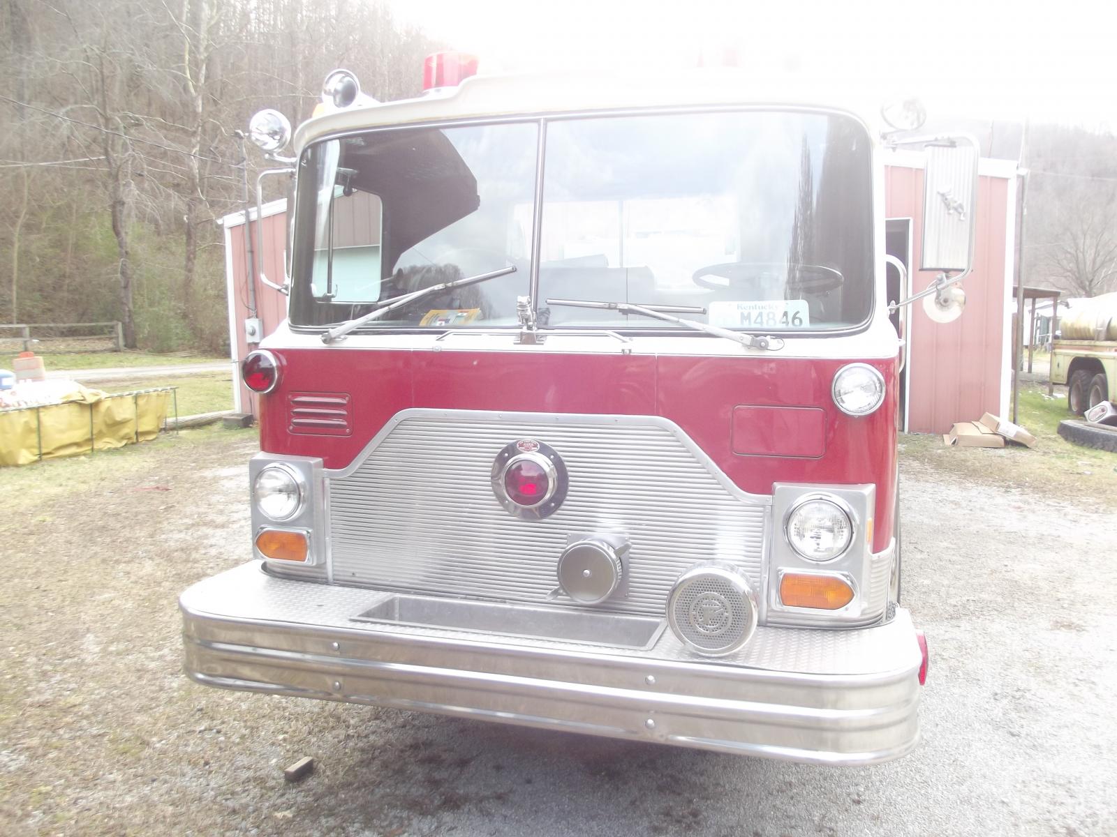

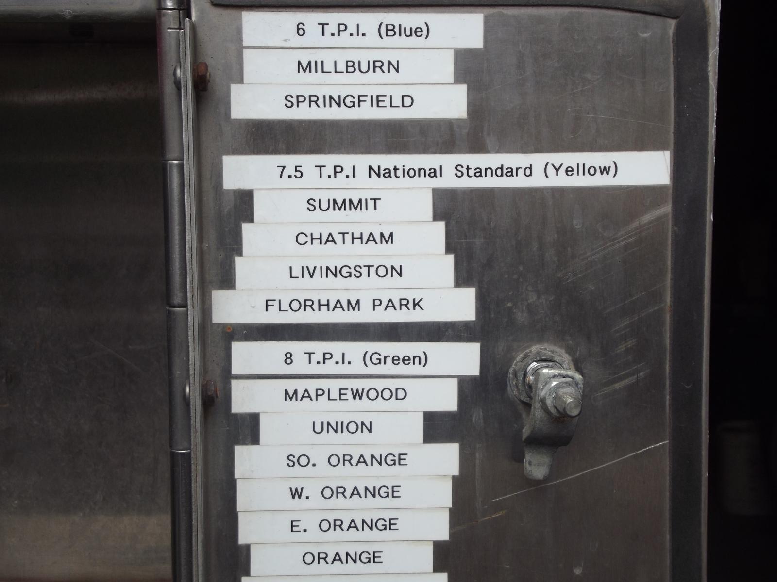

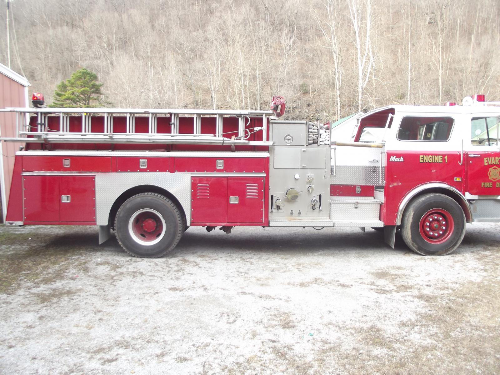

they paid $5,000 for it. there is a radio compartment beside the pump pannel that has about 10 dif fire depts listed ill try and get a pic of it but i would bet its orig from Nj. the other department that had it is only 4 miles away and they had it for about 5/6 years and they have the sister truck to it but it is about 3 feet shorter it dont have the extended front bumper and the rear over hang is a little shorter.
https://www.bigmacktrucks.com/topic/22840-new-firetruck/#findComment-99690
i talked to some people on the millburn f.d. today when i got home from work and to my suprise the guys i spoke with remembered the truck well. and they had all of the service manuals and all of the orig paper work for the truck and he told me that they would ship everthing they had for the truck to me. he said that it was the first automatic truck they bought and that it has a EM6 237 engine. they are going to send pics of truck fighting fire when it was new and i am going to send them pics of the truck now so they can see that their one time pride of the fleet is now the pride of the fleet once agin. they sold the truck in 1997.
