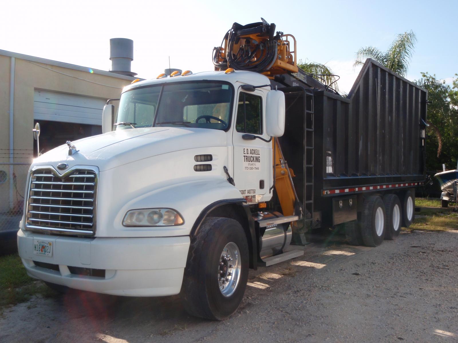

This is what I run. 50 yd box but never near wt, capacity. Its all volume.
Having the tag axle all the way back, I can level out truck when dumping, but I have off loaded with the boom several times.
