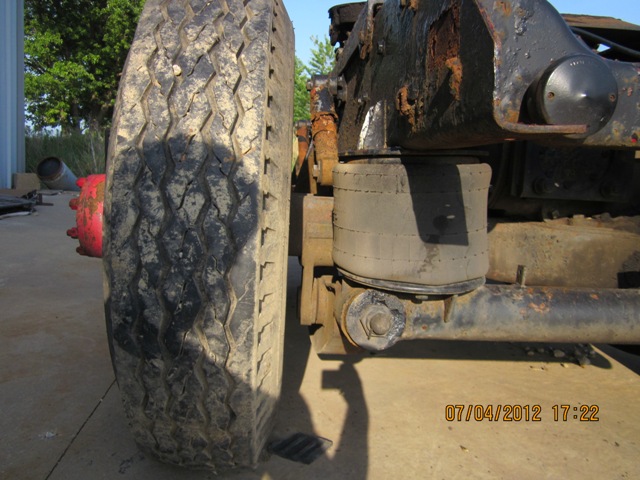

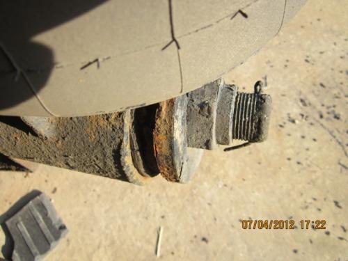

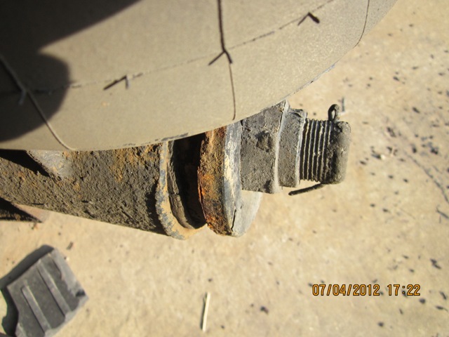

I need to get new batteries for the camera today to supply photos but the bushings in this thing are absolutely shot where the swinging arms mount to the frame mount. I don't think they are metal to metal contact yet but are very badly worn out. I'm not going to do anything with it for the time being as I honor a promise to myself to not take anything else apart until something is back together.......
I looked all over and did not see any identifying marks, or numbers but have not pressure washed anything yet. I'll have to get me another "skinny guy" around here as I do like to keep things greased and adjusted. I'd never be able to do it myself.
Loosing it? I'm afraid you got a ways to catch up to me on that one Steve.

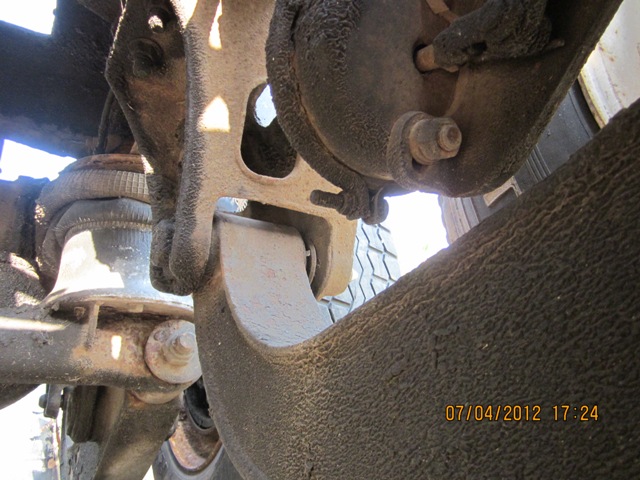

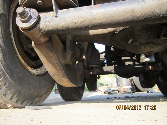

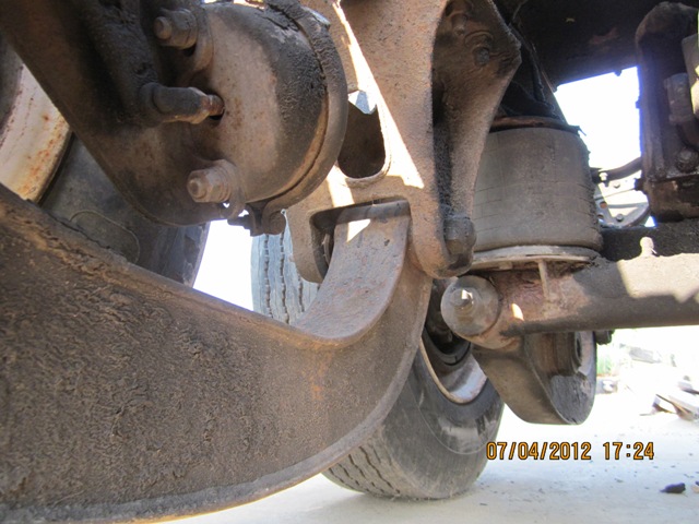

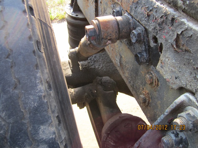

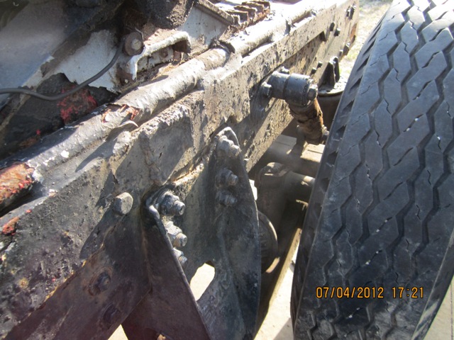

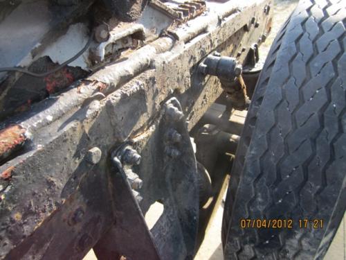

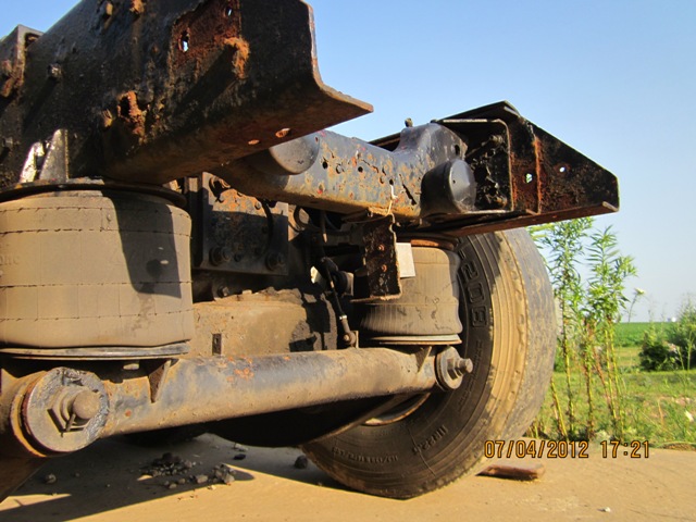

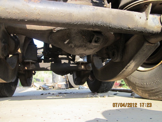

Looks like an ARD 125-8 in a quantity of two. This however is not decisive as the air bag mounting pads on the transverse beam for the air bags are flat and not angled. The front hangers are also rounded at the top and differ from the center hangers which are concaved at the top. I do have the angled shock absorbers as shown in the link on both the front, and rear drive axle.
Don't think there is a single bushing in this rear assembly that can be reused. It is 3.86 ratio however and I'd like it for the truck coming from Nevada for softening up the ride and a little better road speed. The brakes and all hardware including drums are shot beyond reuse also. None of this matters as all gets replaced anyways.
Thanks again for the link. Now that I've seen an exploded parts diagram I know what I'm up against and not afraid to tackle the job. I built a portable 20 ton "C" frame press for king pins that I think can be adapted to push horizontally, (with a couple of adapters spun out) to push the pivot bolts out of the bushings in the arms. I'm certain they will be stuck fast.
The frame is scrap and not planned to be reused. The truck in Nevada is an RL with an aluminum frame and the outside measurement is perfect for this suspension to roll under without modification.
Rob

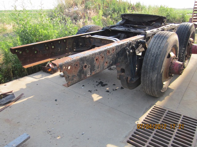

It is pretty rusty and cut off with a torch. I have no need for it but will take it apart easily to see if you can use it. It has "stick out" of about five feet in front of the fifth wheel section. After rebuild the whole unit is going on an aluminum frame truck so I have no use for it. Do you have anyplace in Ohio I could drop it off at between say Columbus, and Canton? I get over that way seemingly often. I've not measured but may need to keep the xmembers for the spacing.

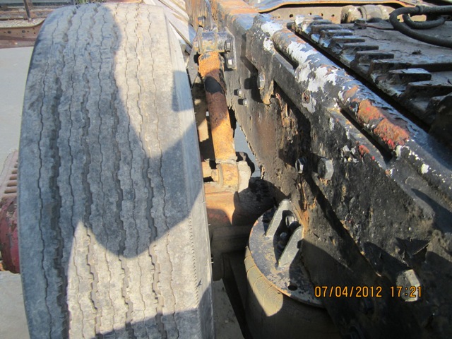

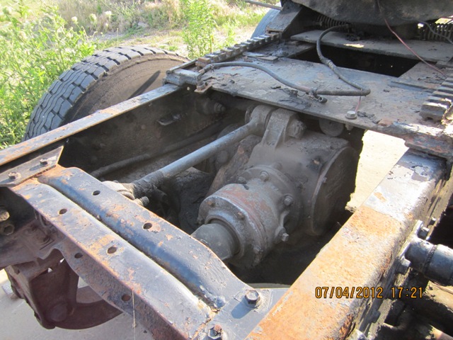

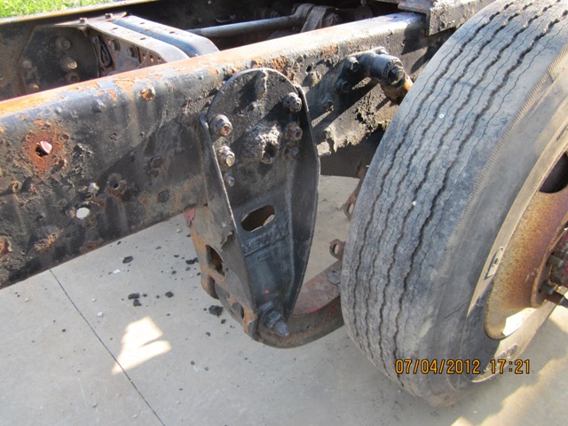

I just snapped more photos and the frame really is scrap. Many of the holes are not bored for mounting but rath torch cut. The suspension mountings do seem intact and there is no spread between them and the frame but the frame is definatly seen better days.
The rounded top on the front mounting hangers is a bolt on item. The hangers themselves are concave at the top, and they are the offset types represented by "Type 1" in the nomenclature.
I'm really happy with the PG Adams rails myself but I didn't have them do any drilling, just forming. I have a Hougen 505 "rotobroach" setup I purchased for this purpose.
