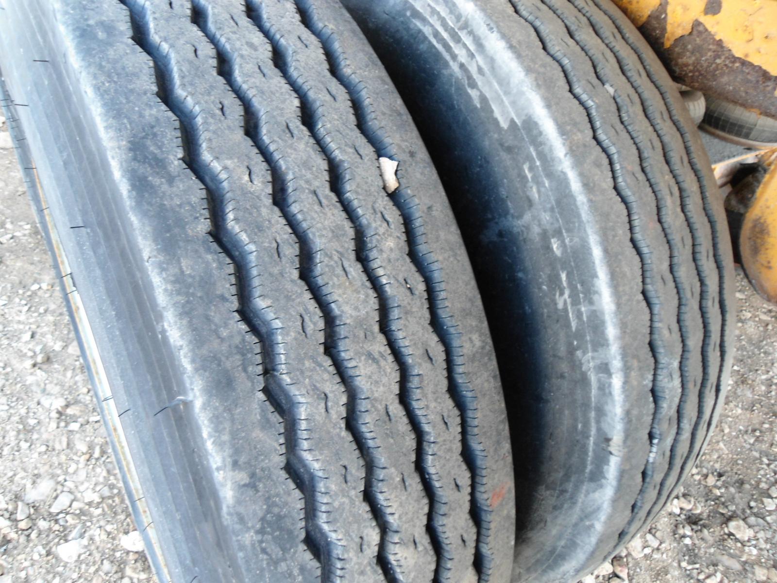

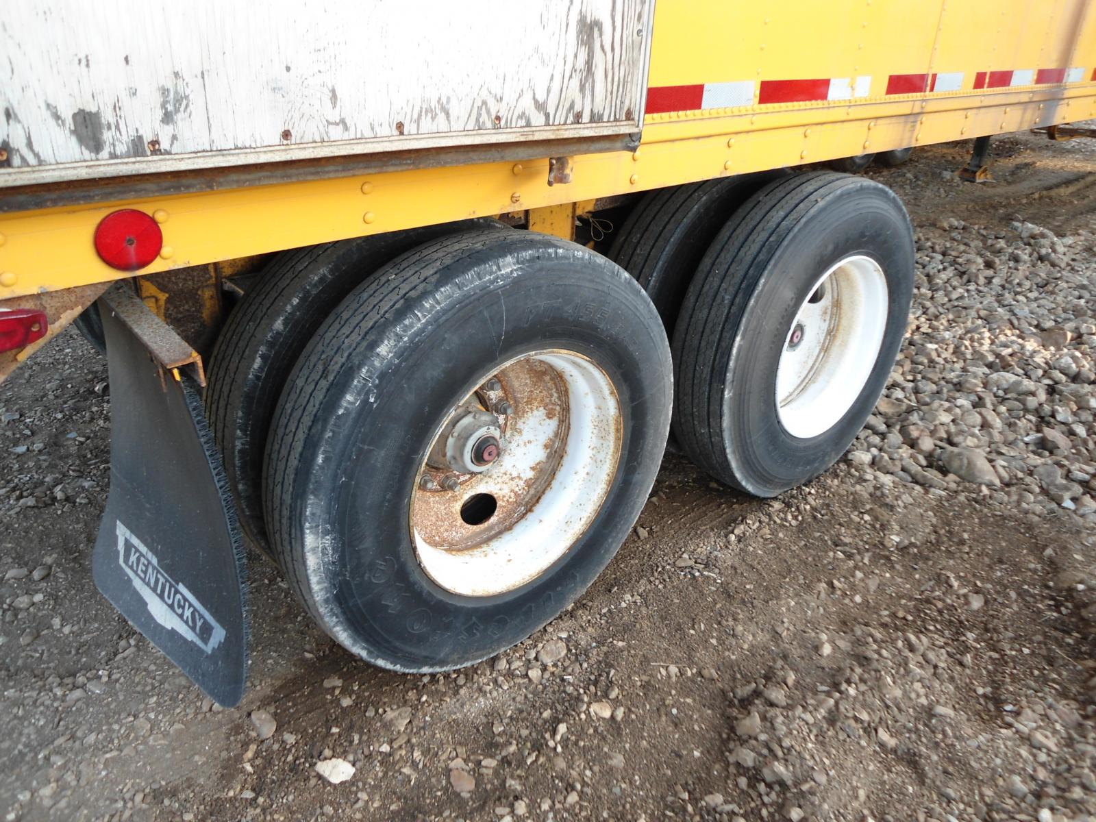

If you were needing budd wheels, I just bought a trailer from a utility company that has like new tires on it. I bought it for storage and I am going to sell all eight wheels and tires. They are nice tubeless 11R22.5 radials on budd wheels.
post-6658-0-32609200-1330563404_thumb.jp
post-6658-0-56960300-1330563492_thumb.jp
Sorry they are not spoke wheels!
