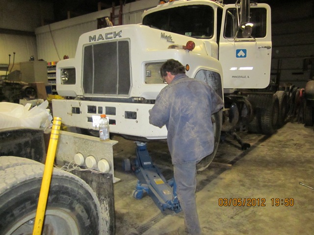

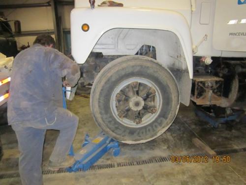

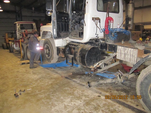

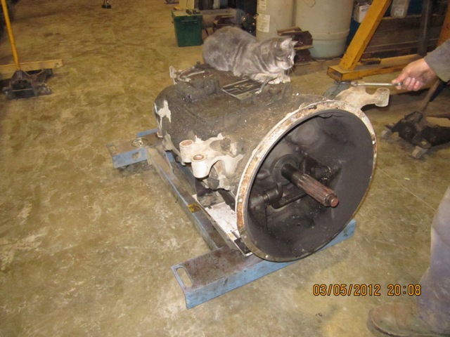

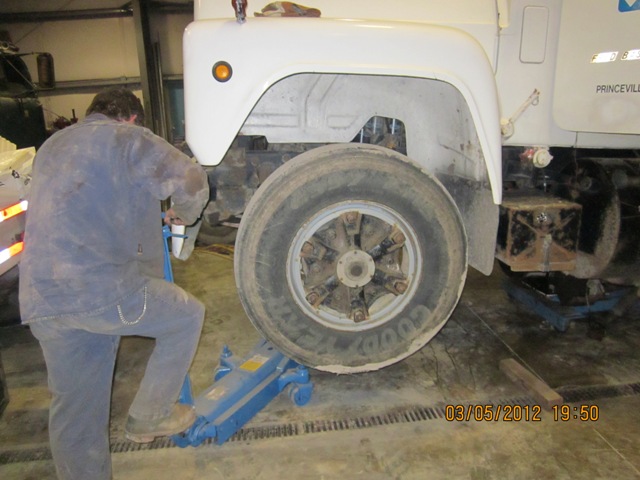

Almost, but not quite 2.25 hours from start of the job till on the floor with the old. Will swap parts over on Friday when back in town and slip replacement in.

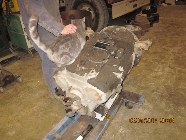

The old trans is a T2100, the new T2090. Need to swap the output yoke and a couple u-joints in the driveline. Should go easy. Certainly is nice having the right tools for the job.
Had one minor setback in the job. When I was removing the right side tank, the bottom stuck to the straps and put a couple gallons of fuel on the floor before I got the tank stood on end. It is rotted terrible. My floor drain is right there so no problem as it will hit the oil/water separator before discharge. Shop smells like diesel fuel pretty strong right not however.
Rob

Is the white one listed in your roster? Looking at the interior I would think it was newer than an '80.
Cats are cool, I don't know why some people hate them.
That is/was my truck and is a 1988 Model. The gent passed away that gave me the B67, and left me this truck in his will. His daughter is keeping the farming operation going and they have three aluminum end dump trailers so I let them have it back. Kinda of a nice little deal. I have use of the truck and a trailer at will, do all the work and maintenance, and they pay for repairs including this transmission swap. The T2100 ten speed was severely mismatched for the job so I came up with, (after help from this site) the decision to install a "ReMack" T2090 trans. This should make it more suitable for field and road work as the orginal trans just didn't have enough reduction in the low gears when heavy. The mainshaft is twisted in the ten speed but not bad and I'll replace it with a used one I have.
That's a great story. I'm sure he's looking down and smiling at the way things have turned out.
Fuller Roadranger 9 and 10 speeds are (or at least were) the same way. The 9 direct had a low of about 12.50 while the 10 direct had a low of around 8.50. If you wanted more reduction you had to go with the 15 speed which was a 10 speed with double reduction. (forgive me if you knew this already).

He's doing quite a job keeping that tranny balanced on the dolly.
Jim

That's a great story. I'm sure he's looking down and smiling at the way things have turned out. Fuller Roadranger 9 and 10 speeds are (or at least were) the same way. The 9 direct had a low of about 12.50 while the 10 direct had a low of around 8.50. If you wanted more reduction you had to go with the 15 speed which was a 10 speed with double reduction. (forgive me if you knew this already).
No problem. I'm not much of a mechanic, (parts swapper actually) and until David gratiously provided the gear ratios I had no idea which way to go. The T2100 trans is very hard to shift in the lower gears due to binding of of the slider clutches on the splines. It is almost impossible to upshift without using so much force to pull it out of gear you "sail" through the neutral gate and crash into the next set of gears. Lifting the top cover and viewing inside the trans one can see the deformation of the splines on the mainshaft. I paid $20.00 for a used mainshaft so I'll repair the trans and use it in another older two stick truck. This way I can stay "Purebred". Fred, (deceased former owner)'s daughter Elernor, and her fiance' are continuing to keep the operation going and they told me that when a trailer was full of grain, the truck would really "hop" in the fields getting started from a dead stop. I'm certain this is why the mainshaft has suffered.
I was scared shitless until he stabilized that tranny on the jack for me!!
Rob
