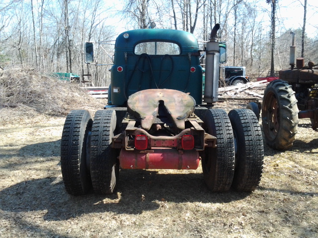

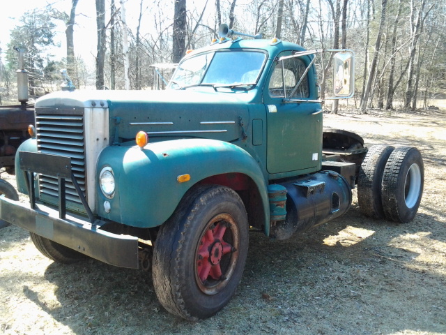

It's B75T followed by a 4 digits,here's a few more pics.The truck is very straight,and not a lot of rust.I was supposed to get it a few years ago,but some things came up.Lucky for me the owner saved it for me!Any idea what this truck's value may be?(not selling)Fully rebuilt 673 with low miles,20 speed Q-Box.Aluminum tanks,hoods,shell ect...I'm the third owner.

While Mack kept track of how many of each model was made they did not keep track of thing like number of axles and cab type. The only way to figure out how many single axle.B75's were made would be to go to the Mack museum and look at the built sheet or serial number for.each one. At least with axle number you could look at the serial number list and everyone with just a T suffix is a single axle(also lt). If you want to know how many B67's were built with a concave cab you have to look at every B67 build sheet.
Very neat truck. I would love to have it. Value is a.little tough, but I would guess in the 5000-8000 range if it runs well. Maybe a little more.if someone really wanted it.

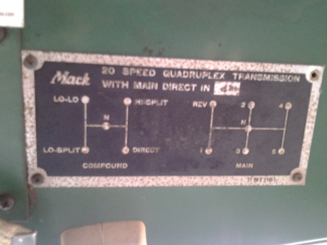

Didn't have a chance to climb under it to get any numbers,here's a pic of the gear shift tag.Any info/advice on this trans would be great.
Well there ya have it... Its a quadruplex. You'll be shifting the compound 4 times in every gear of the main...give or take. Probably not necessary empty. Theres a plethora of possibilities hahah. Theres enough gears in that or should I say torque multipliers too pull down the house! Good luck learning how to master that beast. Go and order this DVD that the old timers put together for us....It'll help.
http://www.longroadpro.com/2stick_frameset.htm
https://www.bigmacktrucks.com/topic/23848-sing-axle-b75s/#findComment-108171
I had an ACar with a 5x4 and had a B61 with a duplex,so shifting won't be a problem.As far as Lo-Lo,wouldn't that be mostly used for starting off with a heavy load?
yes, you just drive it like a triplex on the road.
