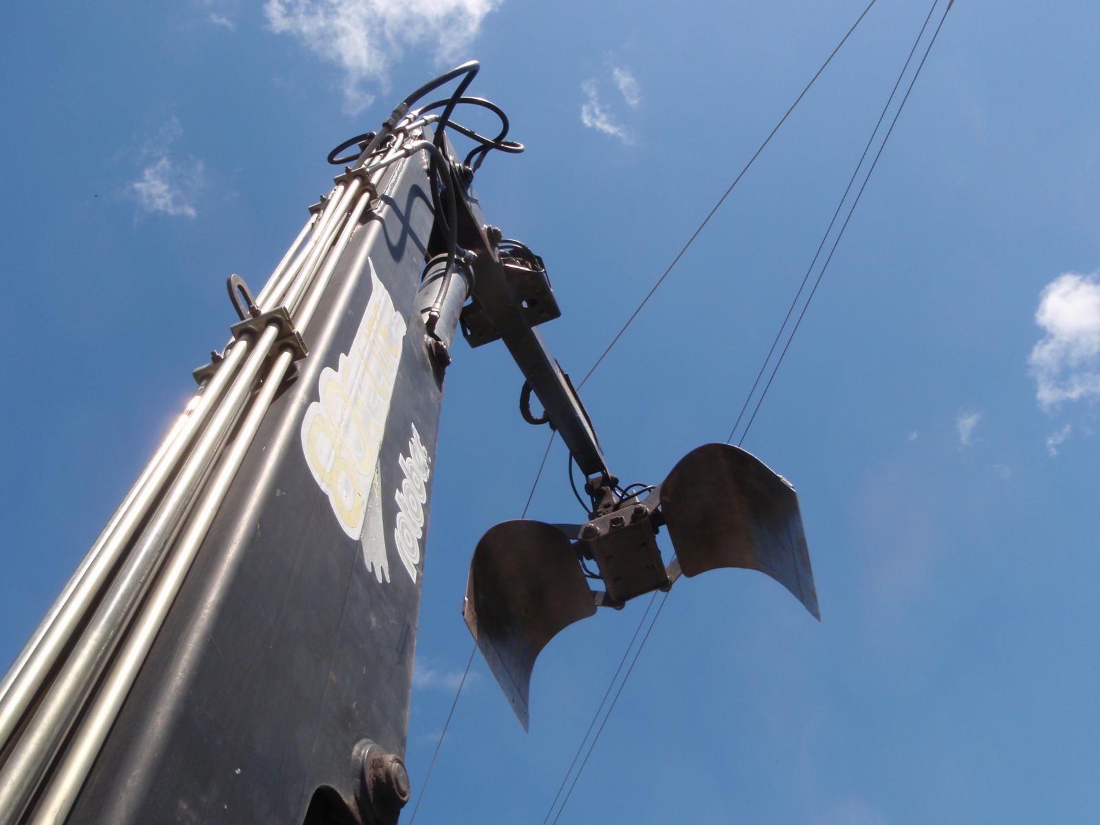

A local man was uninjured after driving his grapple truck with the boom in the air, and getting entangled in power lines Monday
post-4436-0-23073100-1332241877_thumb.jp
The driver remained in the cab until FPL crews arrived and disconnected power. The driver then had to manuever the boom to get disentangled since power crews could not get close enough.

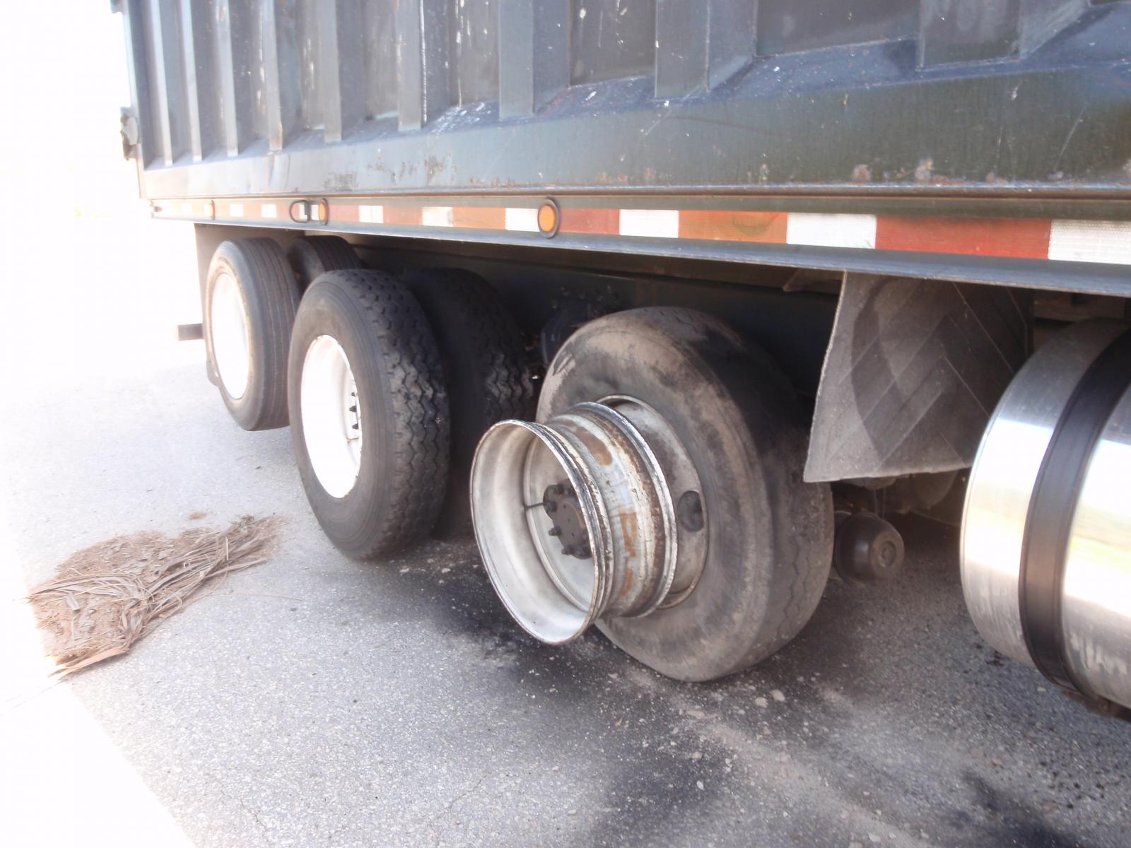

Only apparent damage was several blown tires, including one blown completely off the rim

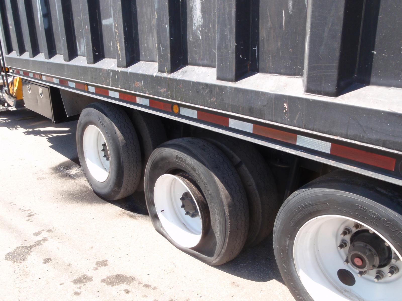

Further inspection showed all tires in contact at the time were damaged and have to be replaced.

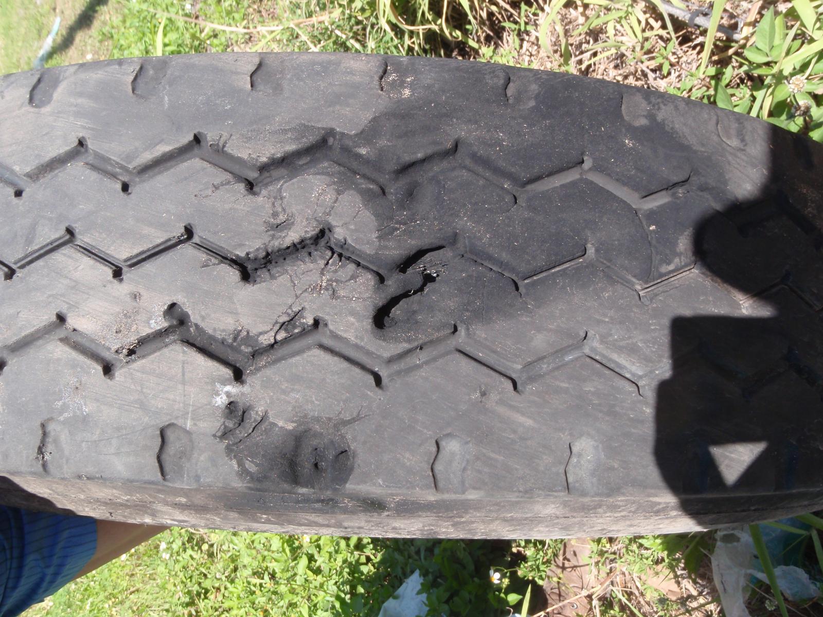

Another pic of one tire. Look at the worm holes

Damn! You are lucky to still be able to read and type! I bet you end up having to replace all the tires. I swung a boom into a set of 69KV lines years ago and burned holes in all the tires - some of which did not go flat for a week. We also found pin holes all the way through the six inch cribbing at the outriggers.
