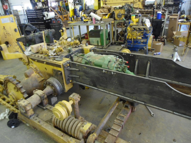

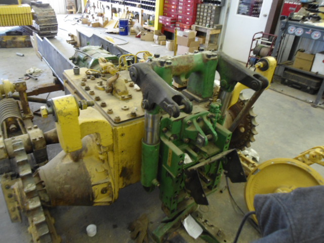

Here they are converting a D5 into a Cat/Deere farm tractor with a Deere engine, powershift, and three point, new undercarriage - they even fabbed up a new frame and added the oscillation set up on the back of the frame to follow the ground better - that took some work:
post-6658-0-58759400-1334233079_thumb.jp
post-6658-0-64697300-1334233097_thumb.jp

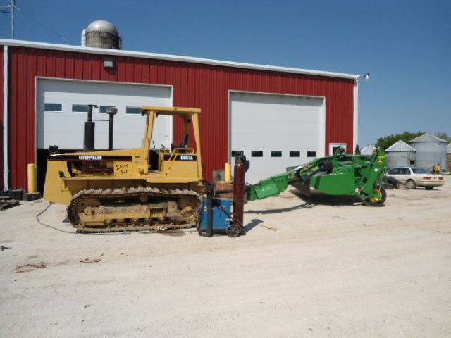

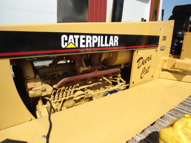

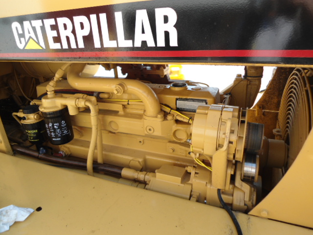

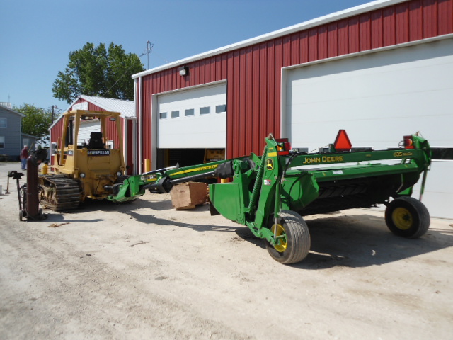

Here is a finished one with a Deere 6068 engine installed they use to pull a mower conditioner:
post-6658-0-39951700-1334233255_thumb.jp
post-6658-0-83258800-1334233175_thumb.jp

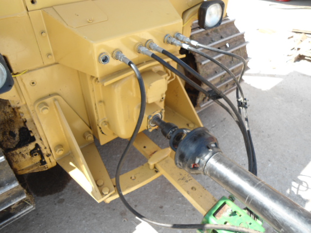

They get the PTO assembly out of White farm tractors:
post-6658-0-96340100-1334233147_thumb.jp
post-6658-0-75898900-1334233122_thumb.jp
post-6658-0-97802500-1334233136_thumb.jp

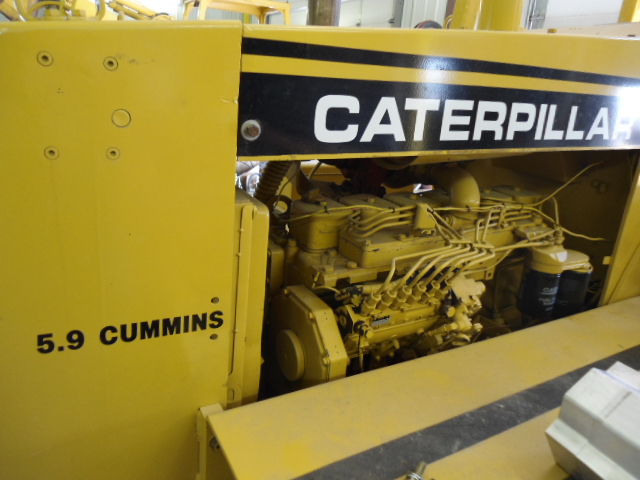

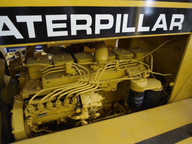

They had one with a 5.9 cummins and they said it bolted right up to the Cat transmission and was very simple to convert. They tried a 8.3 cummins and it would not fit:
post-6658-0-18131300-1334233038_thumb.jp
They get twice the hours out of a 5.9 than the original Caterpillar/Mitsubishi one.
post-6658-0-12256400-1334233050_thumb.jp

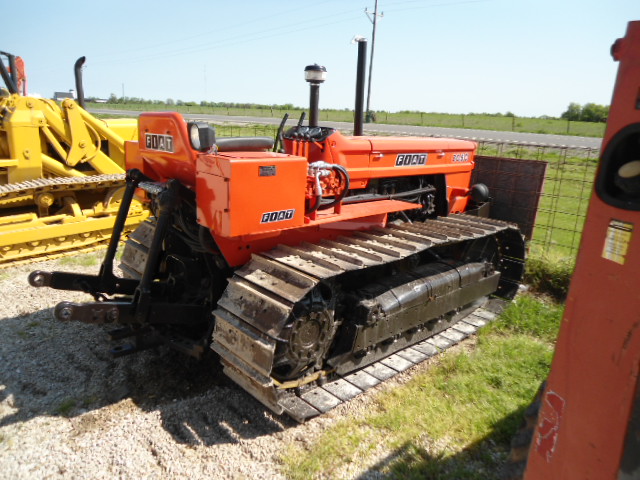

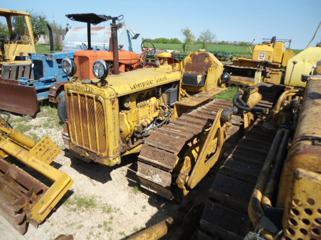

They also had some neat older crawlers they had worked over in the shop:
A D2:
post-6658-0-34033200-1334232958_thumb.jp

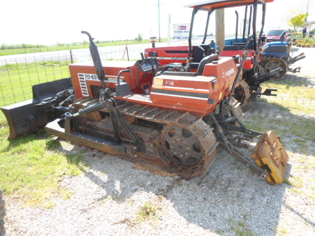

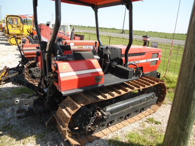

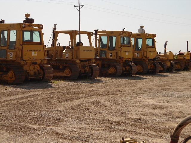

Row of factory ag crawlers - a long way from western hilly wheat fields!
post-6658-0-26536800-1334233001_thumb.jp

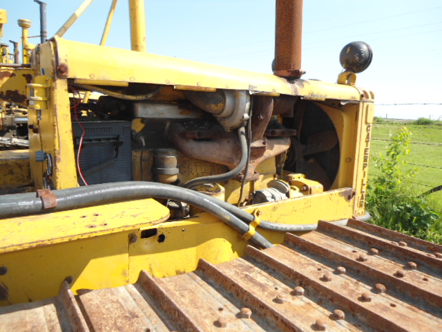

A lot of them had added turbo's:
post-6658-0-97935700-1334233013_thumb.jp

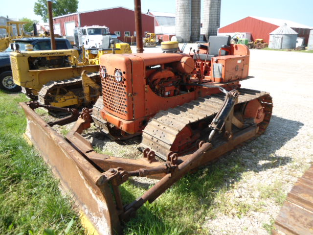

Nice original Allis Chalmers:
post-6658-0-18642400-1334233025_thumb.jp

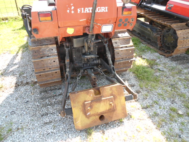

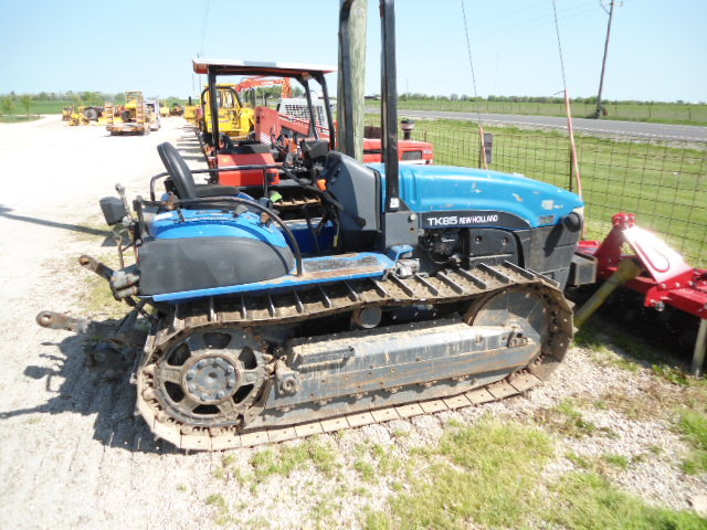

They also had some late model ones - mostly sold new for orchards I bet:
post-6658-0-29860200-1334233189_thumb.jp
post-6658-0-62663900-1334233202_thumb.jp
This one needed a little more weight in the back:
post-6658-0-10750700-1334233215_thumb.jp
post-6658-0-25214300-1334233227_thumb.jp
post-6658-0-19649600-1334233241_thumb.jp

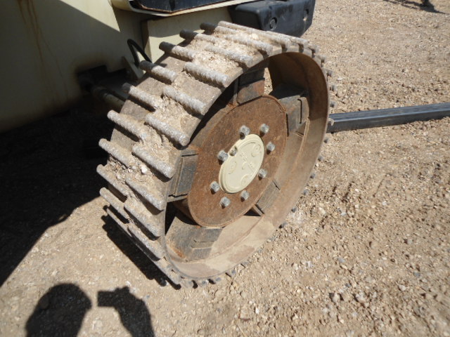

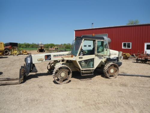

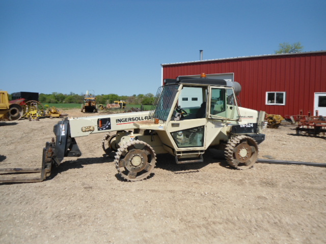

Here is their shop forklift - on steel!
post-6658-0-64639200-1334233284_thumb.jp
Check out the rubber blocks inside of the steel wheel.
post-6658-0-21566800-1334233296_thumb.jp

Pretty sweet, like I said JD does tractors best.
"They get twice the hours out of a 5.9 than the original Caterpillar/Mitsubishi one"
Theres a possiblity as to why someone will spend money on this type of conversion. Not to mention parts for a 5.9 are probably more easily to come across in a pinch... just my two cents.
These guys are really sharp - they are not just doing it for fun! They use these like a farm tractor and they have discovered what works after thousands of hours of use. I bet most of what they convert are ones that they have bought as salvage/burned/wrecked or something and it is a cheap way to make a like new ag crawler by combining the best of a Cat crawler and a John Deere tractor.
