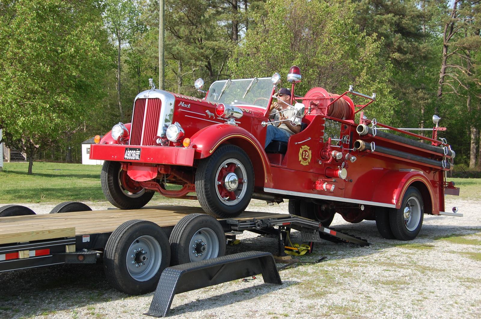

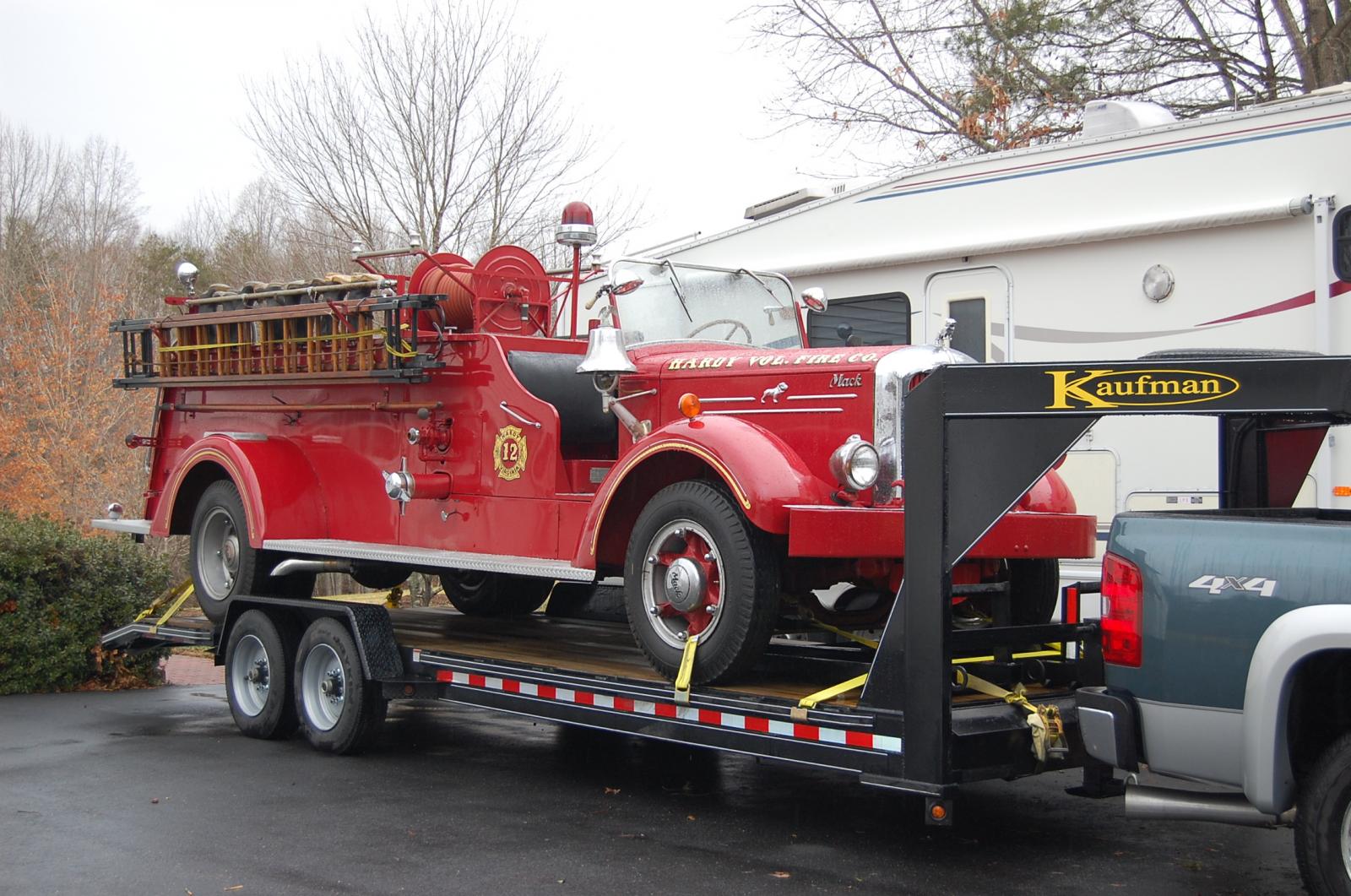

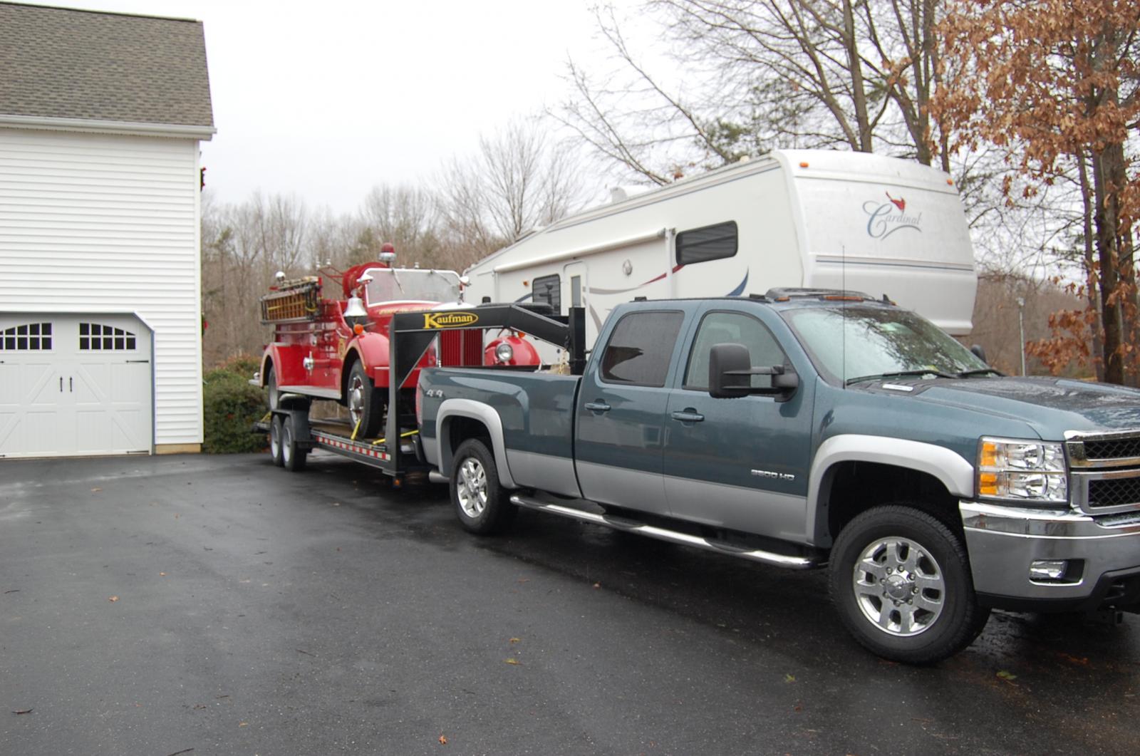

What everyone else said plus make sure you use a "four point" tie down to meet DOT standards. One problem I have with my trailer is the weight of the truck sometimes keeps the ramps from lowering all the way down. I now carry a couple of sloped boards that I back the trailer onto in order to raise the rear end enough to get the ramps to drop all the way down.
I also installed jacks on the rear to keep the ramps from kicking up as I load and unload.
post-2016-0-15874000-1335789354_thumb.jp
post-2016-0-75780600-1335789396_thumb.jp
post-2016-0-35968500-1335789430_thumb.jp
fxfym, what does that fire truck wiegh? I would think that you are pushing them trailer tires pretty bad. My single axle L model is 14,800lbs and maxs out my dual tandem.
Those look like 17.5" lowboy tires. They are usually about 14 ply rating.
Rob

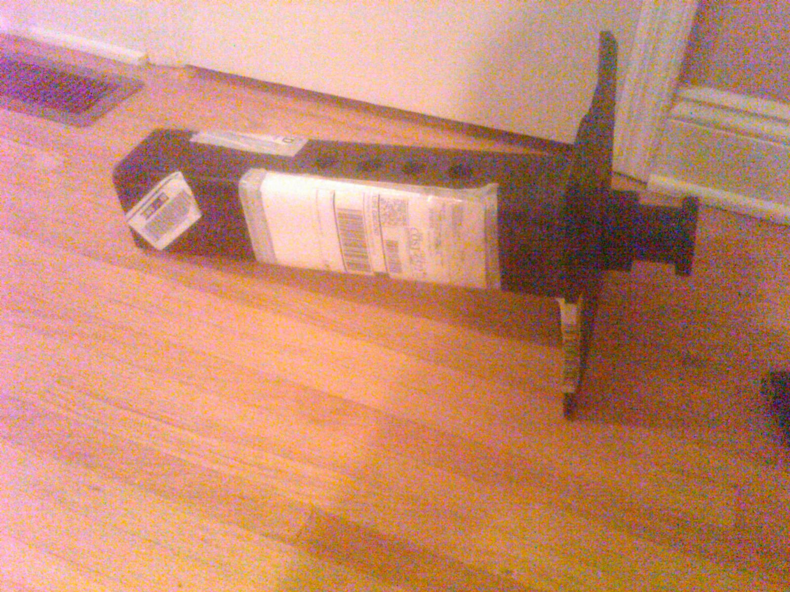

Trust me! I love it! I already out fit it with a bunch of LEDS!!! Ill grab a pic tomorrow when i install my king pin hitch.
Tom
"Nothing Breaks Wind Like A Bulldog"
i guess theres a box shortage....
Tom
In Missouri, if you run with a kingpin in any trailer, you can license it with permanent plates, which is a big savings in time, trouble, and expense - you can only get plates you have to renew on one with a gooseneck ball.
