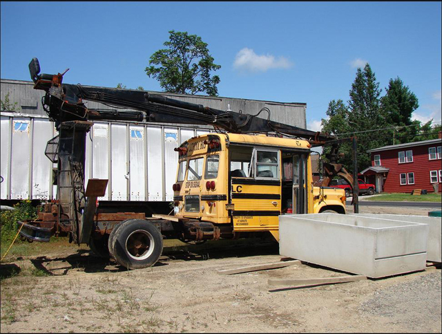

Thanks for the advice. Let you know how I make out tomorrow. Sold my RB today and already miss it so see what happens. Logtruckman this rd is set up just like your cl Same style log body with serco on the rear. It is red so most people wouldn't even know i changed trucks.
https://www.bigmacktrucks.com/topic/24887-looking-for-advice/#findComment-117361
What model boom is it? A friend of mine bought a 7500 Serco and loves it.

Serco-meh
https://www.bigmacktrucks.com/topic/24887-looking-for-advice/#findComment-117367
When I was looking for this type unit, several people told me-Rotobec or Prentice, then serco, hood was not on the list.
truck was already set up when I bought. Options available were-trailer hitch,pintle, add'l lites, chrome bumper

Thats is a sweet mackabuslogtruck but if i got up this early to go look at something that looks like that it will be along ride home for my father who will be my passenger. Sad thing is this website is addictive enough that I got up even earlier then i needed to just see what Hatcity had to say. Have a good day see you tonight!
