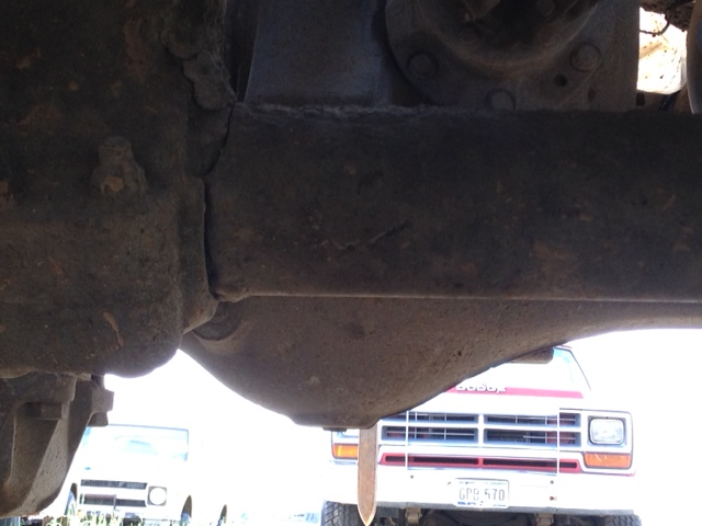

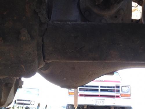

I am the process of purchasing a 1999 RD688S with a camelback suspension. Upon looking at the suspension
I noticed the round bar that runs from one side of the truck to the other and connects the suspension is significantly cracked.
Any thoughts on the extent of the damage and more importantly the cost of repairs?

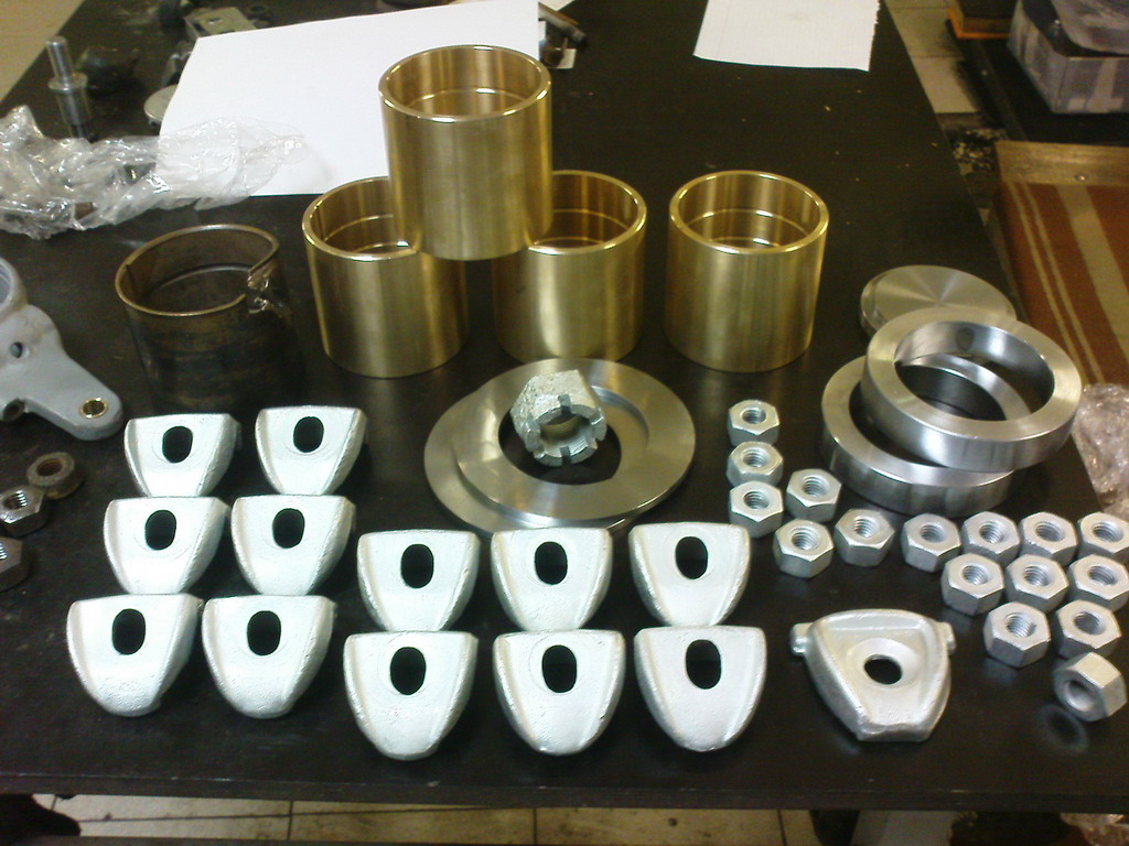

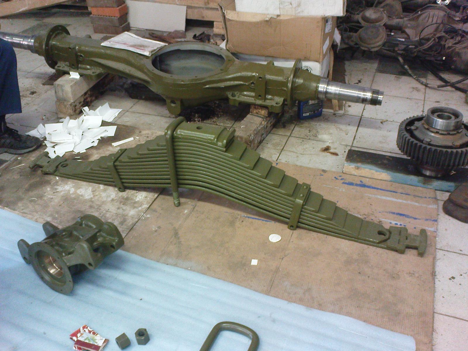

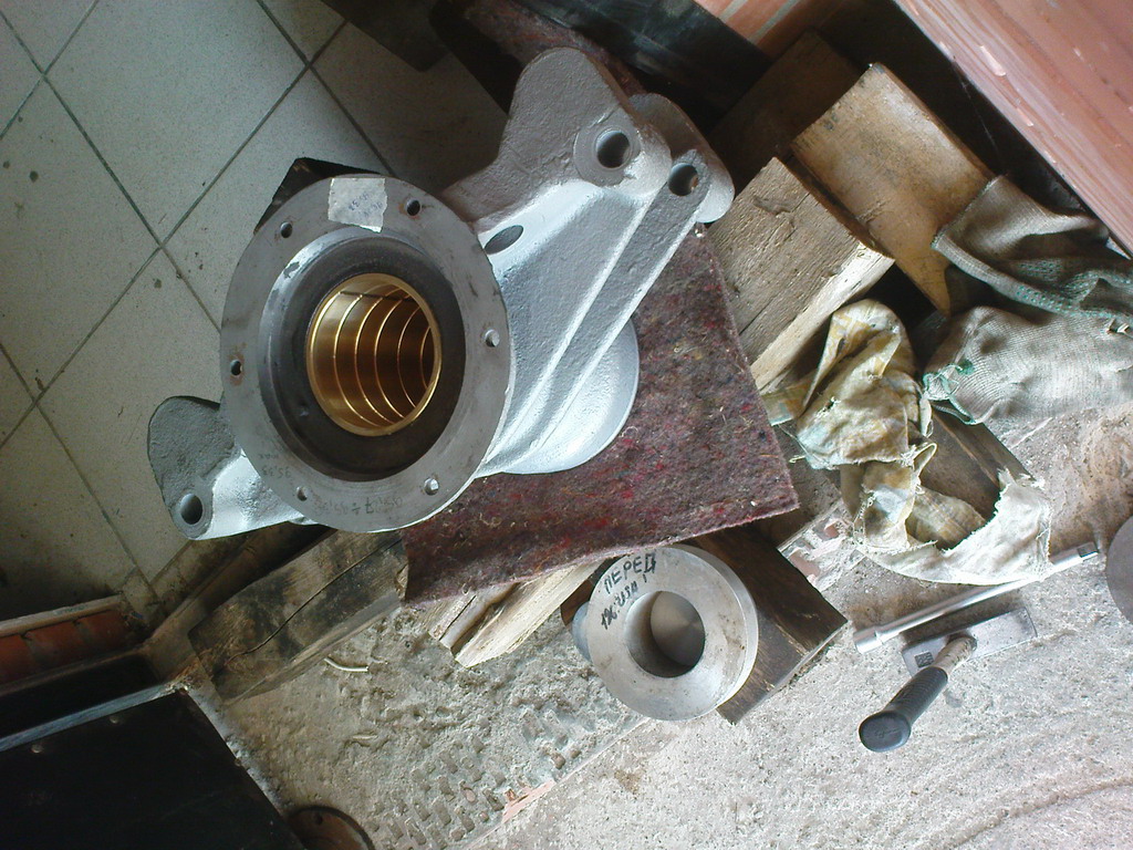

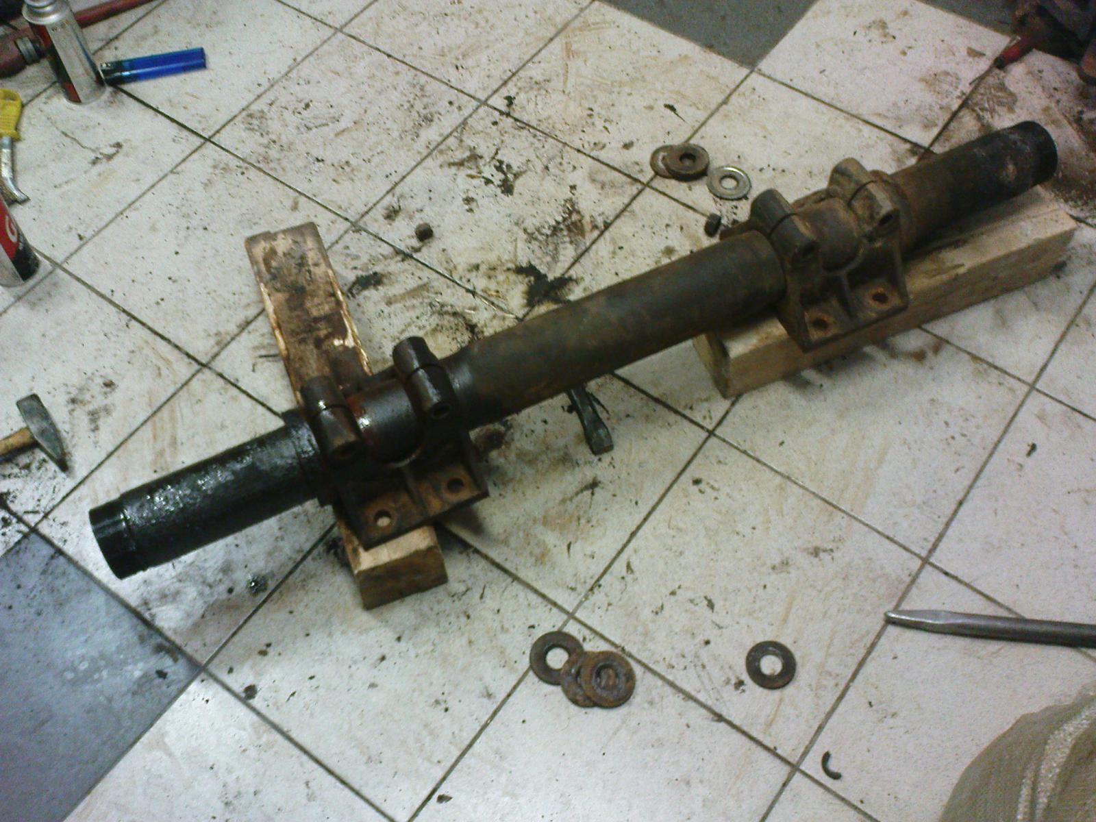

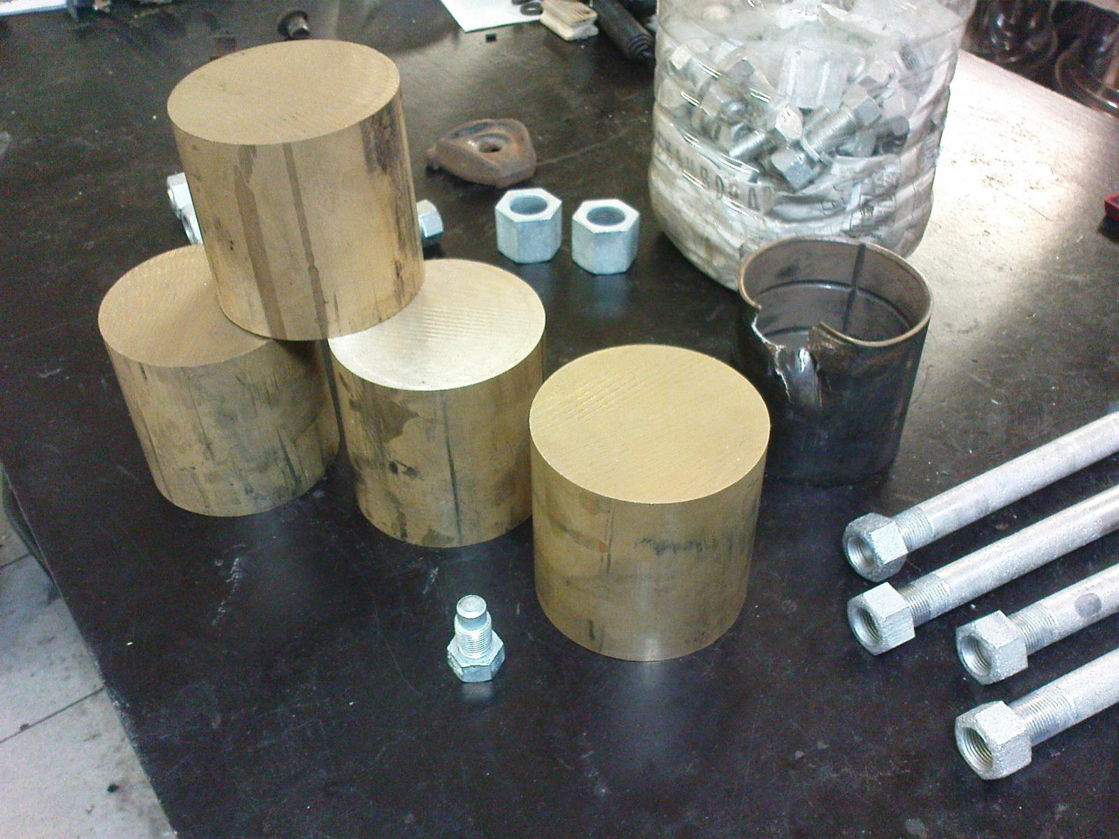

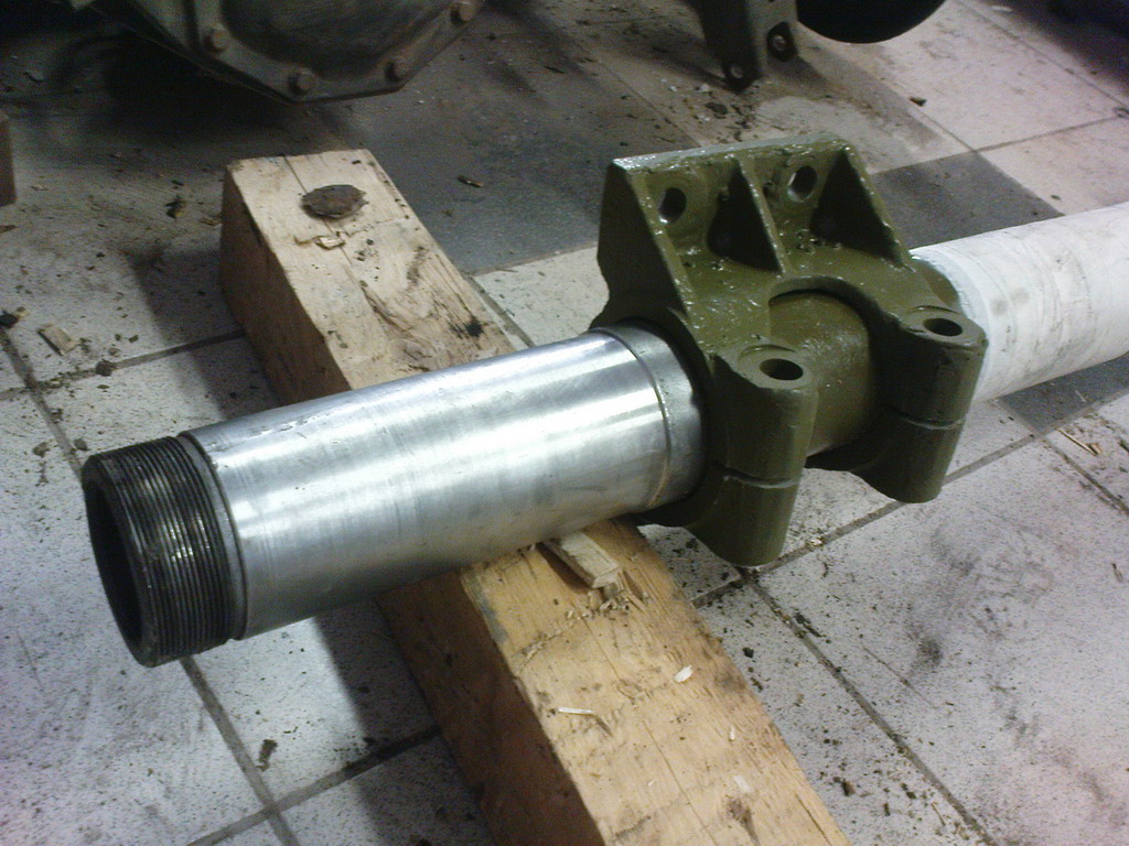

I have my Camelback of 1945 repaired last year.
The milage is unknown.
6 of 8 insulators were solid, bronze bushings were weared because of seals death and water income that made the trunnion rust.
Have the trunnion shaft machined off to a less size and made new bushings.
Problem was to find bronze because no bronze pipes were for sale, a solid piece only.
Vlad.
post-3971-0-24409400-1341604157_thumb.jp
post-3971-0-73905200-1341604240_thumb.jp
post-3971-0-89398800-1341604460_thumb.jp
post-3971-0-48088200-1341604509_thumb.jp
post-3971-0-44167800-1341604594_thumb.jp
post-3971-0-96877100-1341605142_thumb.jp
Vlad.
That is a fine example of machine work - make what you need out of what you have available.
