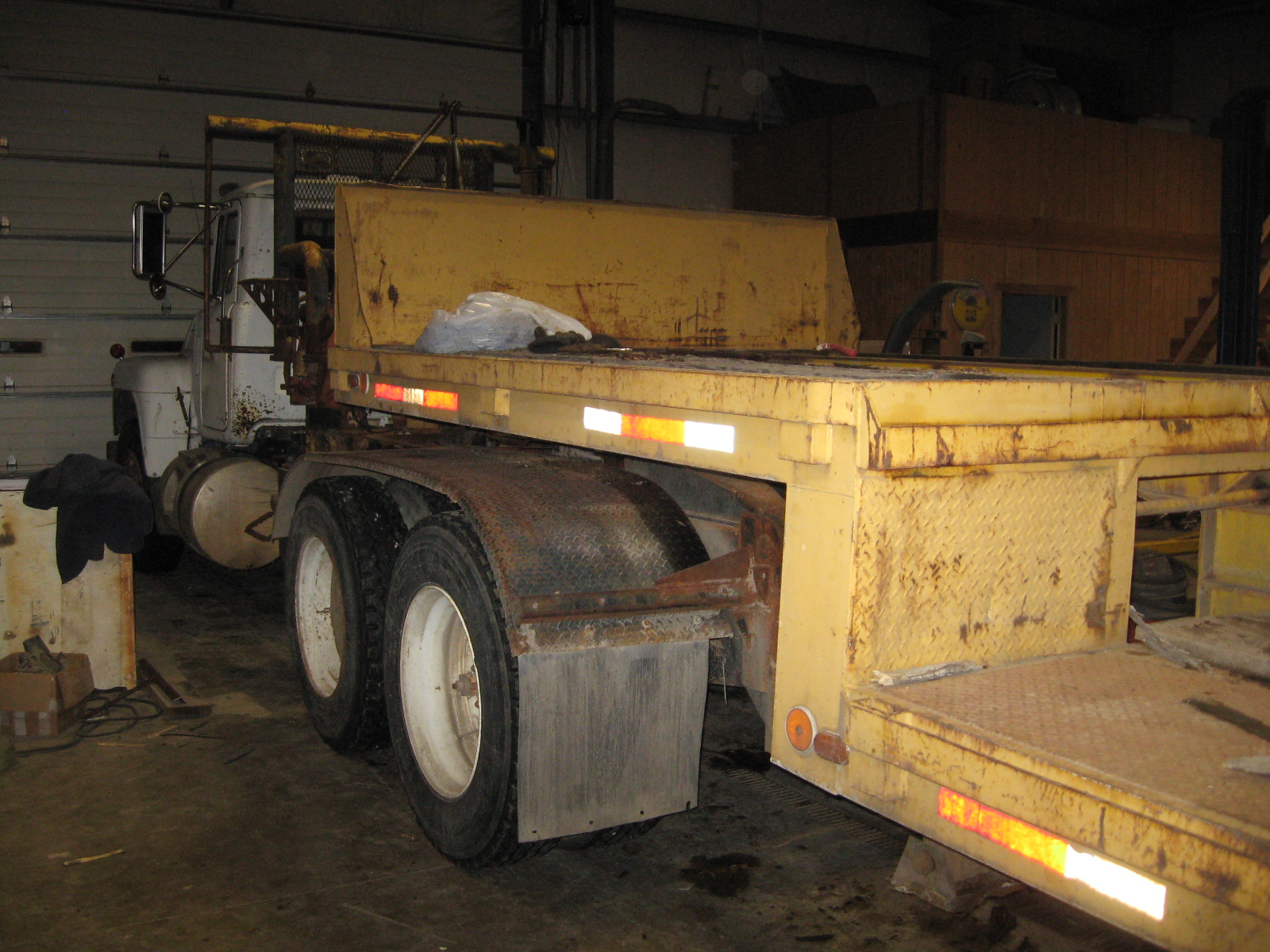

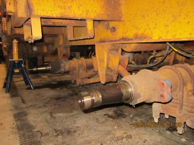

Today at the shop I wanted to get the brakes off of my drop deck which was already staged in the shop. I thought this may be easy but once into the job it was discovered to be a wee bit difficult. I thought several times about calling Glenn for advice or put him on a plane to help me out. There was not a single thing on that came apart without the perverbial "heat and beat" treatment. It started when I removed the outer wheel bearing. I had to make a puller using bolts into the hubcab circle, bearing against the spindle to pull the drum as I couldn't pull it by hand. All eight anchor pins, and eight rollers, were stuck but fast. I destroyed one shoe core as the pin just would not come loose from it. The actual shoe thickness were about 50% but some had fractured linings. The drums are virgin and will be turned for runout. One hub will require new bearings as I noticed "fretting" to the tapered rollers. I don't think the brakes have actually worked on this trailer for at least 10, and possibly 15 years. There are actually no marks on the rollers, nor "S" cams where pressure to spread the shoes would be evident. I was able to get the slacks and clevises off with the help of my "Tiger Tool" pullers for this purpose. The cam bushings are nylon but absolutely dry as far as grease and stuck. Using a 2lb sledge and soaking the bushing area with "Blaster", I knocked the cams back and forth about 1/2" until they basically slid free of the bushings.

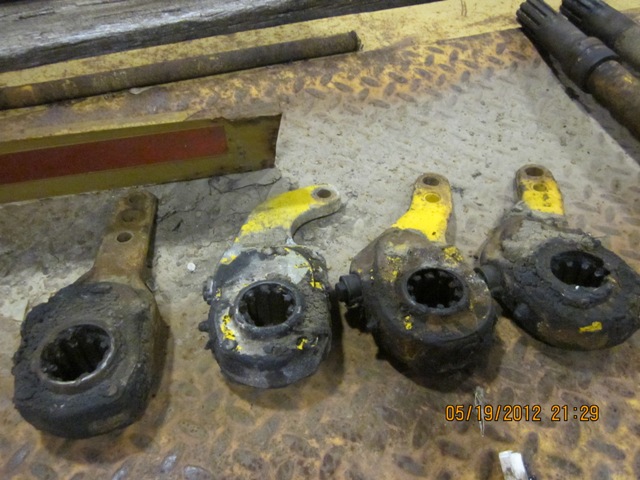

Remember me asking about internally stripped slack adjusters? Well, three of them suffer this phenomena. By hand, you can hold the body, and rotate the splines almost 1/4 around. Three of them were different types. Only two were a match to each other. The trailer obviously has been neglected.
I wanted to drop all the parts off at the vendor for the sublet work and parts today but was running so late I called to let them know I'd be a "no show". It is rescheduled for Monday morning. I'm going to install spring brakes on an axle also as the trailer now has none. With my R612, the trailer likes to push back if the wheels are not chocked, but the brakes were not working.This truck sets quite high with the fifth wheels and 11RX24.5 tires. I feel safer for both myself, equipment, and anybody else if the trailer has spring brakes also.
Tomorrow's project will be to cut the rub rail off both side as it is bent up badly, and remove the rusted pipe spool spacers. The deck treadways are 3/16ths treadplate which is also bent up, with some small holes rusted through. I will eventually replace the deck.
The final project for the trailer yet this next month will be to drop the front six feet of the neck on the ground and rebuild with new steel. I'll use the old neck for the pattern. It is rusted very badly and to the point I consider the trailer unsafe to be used as the webs of the neck beams are literally gone from rust and the fifth wheel plate is knife edge sharp.

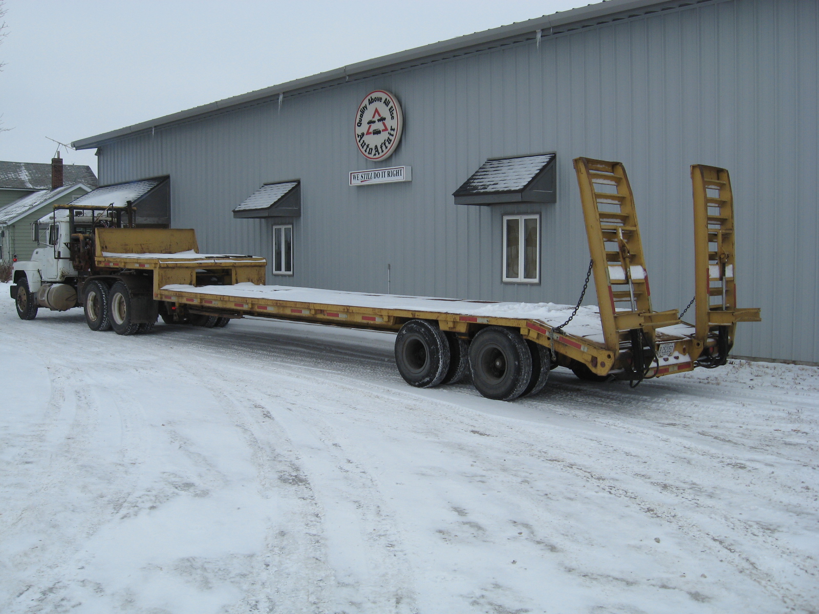

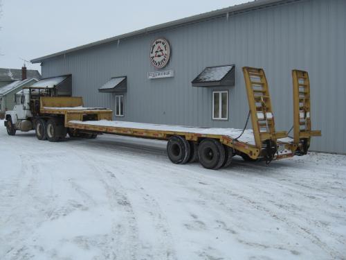

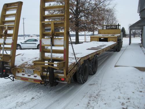

  On 5/20/2012 at 1:09 AM, leversole said:
DId you ever show us a picture of your trailer?

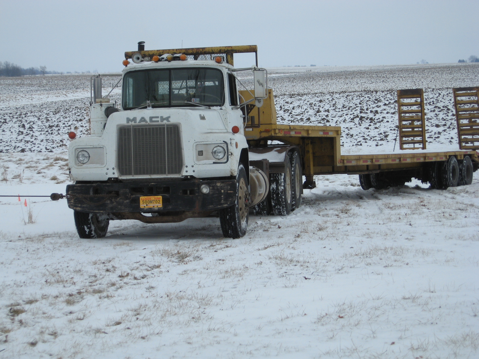

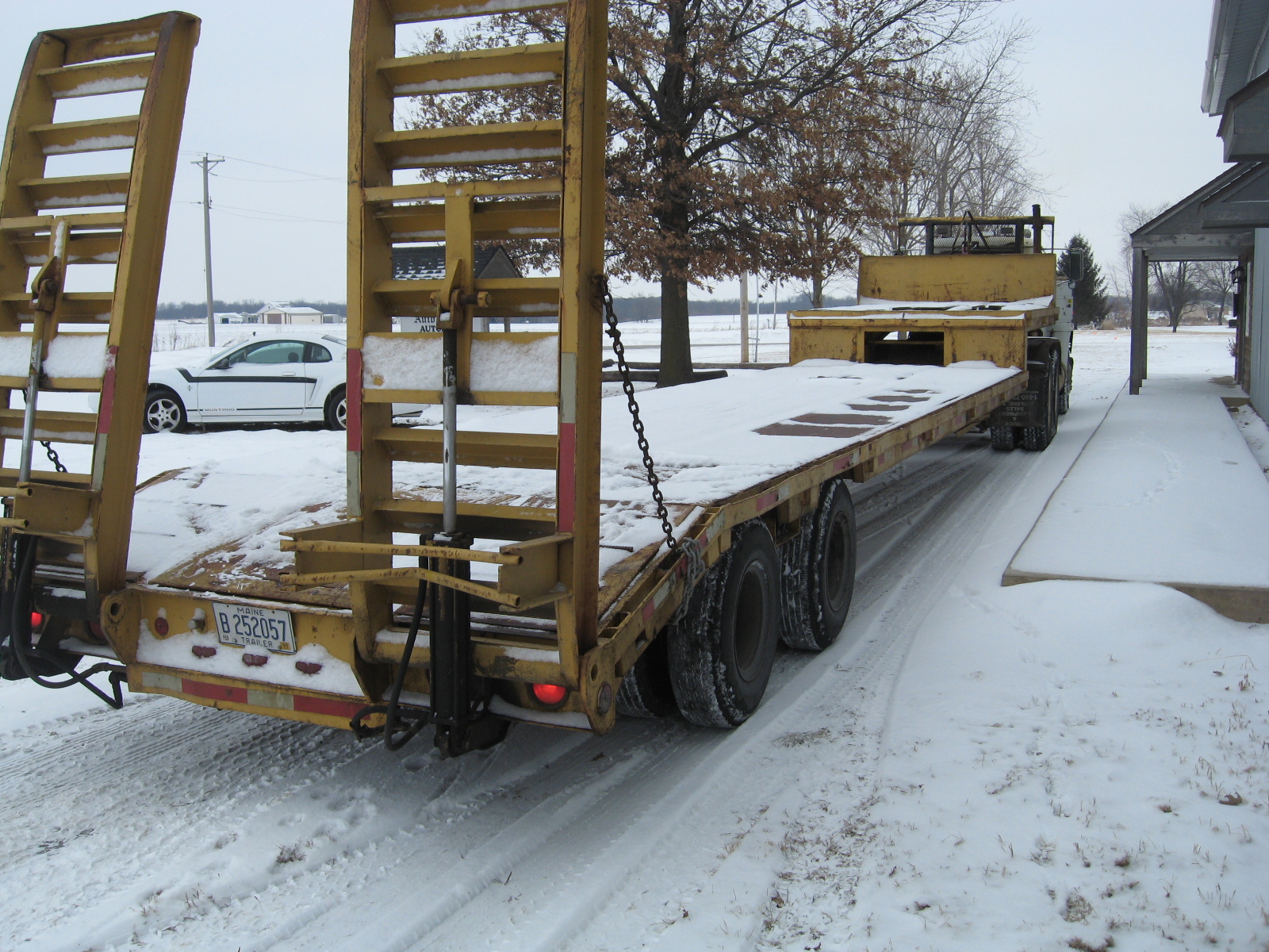

When I first got it in Feb, of 2011 I had posted photos of it. It is a single drop 42' with hydraulic ramps on the rear of the dovetail. I'll see if I can find the photos to refer back to. I didn't snap any today as I was filty both inside and out, (according to "Momma"). Rob

I know. This one really was a rag. The seller, (Joseph Equipment in New Hampshire) refunded a $1000.00 on the purchase price as he didn't see the rust was so bad in the neck. I do think them an honest seller. He offered to reverse the sale but wouldn't reimburse for freight so I kept it. In hindsight, I'm still glad I kept it as I looked a long time for something similar and they were over $10K additional. I can rebuild easily and be less than $10K in this one.

Yes, couldn't remember the name. Like I said, he was fair with me I felt. When I sent the photos of what I was talking about he readily admitted he really didn't look at the neck as the truck pulling it had full fenders and it was hard to see. Now I'm not one that expects something for nothing and he was willing to work with it. I could have taken it back to him, accepted a refund, shook hands and been friends. Things go wrong at times but it's how you right those wrongs is what counts. The trouble was I'd been looking for a trailer under $10K for about four years and couldn't find anything I could justify expense for. This one although older, had the low profile tires that are near new, pierced frame, and is very heavy built with hydraulic ramps. I usually go through brake and mechanical systems when I purchase something so the cost there is basically negated. The shoes looked good from the side, bit the hardware supporting them did not work and he never pulled the trailer.
I probably would not purchase another trailer sight unseen like I did this one, but it is coming along nicely, and I'm not upside down in it. When I get done in the next couple of months it should be nice.

  On 5/20/2012 at 2:01 AM, leversole said:
thanks, i 'member now...those hyd ramps look to be real labor savers!
I wanted a trailer heavy enough to load a truck onto while not connected to a tractor. The hydraulics are self contained.

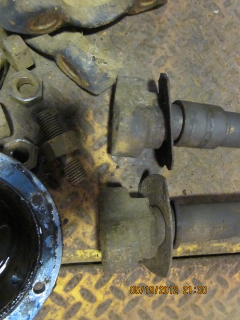

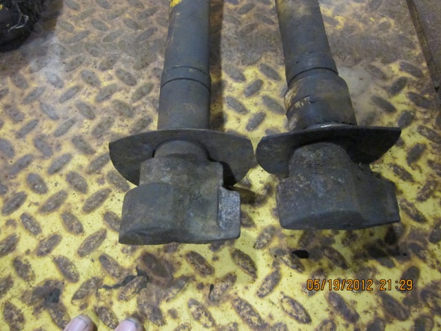

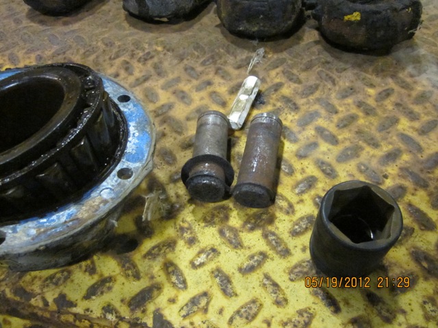

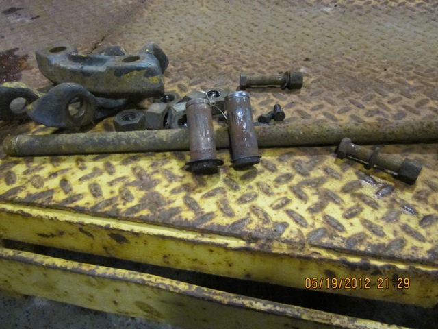

Little of what got done today:
1: Brakes and hardware removedpost-78-0-83726100-1337486544_thumb.jpg
2: Nicely rusted anchor pinspost-78-0-17146200-1337486549_thumb.jpg

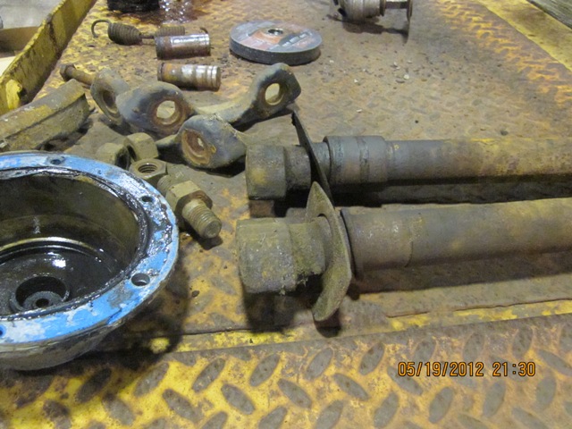

3: Three different types of slack adjusterspost-78-0-16948600-1337486553_thumb.jpg
4: More nicely rusted anchor pinspost-78-0-55092200-1337486557_thumb.jpg

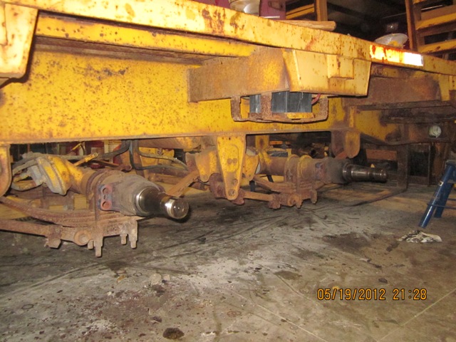

5: Hard working "S: cams, (not)post-78-0-62588600-1337486561_thumb.jpg
6: Other side "S" camspost-78-0-81834500-1337486565_thumb.jpg
7: Another shot of the "S" camspost-78-0-43540900-1337486570_thumb.jpg
8: Anchor pin bore rustpost-78-0-19634500-1337486574_thumb.jpg

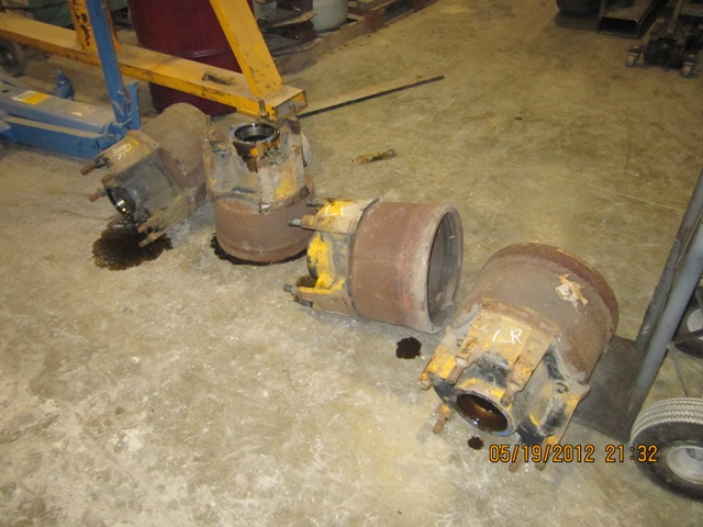

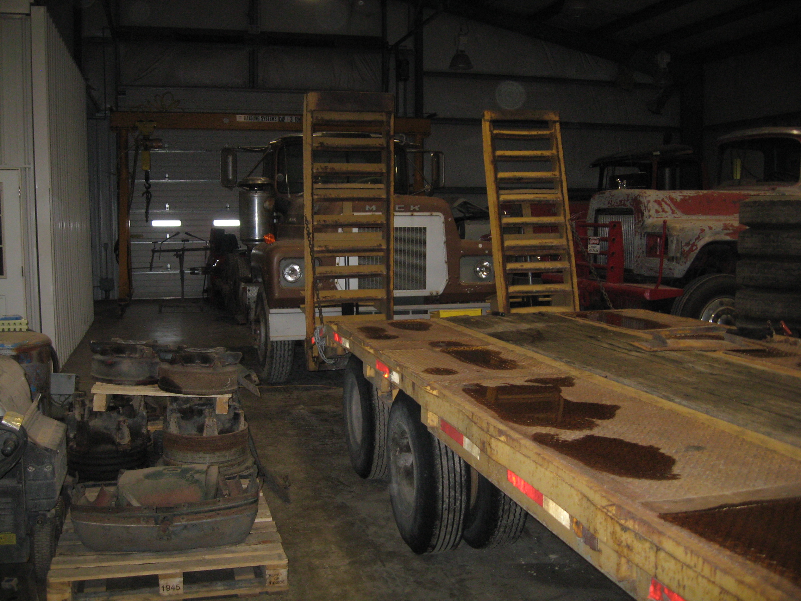

9: Pile of brake drums. All studs and nuts will be new alsopost-78-0-39002200-1337486578_thumb.jpg
I got all the shoes in a box but forgot to snap a picture of them They tucked nice and neat so may not take them out until Monday when I drop them off.
When it is back together and the welding is finished it goes to the blaster. It will either be picked up with the bridge crane and tipped on the side, or completely over and upside down to be blasted clean. This guy has done several cars, trucks, and parts for me though the years and knows what I want done and how it's supposed to look. I'll then paint it with the airless paint sprayer.

I talked to the sandblaster this morning and he is going to get it in as soon as it's back together and rolling. We'll tape and cardboard the brake drums openings shut to keep sand out, roll the trailer onto it back, the strip it bare. It will then come back to my place for the neck replacement.
Forgot to mention earlier I'm also planning to replace the very good condition 8.25RX15 tires with 235RX17.5 tubless tires and rims. Think I have an outlet for the old tires and rims to a couple implement dealers running trailers with this obsolete tire size. These are close to new and should offset the new tires cost a bit.
I'm going to be ambitious with this project as 42' of trailer off center in the shop still takes up a lot of room!
