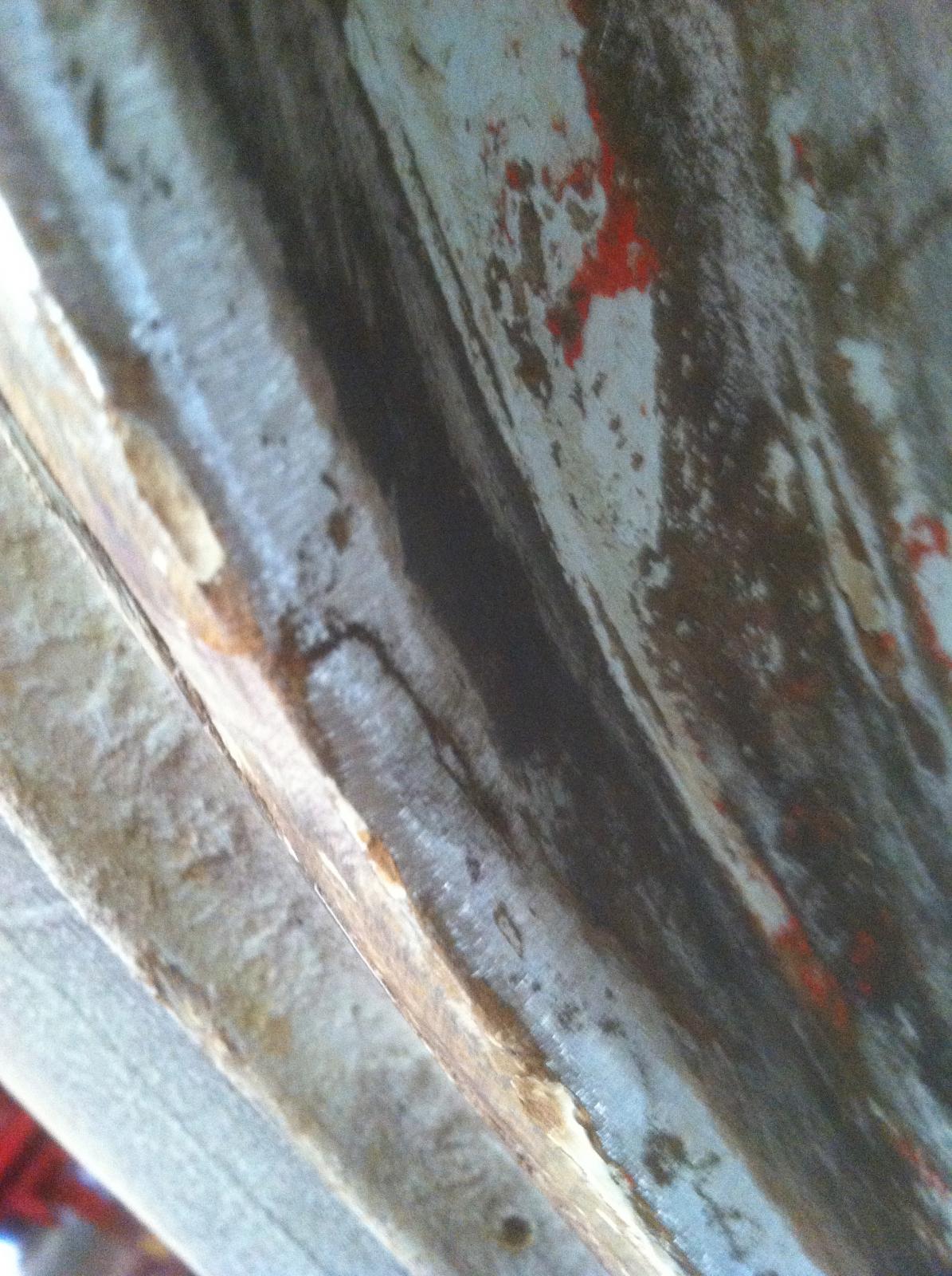

Well I was having my rims (rear axle) painted today and we discover a crack in one of them. So the question then is how do you tell an 8.00 rim from a 8.50. The tires (tube type radials) are mounted. So I hooked a tape measure on the outside face of the wheel to the opposite side-split ring side and come up with the following dimensions: Two rims are 9-3/8ths, one is 9-7/8ths, and 0ne is 8-3/4ers. As for spacers, one is 4" and one is 3-5/8ths. I guess its possible over 56 years that this truck has long since lost its factory rims.
anyone have any suggestion? I'm assuming they are 8.5's I believe the two at 9/3/8ths were matched up with the 3-5/8ths spacer and the other two were matched with the 4" spacer. That would have meant an even overall match.
The fronts by the way look relatively new-when I bought the truck in 09, the front tires (11:00 x 24R Bridgestone 857's) still had blue paint markings in the tread pattern. My guess is the rims were replaced with the tires.
Picture of cracked rim attached-again this is on the lock ring side of rim
