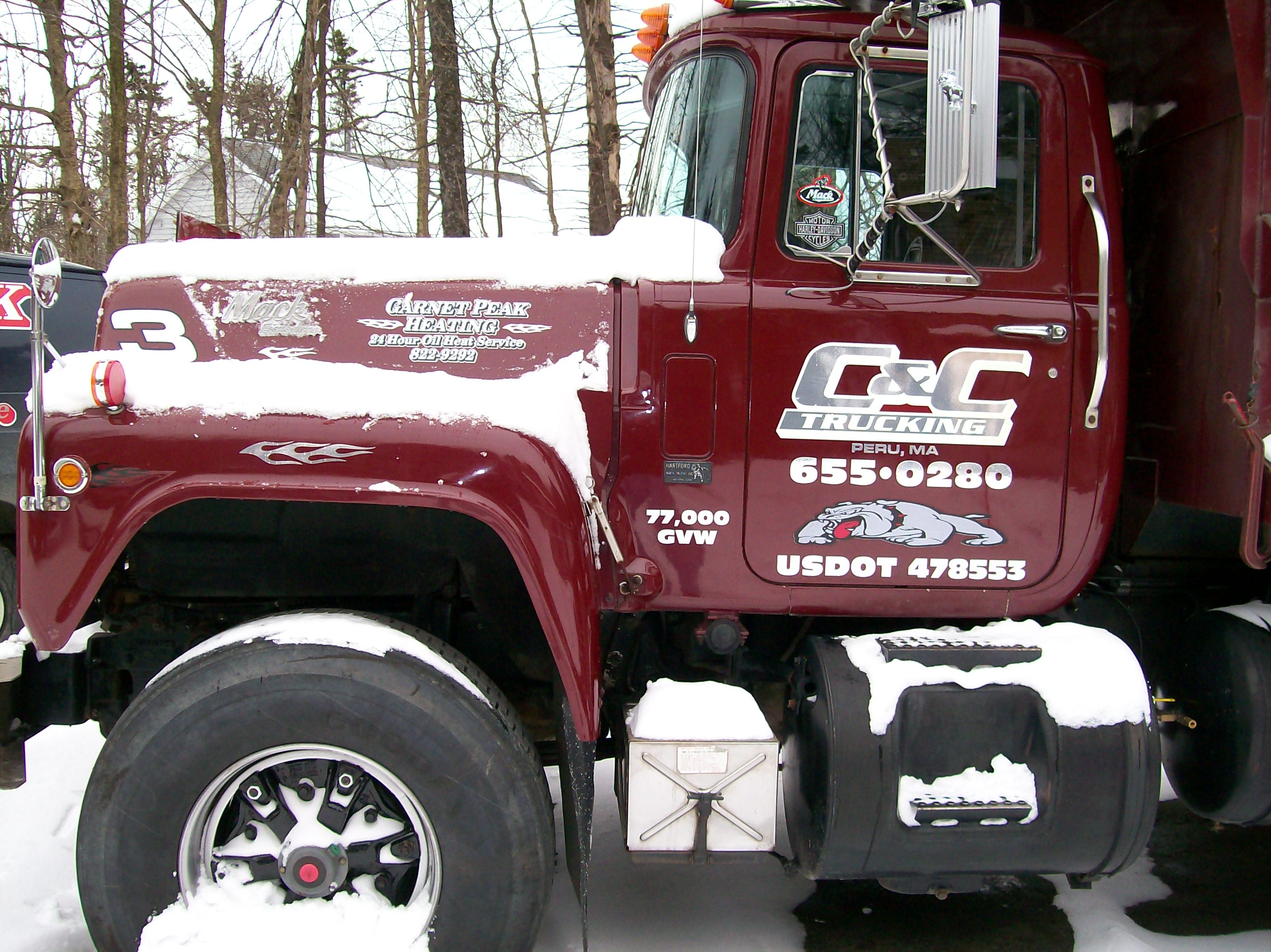

OK Dragon Im prolly gonna get torched for this post but here is what I did.... My 88 E6 350 RD tri-axle went fom being the best running but most under powered 350 Ive ever owned or drivin to running like a scalded dog and still have the EGT's in check.... Pull the return line off your Ambac and then the brass fitting off the pump, there will be a small spring that sits in a small cup, find 3 small washers that will fit in that cup drop the spring back in and slam it back together.... My pressure went from 17lbs at idle to 28lbs.... I popped the top cover off my Ambac and slid the rack stop all the way forward, loosened the 3/16 screw on the ramp slot and slid the ramp all the way down to now get FULL rack travel.... Also changed the air cleaner in the process.... I went from a max of 16lbs boost to 24lbs and that is with some damaged fins in the compressor side od the turbo ! Yesterday I also adjusted the valves which were WAY out of spec and pressurized the system for boost leak test, hoping I gain even more as I have not driven it yet since yesterdays work.... Holy shit this truck came to life way more than I expected freakin actually fun to drive again !!!
Now on the back of the Ambac pump there is a plug, take that plug out,inside there's a long screw with an allen head turn that out 2an 1 half turns. Thats your GOV.ADJ.when the engine calls for power that rod moves foward to give the engine more fuel ERNIE PS KEEP YOUR EYE ON THE PYRO.
