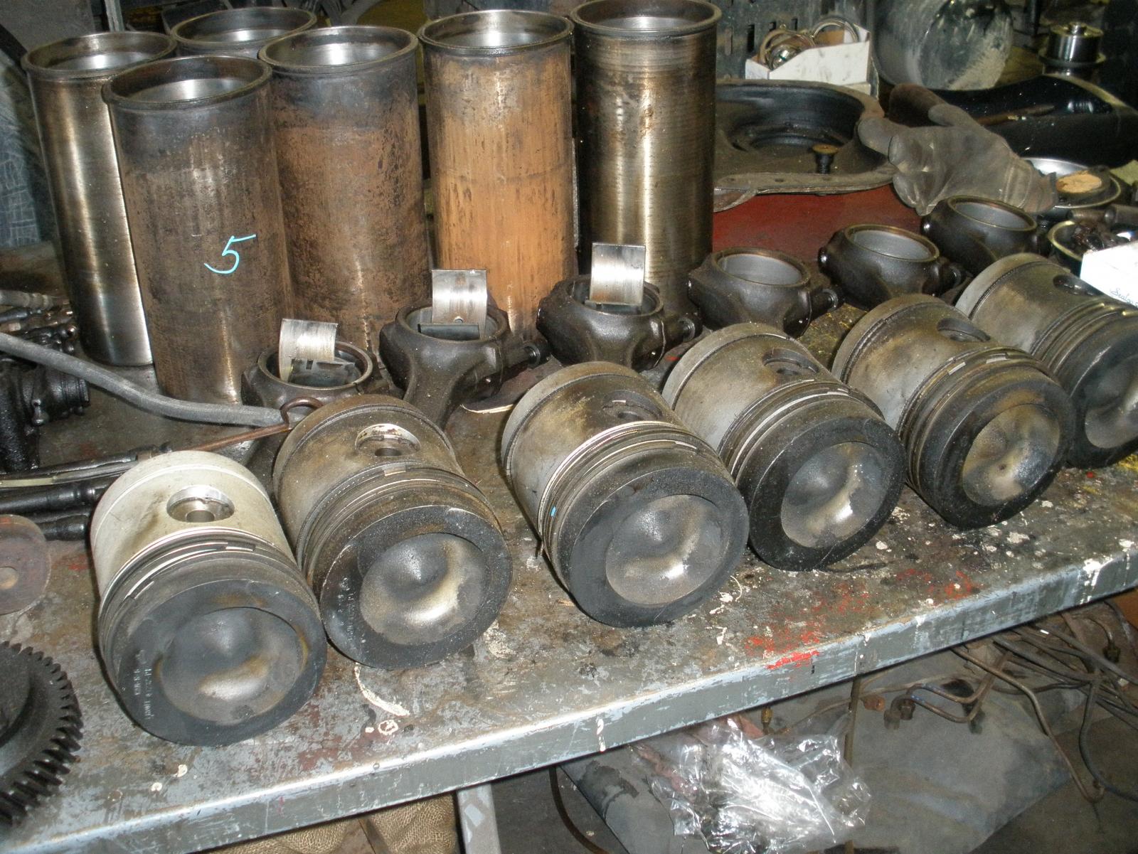

It all depends on how the original fit was.
If you look at the picture Mike posted you see the really rusted ones that probably "grunted" pretty good coming out.
Then if you look at the shiny ones they weren't as bad.
