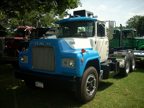

was a white R model with a blue frame and an exhaust unloader on the stack i assume for offloadin concrete? at Macungie last year. cant find a pic of it now tho. wish i had an underhood pic as i wanna put a hood scoop on the R model im buildin with a 300+. i have the scoop and ductwork, just dunno where to bolt it as my truck is a 66 and the truck it came off of i assume was a 78 or so , so the radiator was bigger. mine has the smaller b model sized radiator so id like a pic so i ana make a mount for the under hood filter and ductwork.

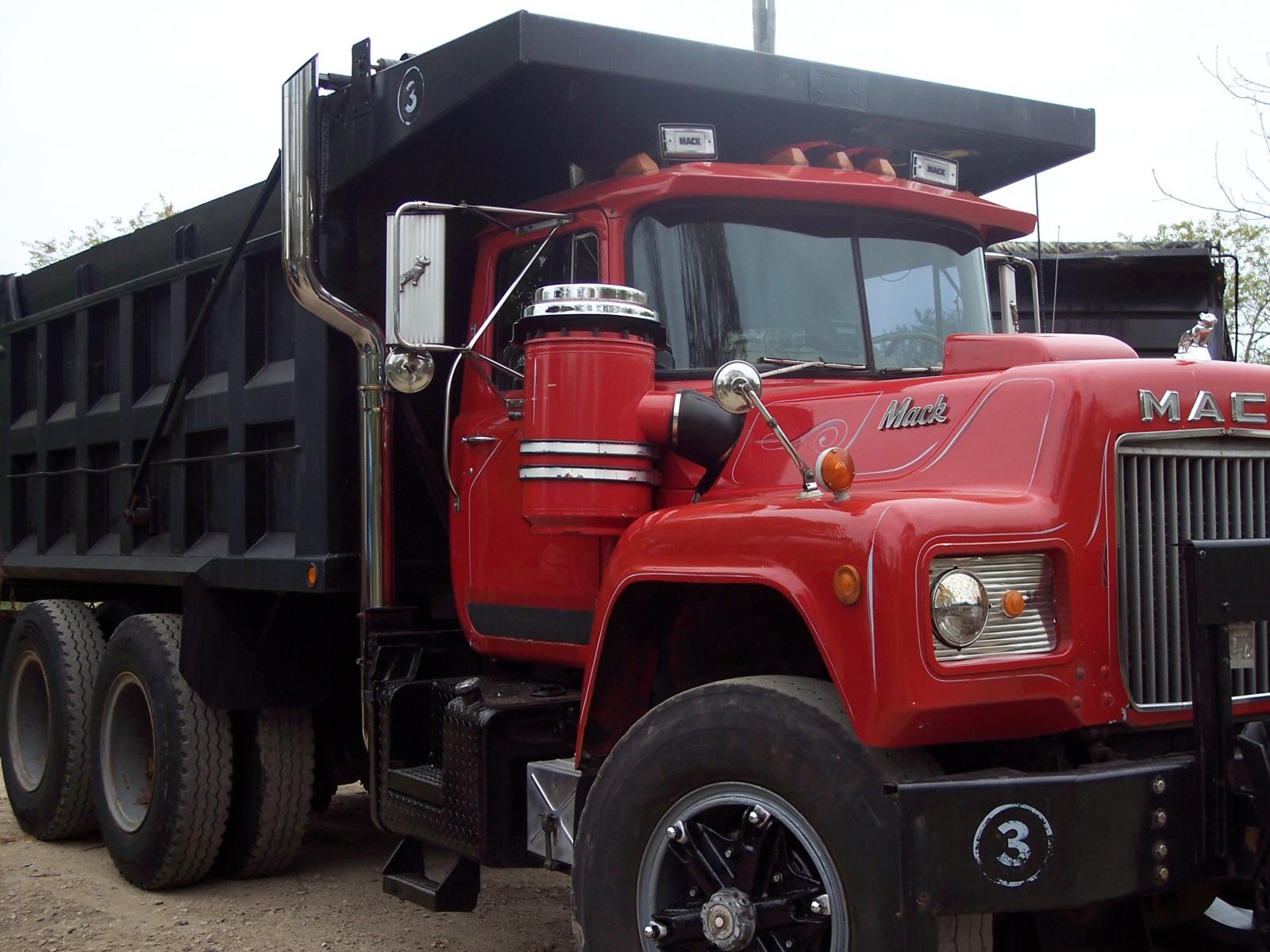

Up here the Lewis County NY Town Barn has 2 matching DM tandem dumps. (most likely sisters) I dont know about the other one, but one of the DMs was doing a job by my house and it had a hood scoop. Most likely a tip turbine then? I actually dont know where the other one went. Havent seen the hood scoop one in awhile now though. That red R model you posted staxx is awesome. Hope something gets done too it.
