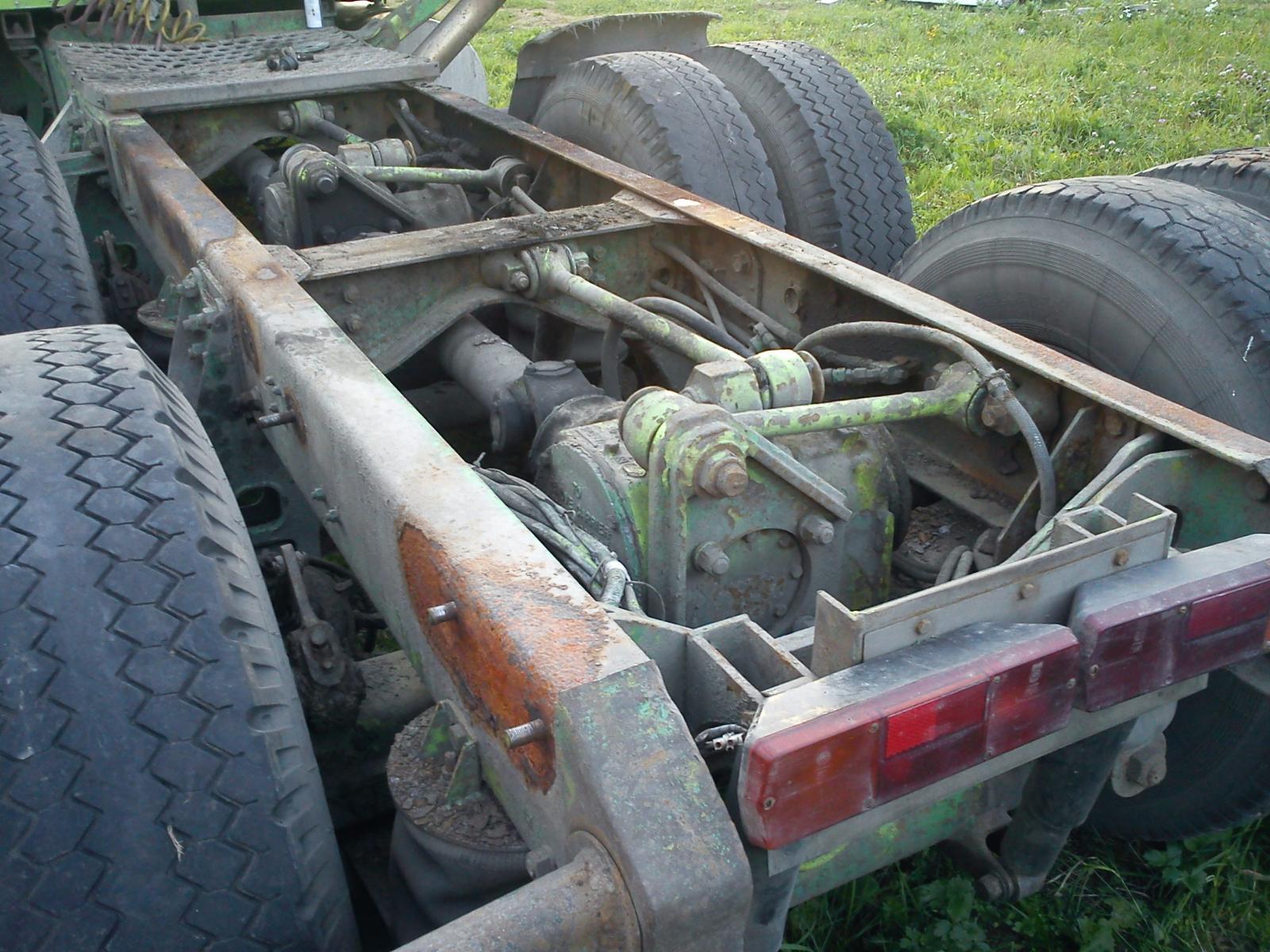

I'm looking at buying an old Superliner, but it has a bit of frame rust.
I didn't think it looked too bad, and intend to pretty much completely strip it down and sand blast it.
Should I split the inner and outer rails ?
What do you guys reckon ? Too much work ?
Thanks for any advice :)

yea its the spreading of the rails thats the big concern and hard to fix. surface rust is easy. However if its seeing rust on the surface I will bet that its started inbetween. it would be smart to put some POR15 in and let it soak inbetween to slow the rusts progress.
Just my .02
Slathering POR 15 between the rails will just make it harder to do right.
The only way to fix it right is the hard way- separate them--

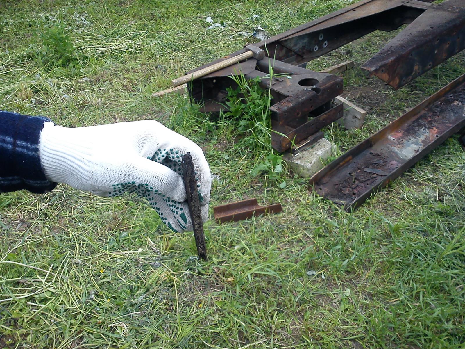

You can clear up a lot of the rust between the rails by using an air hammer. You'll be surprised how much rust will come out between the rails. Get some good ear and eye protection and have at it.
Someone has told me that is how the Mack dealer over here deals with this too in some cases.
