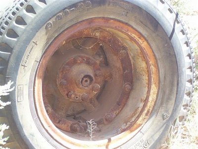

One of the AC Macks I bought for parts has these Pneumatic tire conversions on it made by Good Year
This is a late 20's early '30's conversion to replace solid tires with pneumatics.
The spoke wheel is cut off and machines to weld on the new flange to the spokes. The new inner rim and tire is than put on and than the outer tire and rim is bolted on.
Any body ever see an article or a booklet on his set up?
I know these are the true split rims and are a no no.
Paul
https://www.bigmacktrucks.com/topic/27527-pneumatic-tire-conversion-kit/
I honestly have no clue. I'd like to see what fits and use them on the AC I'm restoring, it has 7.50 x 36 and 8.00 x 40 on it now. I'm spraying mine with PB Blaster and un inflated them to eventually get them apart and see what the rims look like. Kind of why I'd like to see a booklet on them. I contacted Good Year and they have no public accessible archives. I would think some where on the hard parts would be a patent number. Three of the tires are 8.25 x 20 one is 9.00 x 20 so OEM rim width would only be 6.5 inches and I can get new 8.25 x 20 tires from Miller Tire in OHIO. Don't know if 22.5 wheels would fit as replacements until it comes apart. DO NOT want to use the 30's true split rim wheels!!!
Paul
