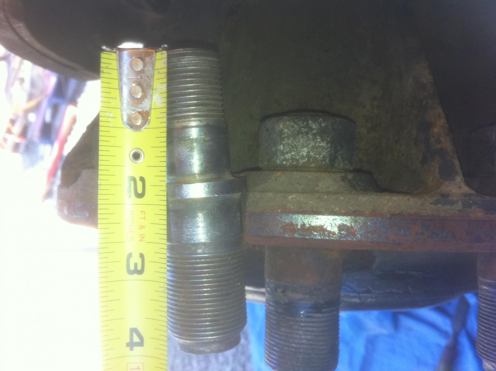

Superdog, you may have more options down there. I need about 5/8 more length on the outboard thread than in the picture. Some one must have put Aluminum on the old Mack before!
Im guessing 3/4-16 Left and Right thread on the wheel end but I dont know what the other side is, can you get me the thread size on the back. I found one that looks to be that size in my catalog its 5/8 on the back and appears to match the stud you have. I can probably find it I just need to know for sure what the thread sizes are and I am guessing the back length of 1.75" is ok but you need something more like 2.5 to 3 on the 3/4-16 wheel end instead of 2", is that correct and you have left and right handed studs not all the same correct?

This is the measurment of the studs I have, inboard thread .870 x 1.743 shoulder thru hub .939 flange measured on flat sides 1.152 outer thread 1.112 x2.114 , needs to be 3/4 inch longer Thanks
So if i have figured it right 7/8" x 1 3/4 long then the flange and 1 1/8 x 2 9/64 but you need an additional 3/4 inch so over all length to be at 4 7/8 to 5 inches.

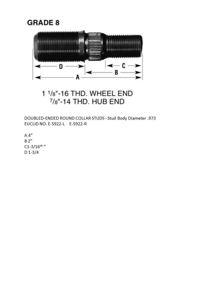

Based off that description of the original stud it should be a euclid E-5922-L /R, there is not a stud that is that size 3/4 inch longer

I forgot to get back with ya, I looked too but no luck, I found the 3/4 studs but not the big ones.
