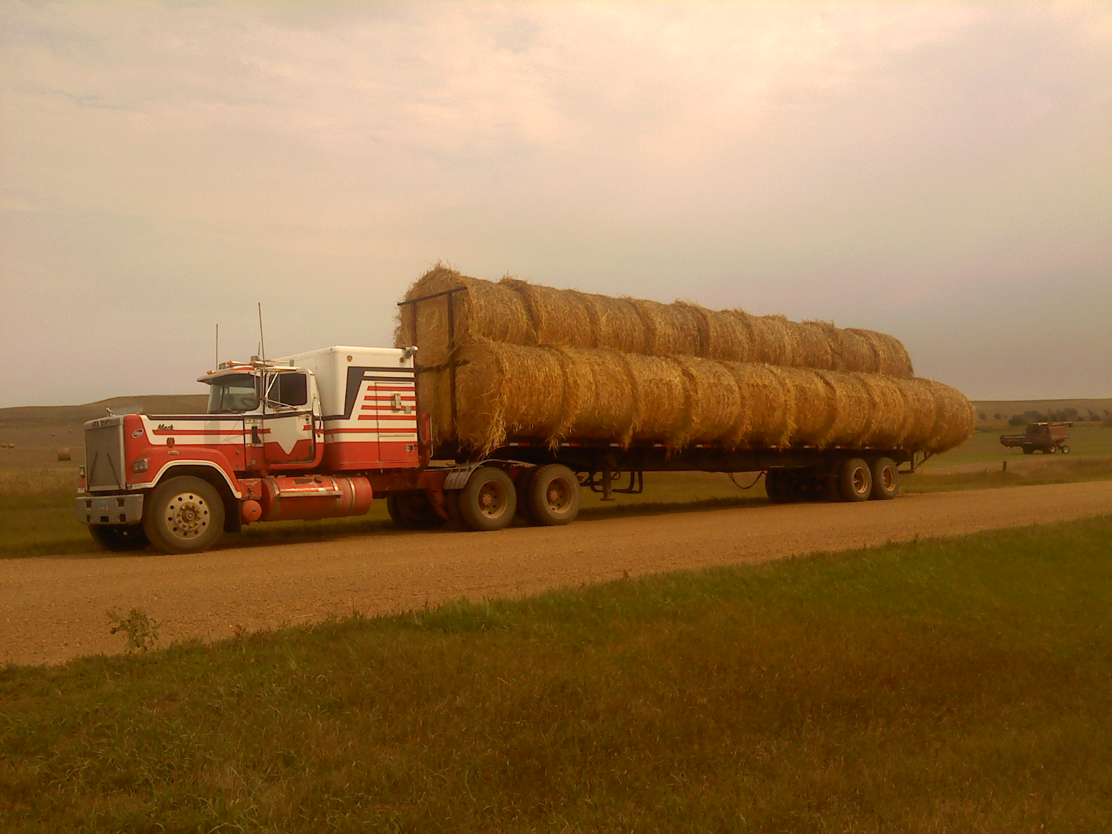

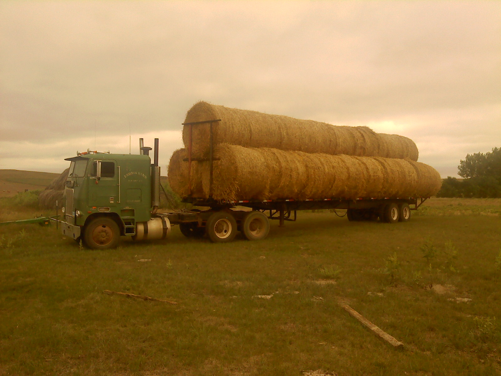

I am also attaching pics of our two big trucks.
post-12959-0-89067700-1350963790_thumb.j
post-12959-0-07615800-1350963811_thumb.j
