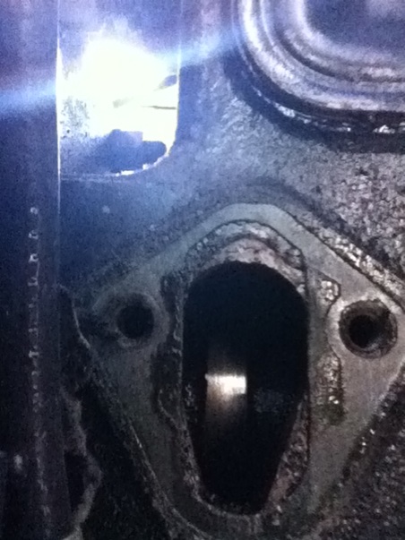

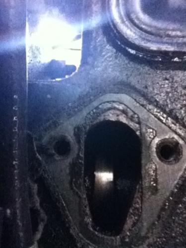

I unhooked the connection at the pump inlet. From that there is a rubber line about two feet long that runs to a hard line. I replaced that rubber line with high pressure fuel hose. The copper line runs all the way to the back of the tank. I unhooked the hard line connection at the tank. I blew air through the entire hard line. No obstructions and no leaks. I blew air into the tank and could hear it bubbling and see vapor coming out the gas cap. With the truck running I could feel very little, if any, suction from the inlet of the pump. I sprayed some gas into the inlet of the pump to prime. It did not take much before it came running back out. I hooked everything back up. I fired up the truck and still no fuel. The guy that rebuilt my pump said the arm on the pump that goes into the block may not be seated right on the cam. I assumed that if the arm gets inserted into the hole in the block and you are able to bolt it up, it must be in the right place. I guess that may not be the case. I might have to remove the pump again? Any suggestions
Almost right. When you put the pump into the hole you should have to hold pressure up and in while you start the bolts. In essence you are pressing the pump arm and it's spring against the pump lobe.
I had a 66 Ford that wiped out the fuel pump lobe. I used an electric pump to keep it running.
Sounds like you are on the wrong side of the cam lobe. You will be able to feel some pressure against the pump when you put in the bolt. You will actually use the bolts to pull the pump against the block. Paul
Arm goes under the lobe most time, Heres a pic of the cam lobe on my Willys Go Devil .
post-3242-0-24763800-1351382479_thumb.jp
The Fuel Pump arm absolutely needs to be against the cam lobe when bolting it up to the block (and you will feel the pressure when bolting it up). Also to verify that it is working properly you can add a t in the line (pressure side) and add a line to a fuel pump gauge to read the pump pressure and make sure it is indeed pumping. I used this to diagnose that our B75 was actually running out of fuel becuase the fuel pump (just rebuilt) could not keep up with the demand while at operating rpm. It could keep up all day at idle, but would run out of fuel while driving, so use the fuel pump pressure gauge to monitor the pressure at idle and while running. The B75 would drop pressure (typically 2-3 pounds at idle) and run out of fuel (0 PSI) when under load.
