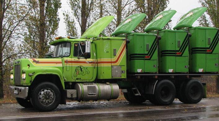

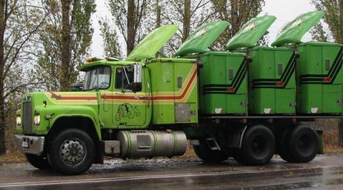

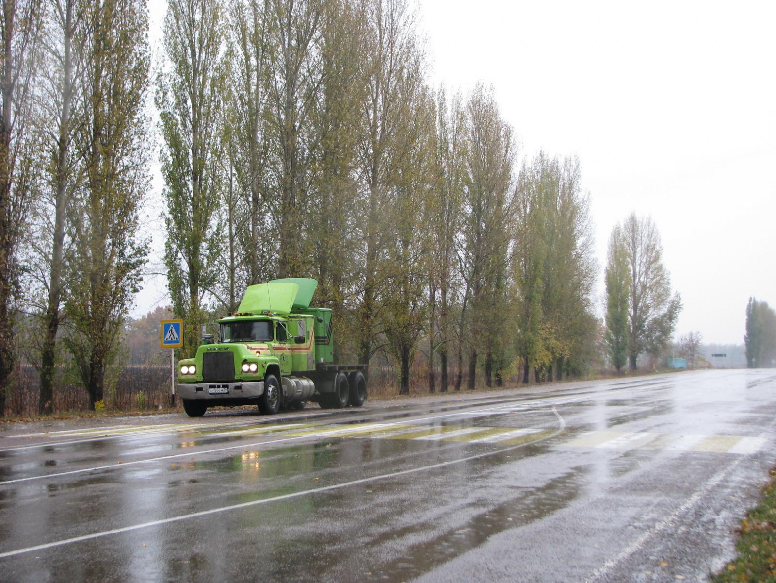

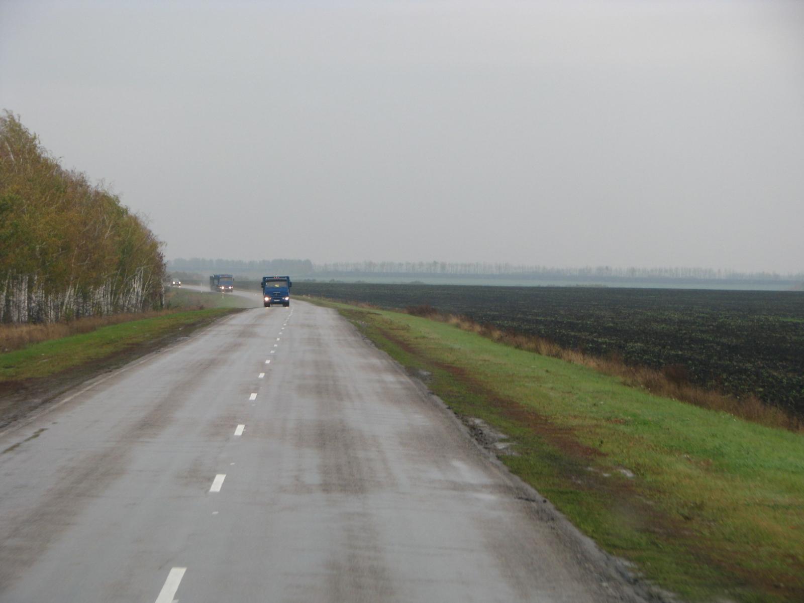

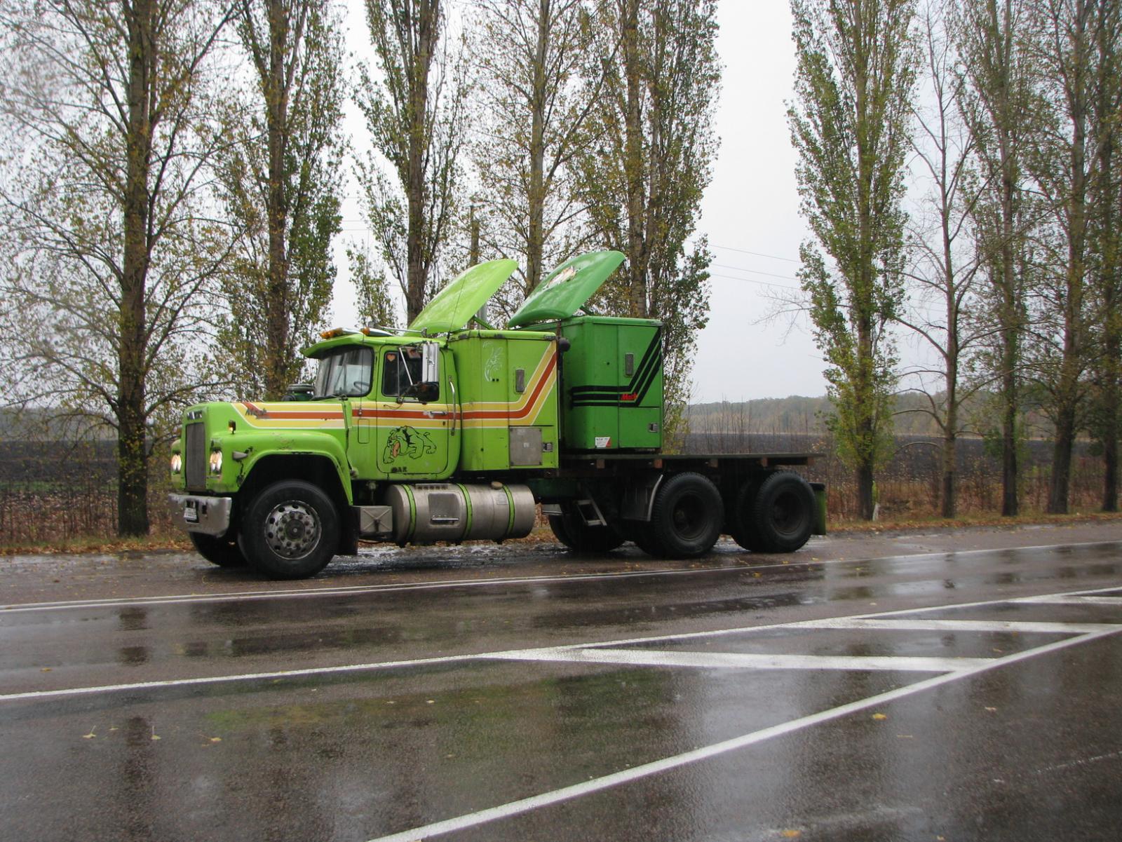

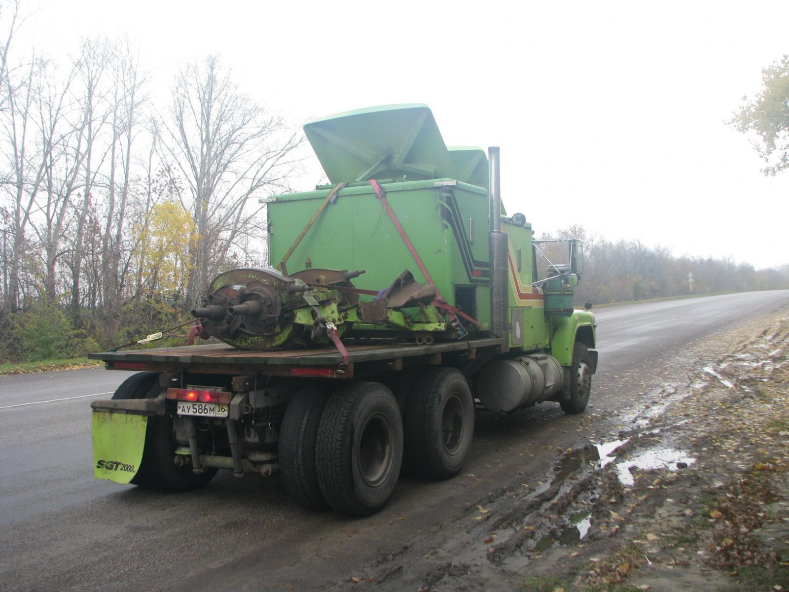

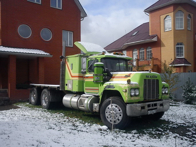

G'day Vlad,
She's a good looking truck. Does it ride well with the air bags? Tell us about the engine, transmission and diff ratios please.
Looked like a nice drive home, but perhaps a little cold hahaha.
