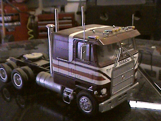

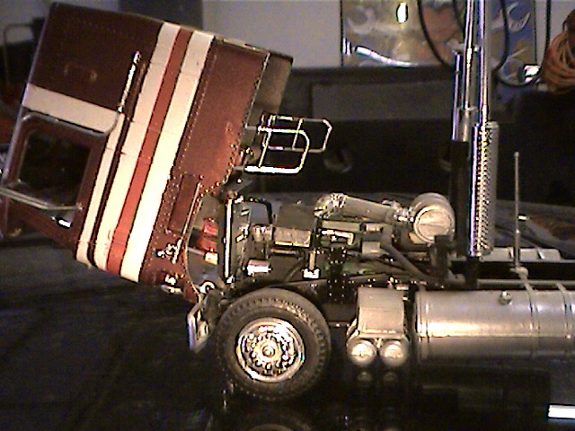

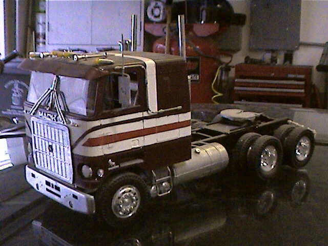

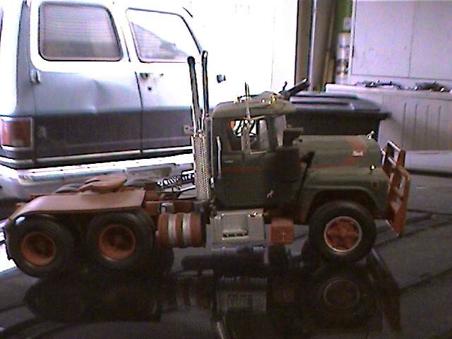

If you dont mind, I posted some pics of the Cabover Mack from Convoy I built 10 years ago. I also posted a pic of the Mad Max R model I built around the same time
There is a member here that built up the Duck truck and did alot of extra detail work like you did.

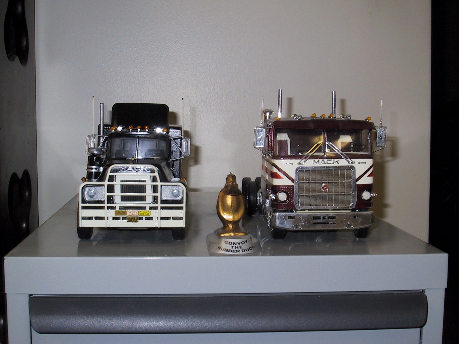

Fantastic work Sergey. The amount of detail going into that build is amazing. If you follow the link in Lmackattack's post you can see my Duck build but I certainly didn't put in all the detail that you have!
