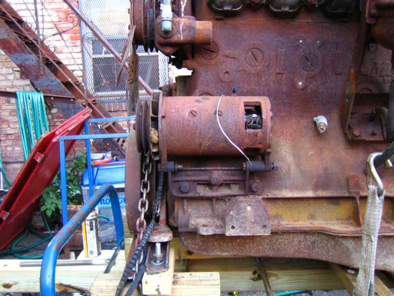

Ok I got the engine and trans out of the van. Now I started to strip the engine down a little and was busy removing the luberfiner and the generator. Now how the heck does the generator come off? I see three bolts one on top to adjust the belt tension and two on the bottom like a hinge. All the nuts came off the two bottom bolts but the bolts wont come out. I even put the nut on the end and gave it a few sharp blows with a drilling hammer but they wont budge.

Ok the two bolts under the generator will not come out. Ill try a torch and more PB.

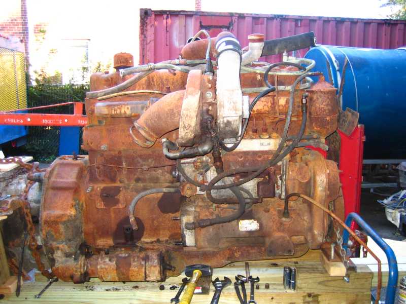

Broken by the seller with his loader, thankfully that part unbolts.
Left side minus the air compressor. It was a Bendix Westinghouse tu-flo 500.

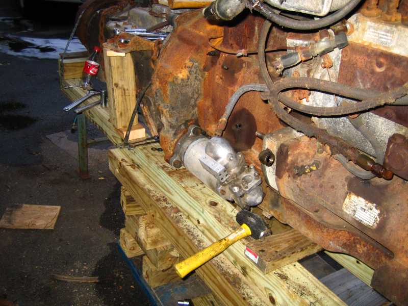

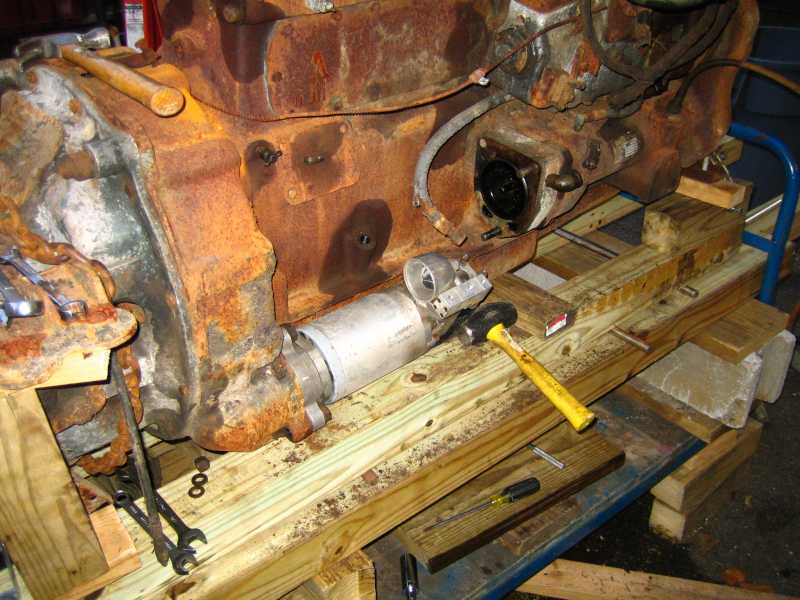

Ha, found out my Gali air starter fits not sure of the pinion though. I bought three for 60 bucks on eBay.
Unfortunately allot of crud and dirt came out of the bell housing when I pulled the starter.

Thad, try putting a socket and breaker bar on those bottom generator bolts and get them turning while repeatedly soaking them with PB.
Once you get them turning freely then try driving them out with a hammer and punch.

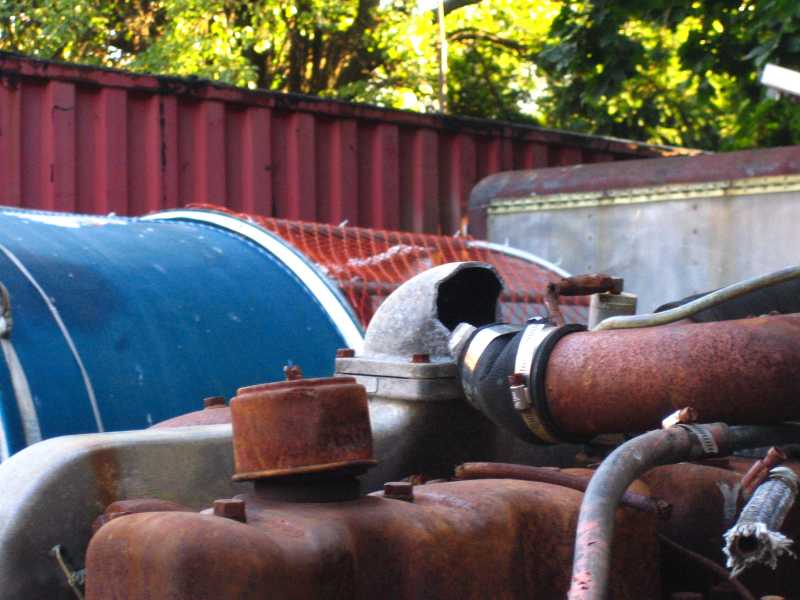

I got the turbo off today. It wasn't easy had to heat the nuts with a torch and by using a chisel and drilling hammer expanded the nuts till they freely turned. Its frozen solid but Ill pull it apart and try to get it to spin. I ran water through the turbo cooling ports and no crud came out.
Still haven't pulled the oil pan but I did peek under the rear valve cover and all looked good, no rust or crud. Fuel return line is cracked and the primer pump is a hunk of frozen rusted metal. The fuel filter is rusty but was full of old diesel.
