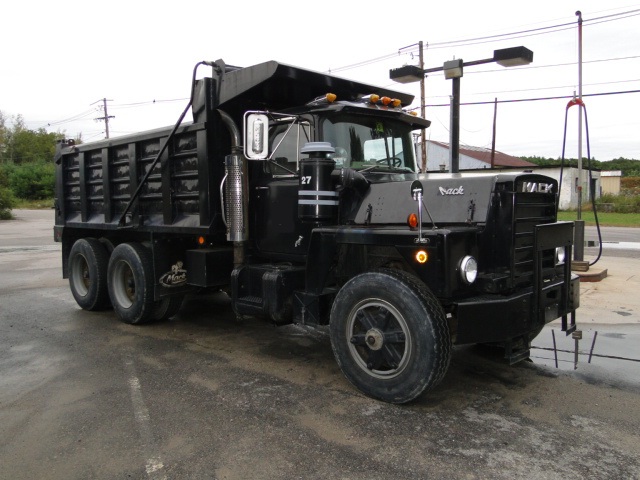

I've been lurking here for a while without posting, but I feel the need to benefit from the wealth of knowledge on this board. I'm a 3rd generation "dirt worker" in the Adirondack Mountains of NY. We aren't a big outfit by any means, with 3-6 employees depending on work load. We have an '05 CV713 granite and I just picked up a '74 RD685 (I'm a big fan of mechanical things!) from Mass for a second truck. I didn't have time to go look at it, so I settled for a bunch of pictures. It is a solid older truck, but I must admit I have a little buyers remorse.

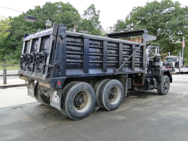

* The double frame behind the cab is separated and has split in a couple spots. One has been repaired, one has not. I know its just a matter of time before it splits again. So how big of a deal is it to replace the rails from the cab back? In theory it should be like a stretch job, just replacing the rails to the same length they were. I have a local guy that will do it this winter, he gets the rails from PG Adams. WHat can i expect to pay, are there any hidden challenges or secrets that go along with this job?

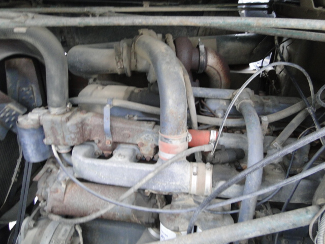

Yup, thats a 237. ENDT 675. You can tell because it doesnt have the big aftercooler thing on the top of the motor. The serial number of the truck also tells you what it had for a motor from the factory. 85 in the serial number meant it had a factory 237. Looks like a remanufactured too from that gray engine paint.
do a google search for TecBrake,I tried to post a link but couldn't get it to work.They took over Jacobs older line of engine brakes and have a kit for your engine.If it's a good runner,leave it in,nothing wrong with a 237.
