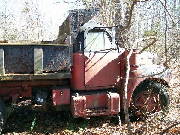

Still sitting in a tree line next to a farmers field. Just struck the deal and still need to go to the bank. The truck was originally a Carolina Frieght truck. B73 Concave cab with a short nose and a single axle. ENDL 673, 9spd OD Duplex, and a 4.65 rear axle. Some time ago it was converted to a dump truck. She has been sitting awhile and the front glass is toast. Cab is good but the floors are a little ruff. No telling about under the dash. The glove box is full of water from the busted windshield. Hopefully I can get her on a trailer in the next couple of weeks and rolled to storage. If anyone needs some parts let me know.

Nice, looks like a Carolina truck to me. Would be a good dump truck for Papa around here.
PICS of the bed don't do her justice. I can look at the rear by standing on the rear tire.
