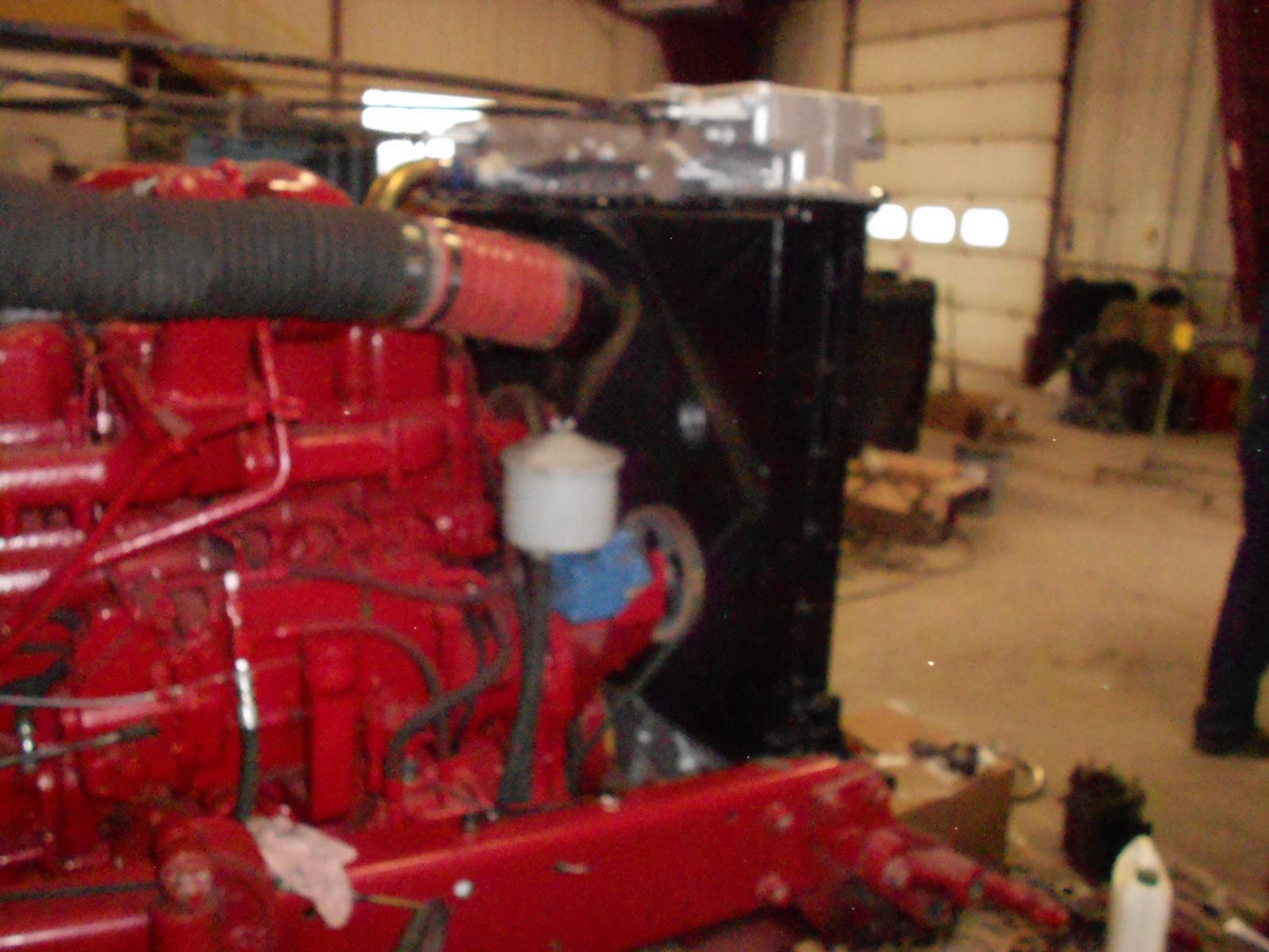

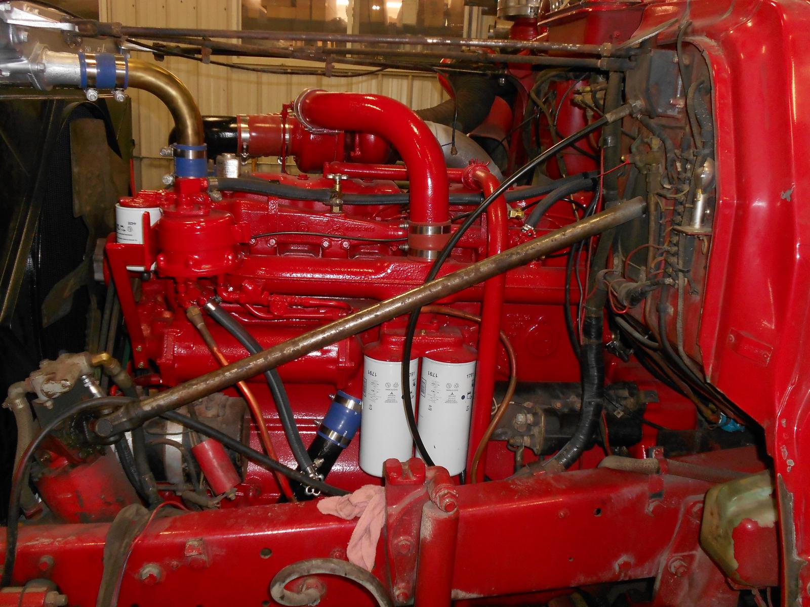

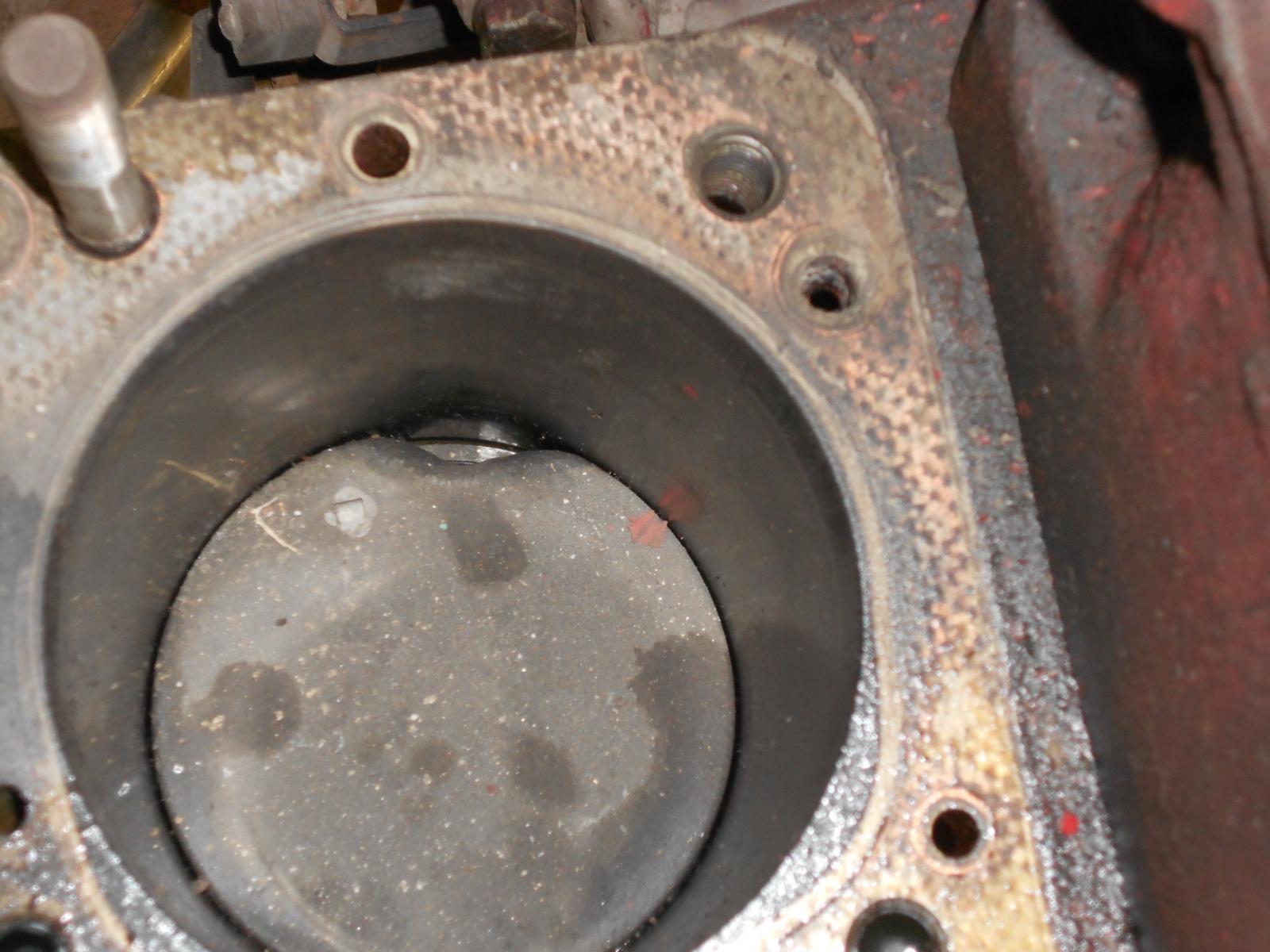

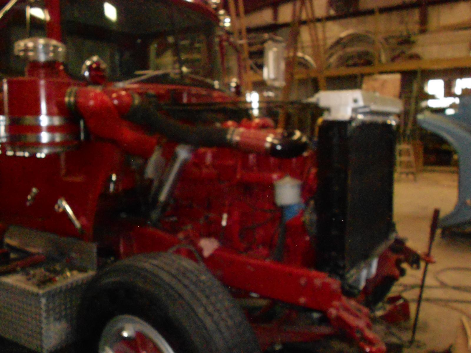

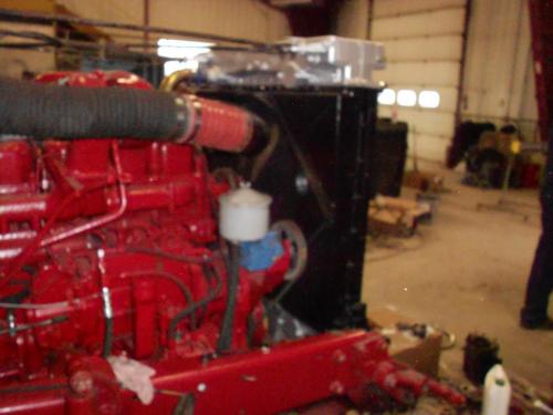

post-8009-0-72958500-1352767982_thumb.jppost-8009-0-72958500-1352767982_thumb.jppost-8009-0-93647900-1352768139_thumb.jppost-8009-0-20172300-1352768274_thumb.jppost-8009-0-86065100-1352768443_thumb.jpWe are almost finished repowering this R-608 pumper with a ENDT-675(237). The original 707C gasser had a burnt piston and scored cylinder walls.We had no luck finding another 707C so discussed it with owners and decided on the diesel. Her are some pics:
https://www.bigmacktrucks.com/topic/28318-r-608-f-repower/
Thanks guys. With the rear ratio it figured about 50mph top speed.Was acceptible to fire dept.This is still a working truck by the way.The radiator is from an old R model tractor. Both tanks were repaired(new corners tigged on, tapped holes helicoiled) and a new 4 row core from Detroit Rad. installed.The polished alum. came from a spray can.I'll get mor pics when it's complete. Steve
