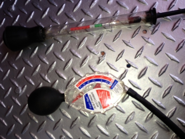

coolant hydrometer on bottom, battery hydrometer on top.
this thread got me thinking that I have not checked the freeze level of the firetruck yet this year, so this morning while I was doing some yardwork, I lit her up and let her run for 45 mins, and then checked- I'm good for -20F, plenty for my neck of the woods as we RARELY see anything below Zero F. Once in a while we'll get down to maybe -2 or 3 but thats it.
Measuring your freeze level is critical if you have slow coolant leaks like I do (and may old trucks do) and you add water or mix constantly throughout the summertime.
