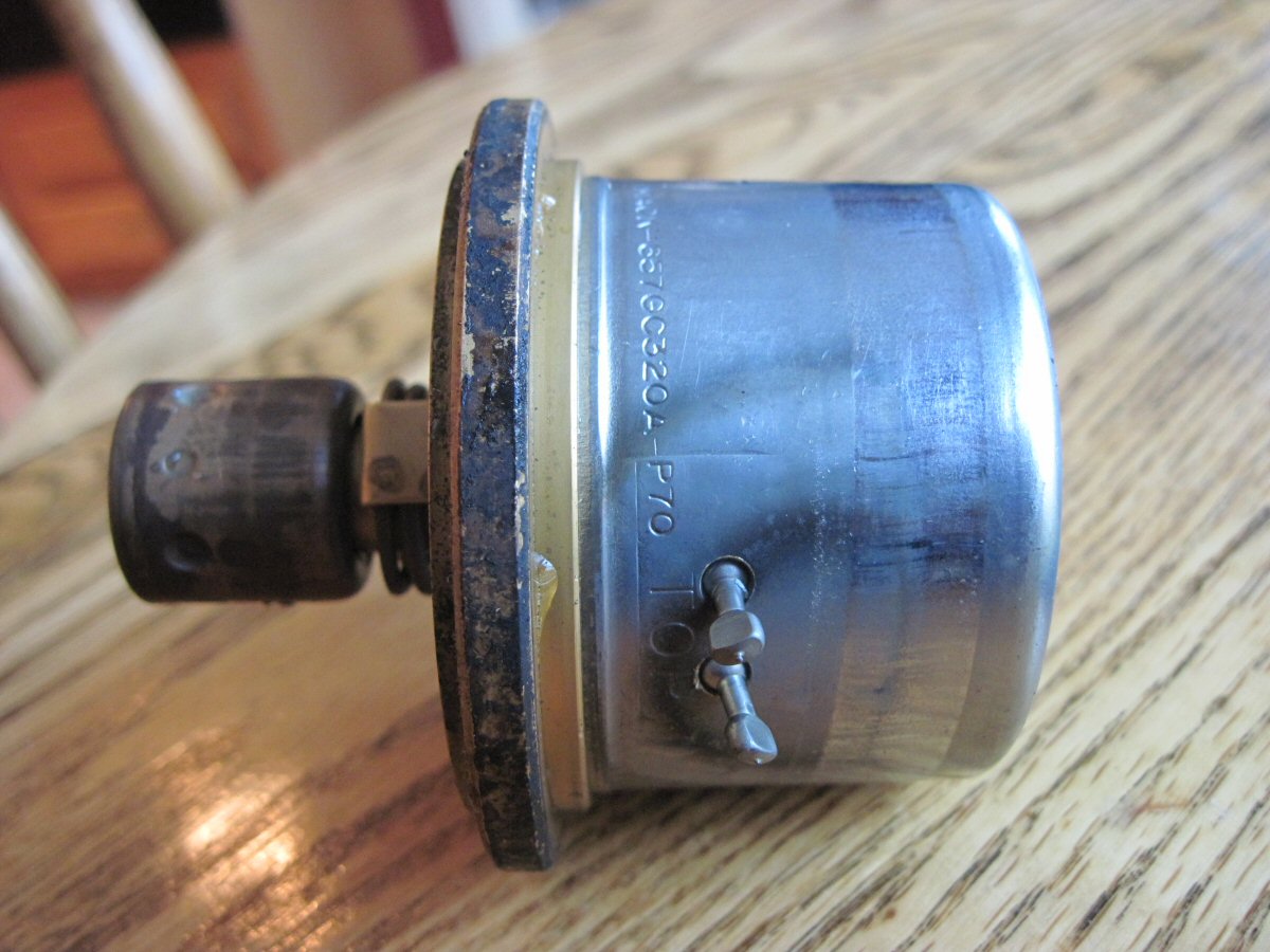

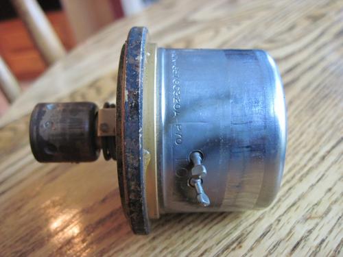

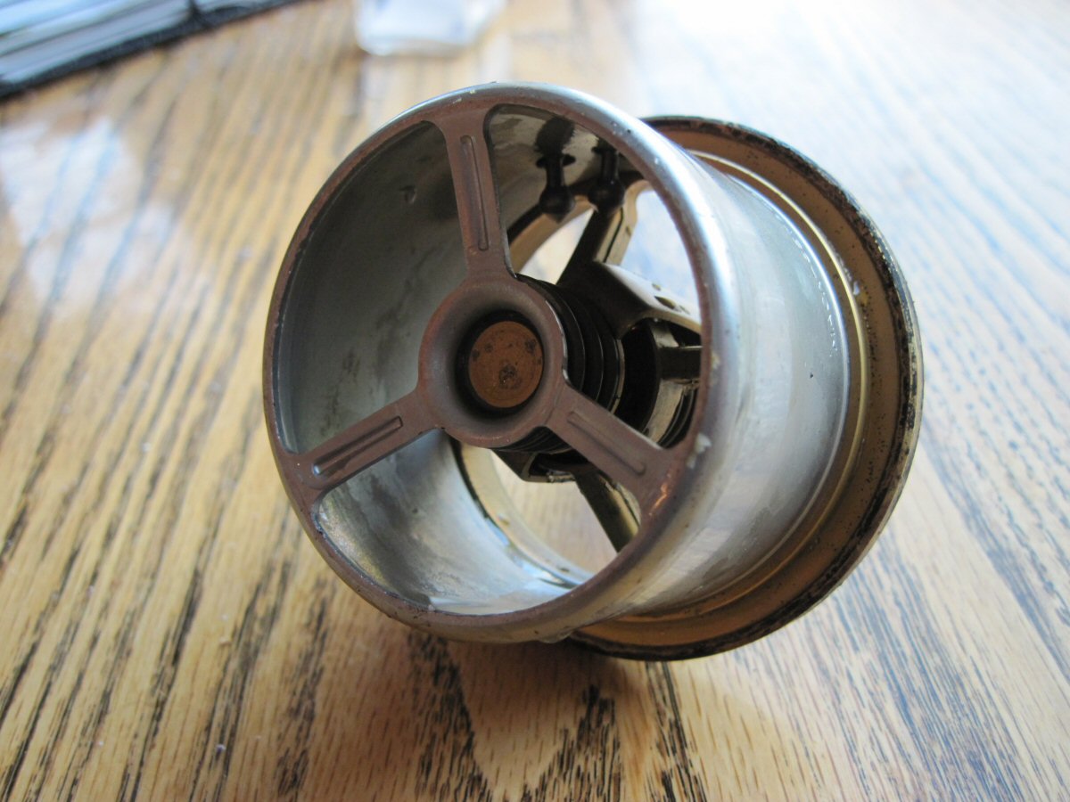

Well, here is what the thermostat looks like for those that have not seen one...put it in a pan of water and tested it. It opens at
155 degrees just like it is supposed to! This is not the problem....hmmmmm

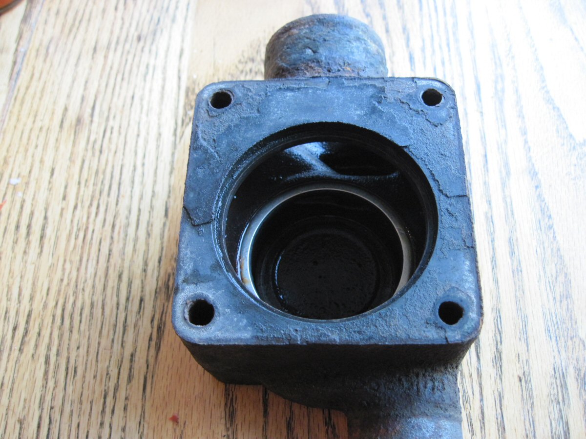

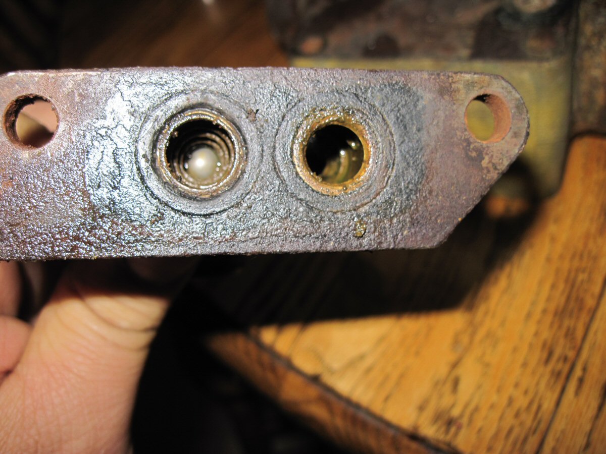

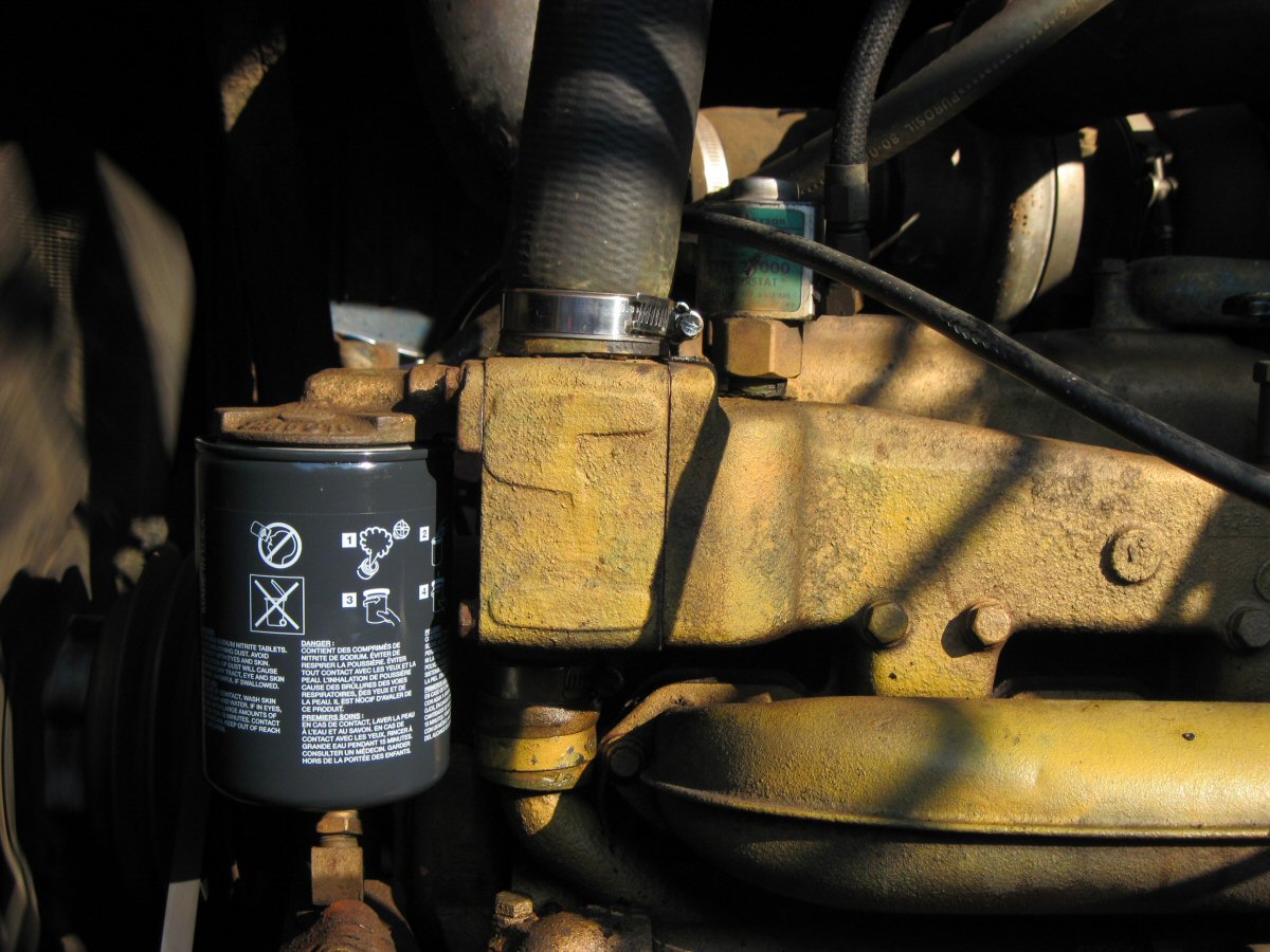

Took me a little while to figure out how this thing is supposed to work...the hose from the bottom comes from the oil
cooler and allows that water to flow to the radiator even when the thermostat is blocking the discharge from the water manifold
post-6773-0-72039000-1353637937_thumb.jp

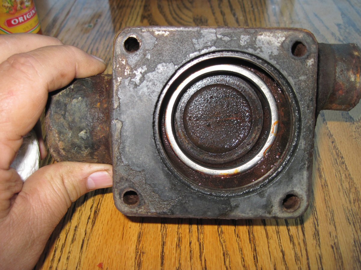

Down at the the bottom is the seal that the thermostat fits in to the seal off the water from returning to the radiator, you can
see in this picture the seal is completely gone! That is why the truck would never reach opearting temperature, the water
was free flowing thru the system.

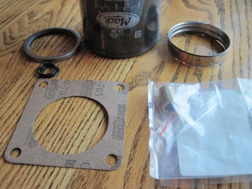

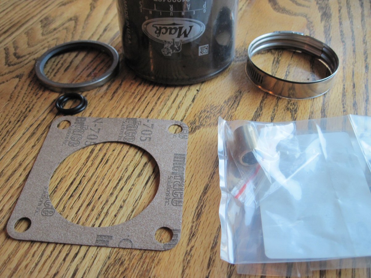

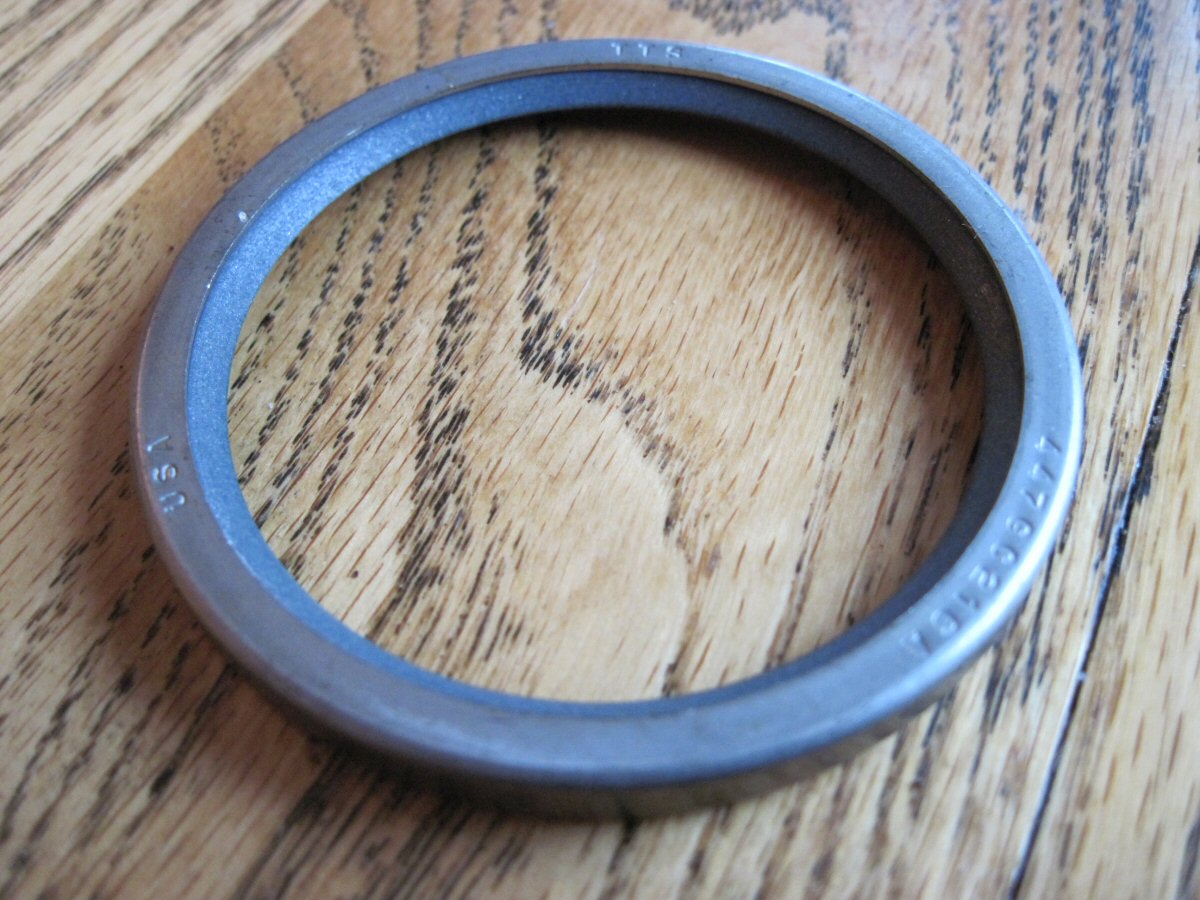

A quick trip to the Mack dealer and $40 later I have all the parts I need, gasket, O rings, water conditioner cartridge,
even new check valves for the water water conditioner.

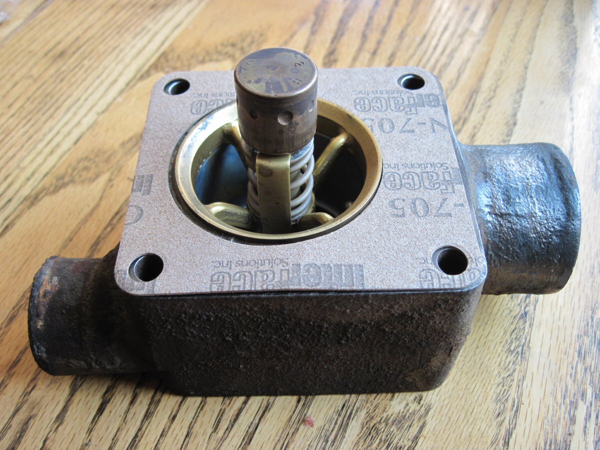

Put it all back together, no leaks and the truck builds heat now much better than it did before...had 145 degrees pretty quick, as it
was cold today that is all of the heat that I got, but the radiator was not hot (exept for the oil cooler heat). I think it is a worthwhile quick

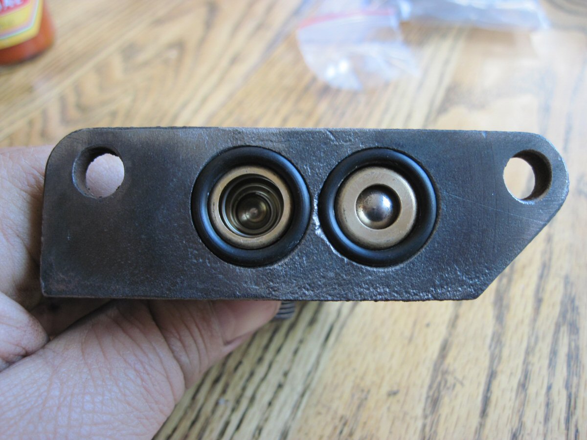

project which might help your engine and block! The water conditioner helps eliminate scale and rust buildup in the block...my conditioner
looked new, but the check valves were NOT working, both were seized up!

Interesting. Mine has always run at 160+ degrees pretty regularly. Lucky I guess. Mine doesn't have the oil cooler though. Is that screw-on a charged filter for coolant? Be interesting to add that to mine? I've had the coolant out of mine a couple times in the last 10 yrs, added a few new gallons, but never checked PH level. Probably should?
