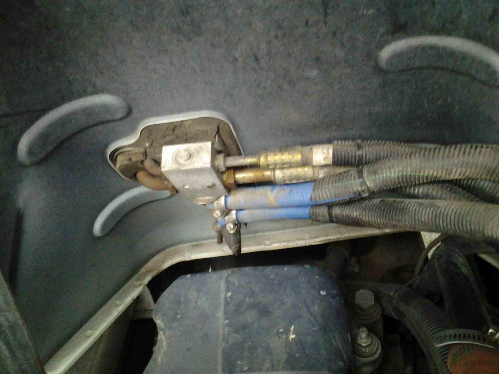

...I'm still stuck with the same problem as before. I replaced two thermostats and a valve, I took out the heating core again and still nothing.When I let the coolant flow through the heating core, it instantly become hot, but when I attach the outflow, then nothing works. Any other ideas since there is no valve on the outflow. I don't see any signs of leaking/pushing coolant out of the system.
Is this a sleeper truck? If so the lines may be run in series and the sleeper control valve could cause this issue.
Bulldog is right..for some reason when outflow is attached to the engine,coolant flow is somehow blocking.It's a day cab.Now I'm scared to death,because what I'm thinking now is eater compressor,EGR or leakage from piston ring,which make pressure and stopping,blocking coolant flow.Tomorrow I will have to go to Ripon ,WI...wish me good luck with temp 18 F and snowing.... :(

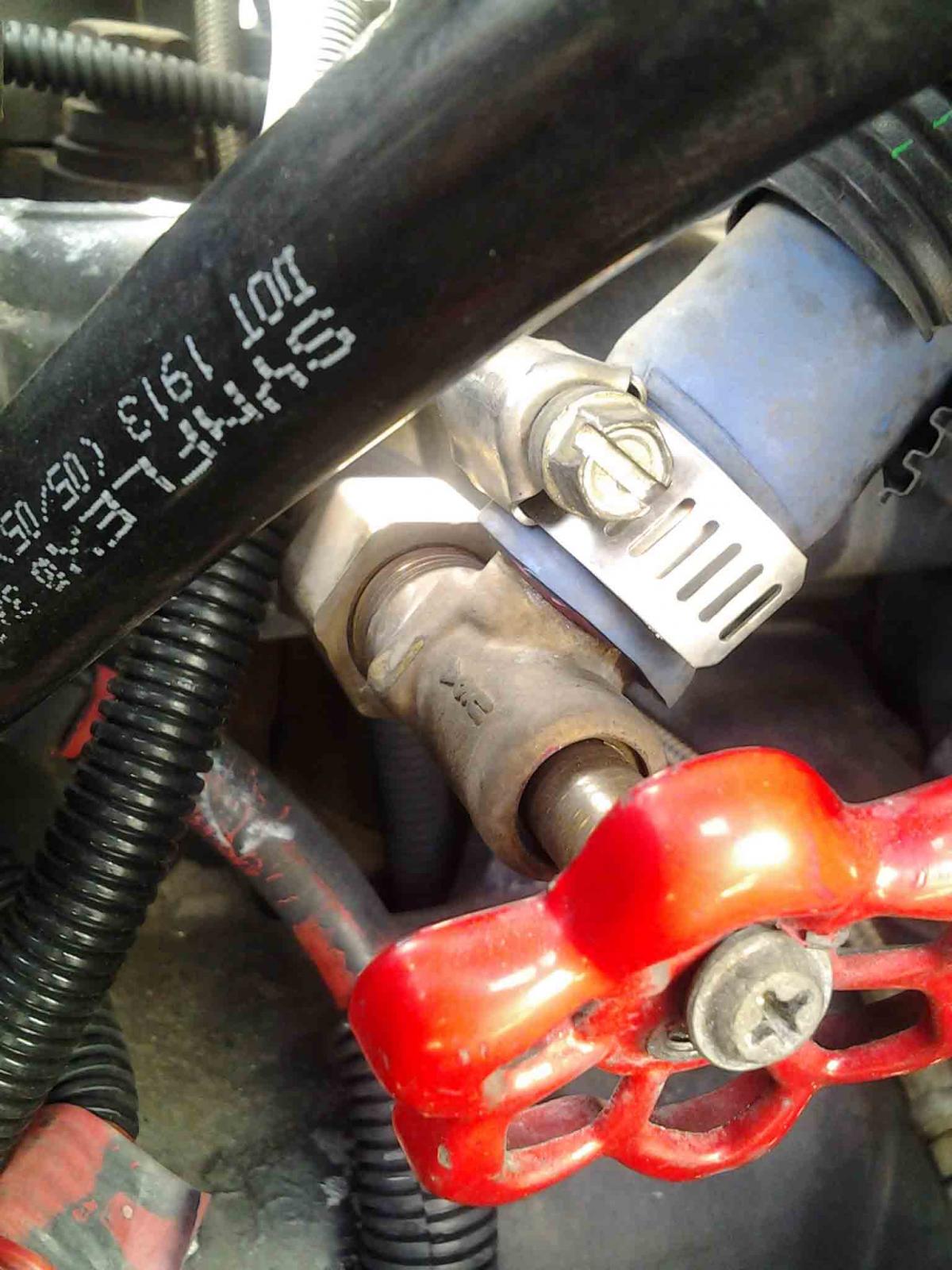

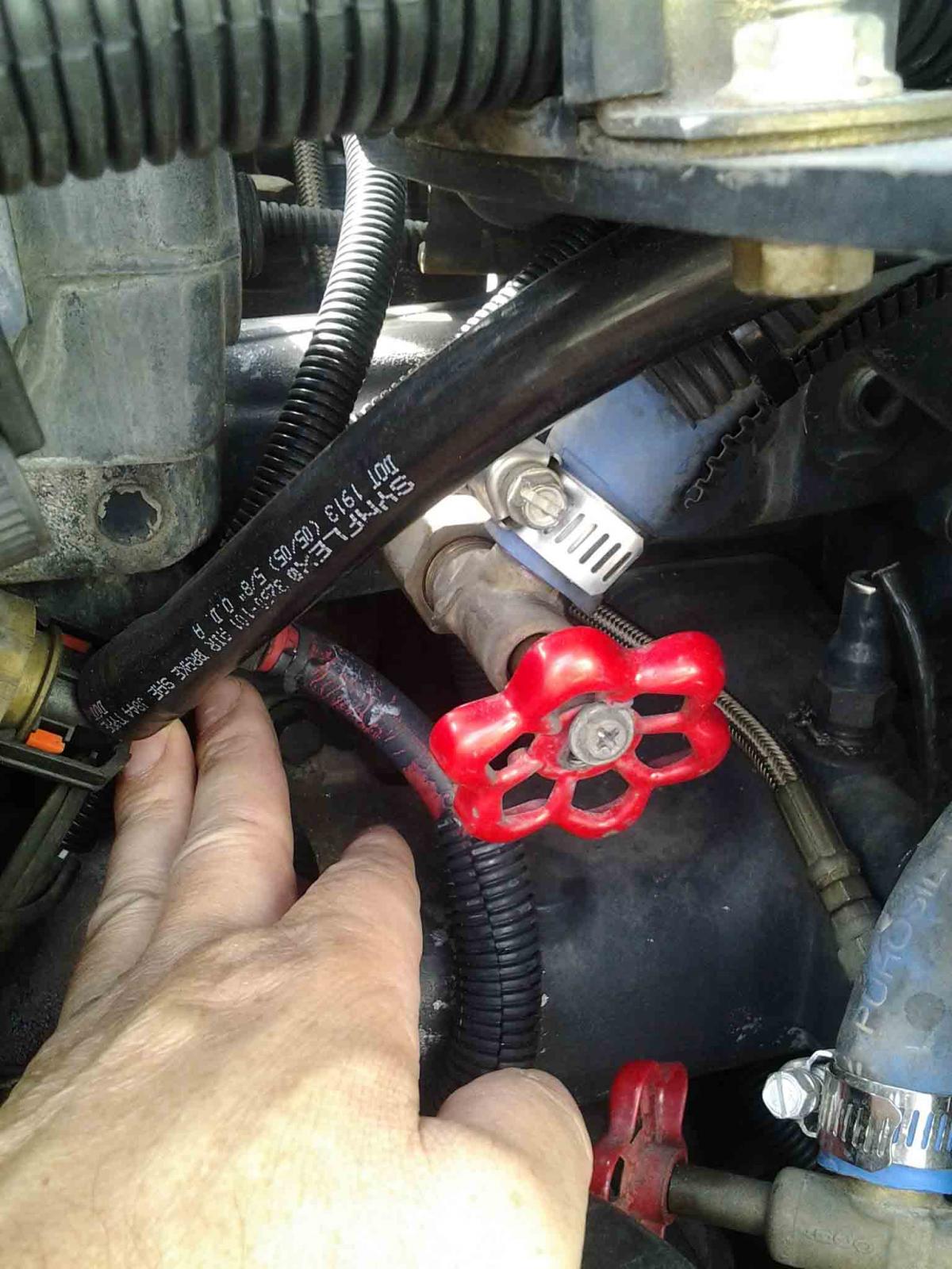

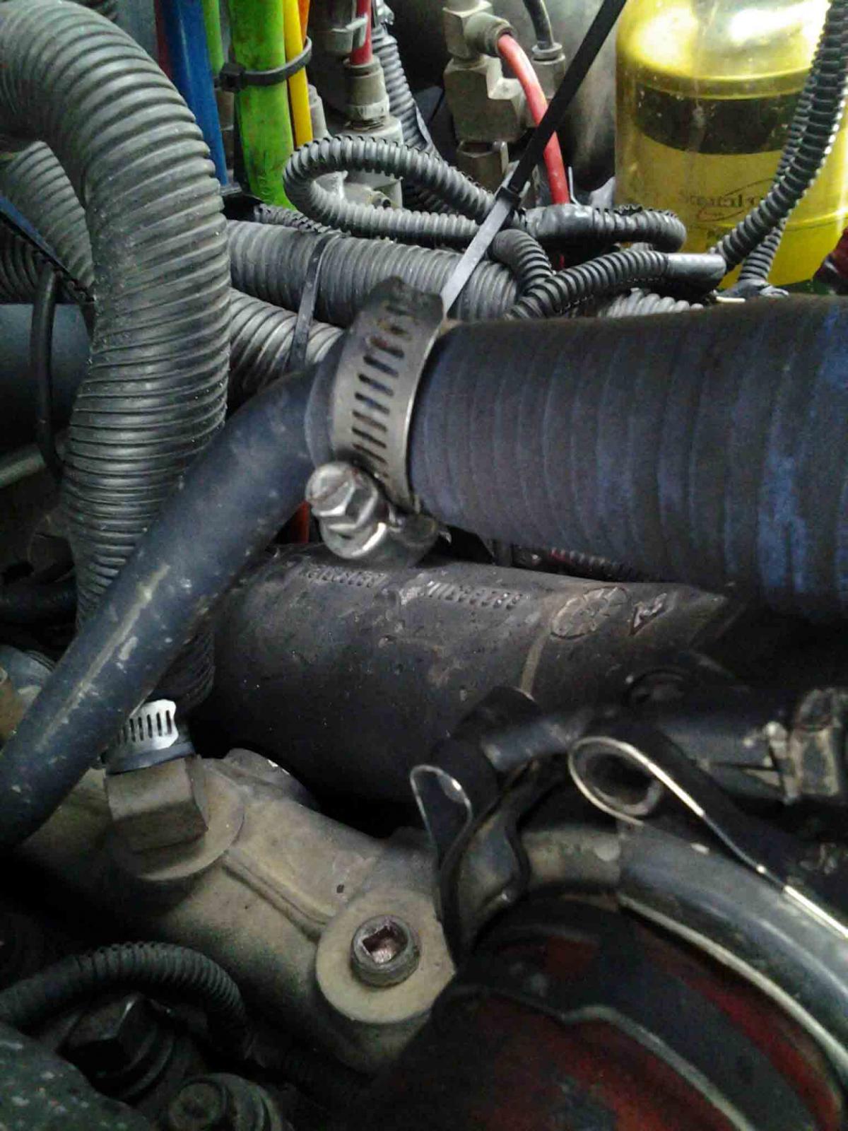

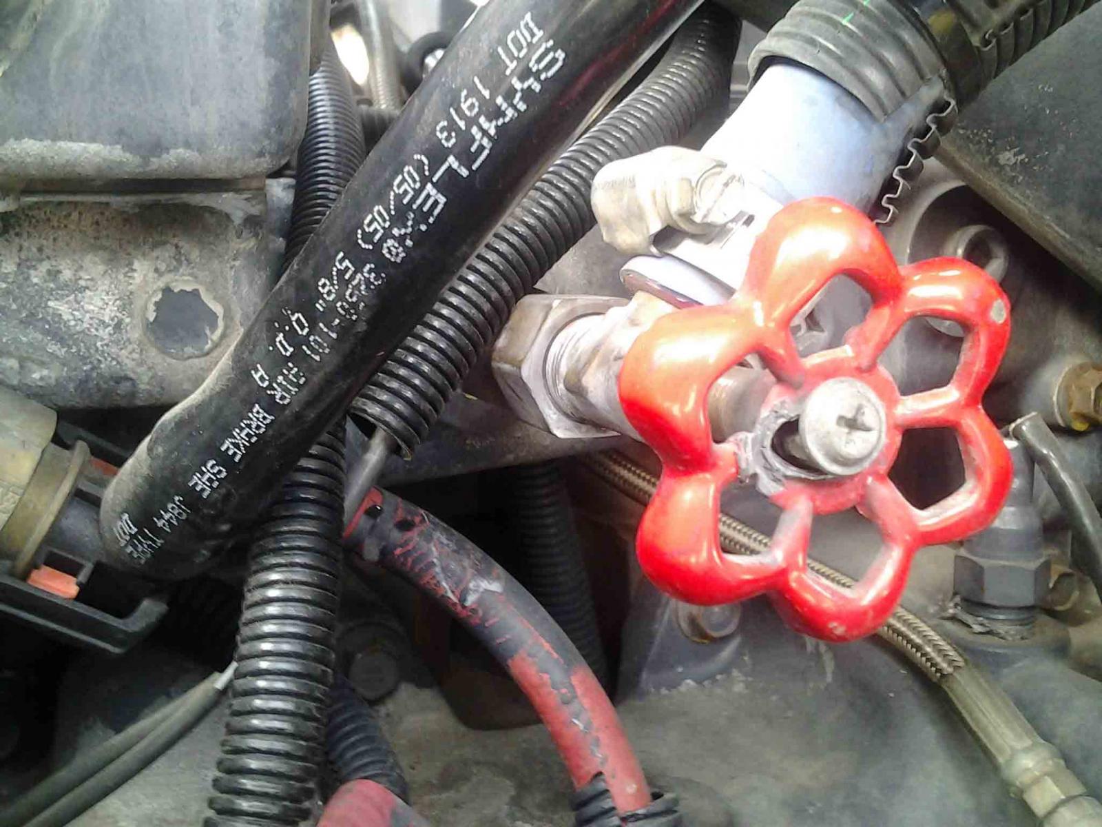

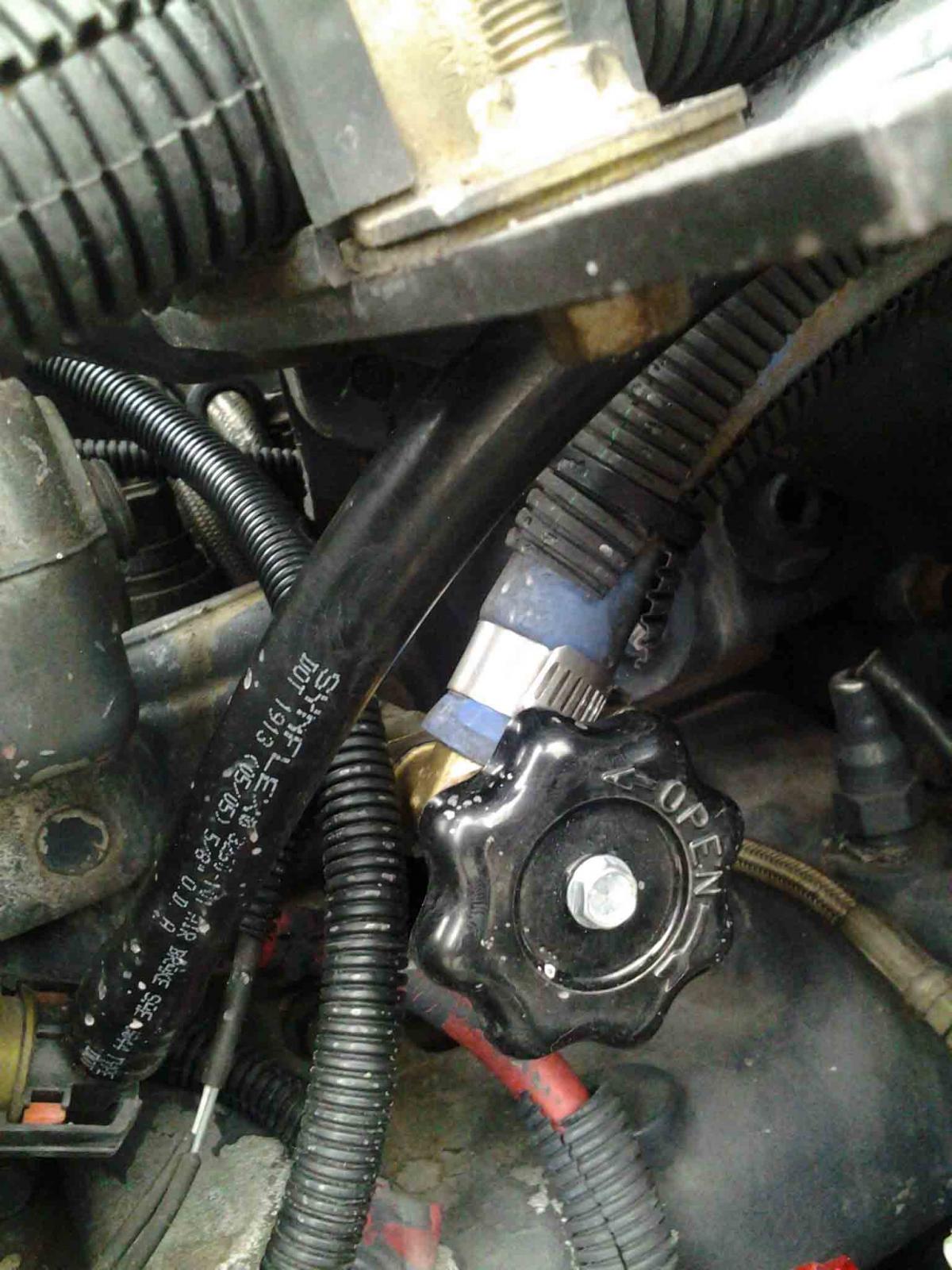

Take a picture of the fittings the hoses connect to on the engine and post it here please, if you are getting water to the core but it won't flow back to the engine there is something closed or blocking I doubt its making pressure and stopping it, you would have a pressurized coolant tank and lots of stuff coming from the crankcase vent tube.
just a thought... Is your coolant level low? if it is water might not be able to get to the heater core being that it is one of the highest points the coolant flows to... if its topped off it has to be a bad valve or blockage. does that water pump have a nipple on it that is capped off or is there another nipple you can plumb into?. you might be able to run a hose right off the pump and see if that corrects the heat?
Only one coolant hose from heater core attaches to coolant manifold second line from heater core attaches to lower steal surge line that goes up to coolant overflow tank the other coolant fitting on cooant manifold goes to raycore fuel heater out of heater and back to lower steel surge line .. Looks like both your heater core lines are attached to water manifold from angle I see and if it is this why no heat same water psi on both lines no flow.
Yeah one of those hoses need to go to tank not back to the same manifold.
