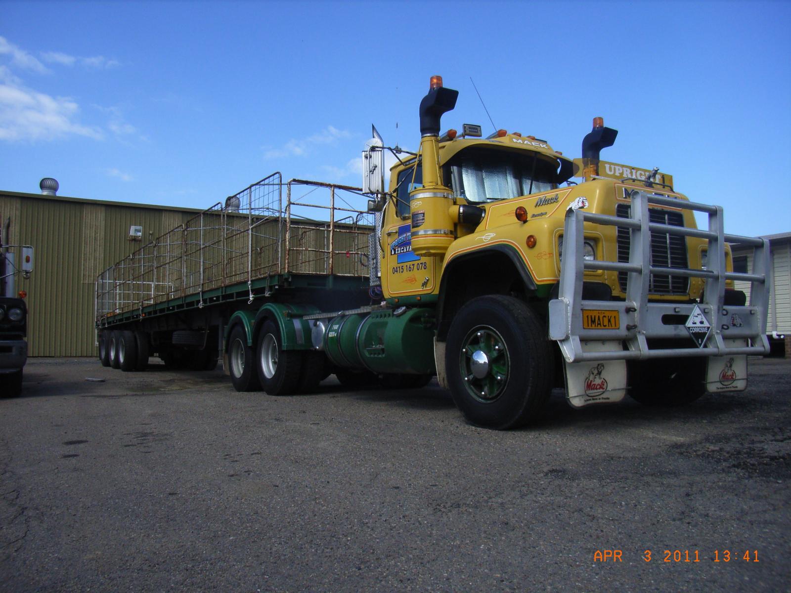

Thinking of puttng a sleeper on my r model I have choosen the 32 in high rise as it gives me more swing clearance on oversize loads
does anyy one have any hints or sugestions before i start
i have fabricated chassis mounts from 100 x 75 x 10 angle bolted to main rails with 16 mm bolts then sitting cabin on rubber mounts
mian thing that is holding back is finding the best rubber boot to join to cabin as iam keeping original rear window opening size as the cabin is 100% rust free and i couldnt bring myself to cut a bigger hole will post pics when i start
thanks KARLpost-7759-0-68050000-1354648068_thumb.jp
