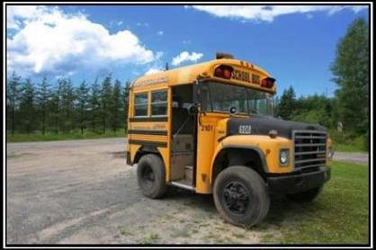

"Field trip- everybody get on the bus,we're all going to Mike's place- woo-hoo!"
Y'all can swing down this way and pick up Mark and myself, then we can go across Tennessee and get Joe, other Mike, and Mack.
Eveybody???
This thing looks tiny for.
At least you need to add a bus trailor to it.
