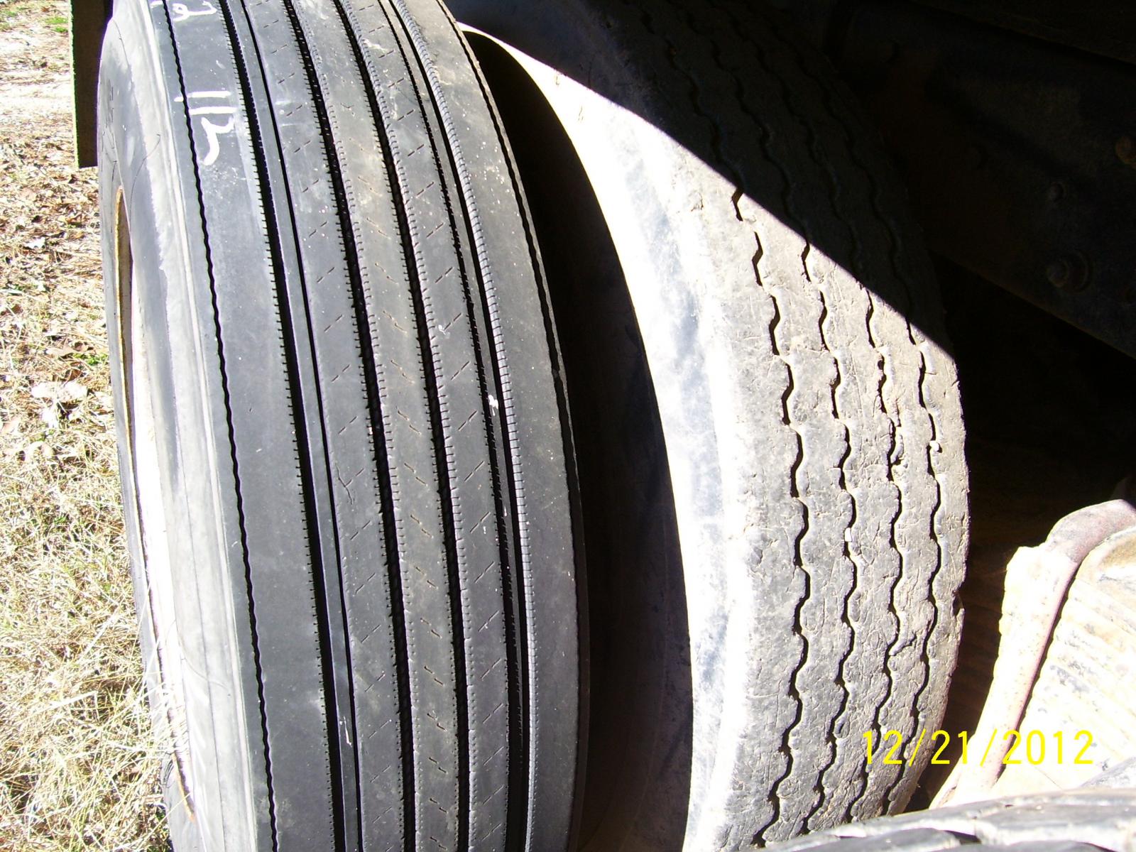

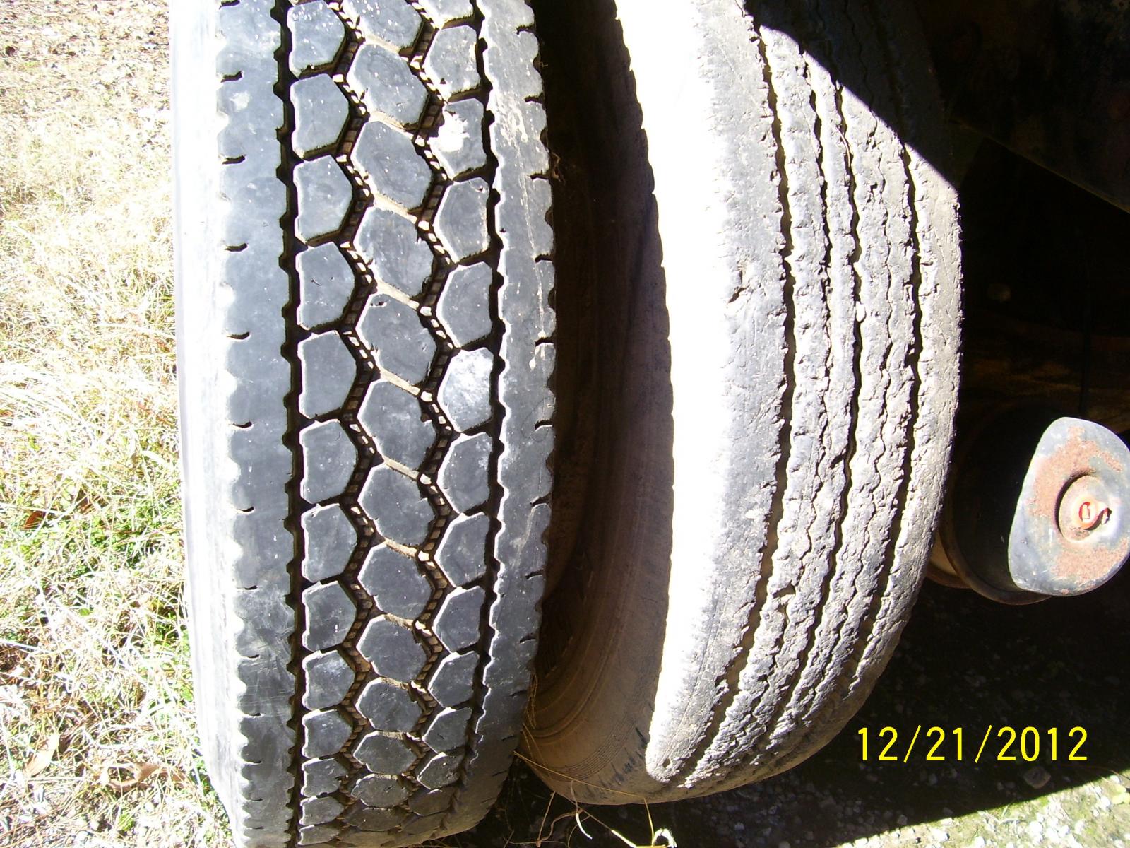

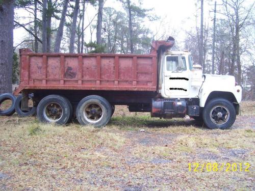

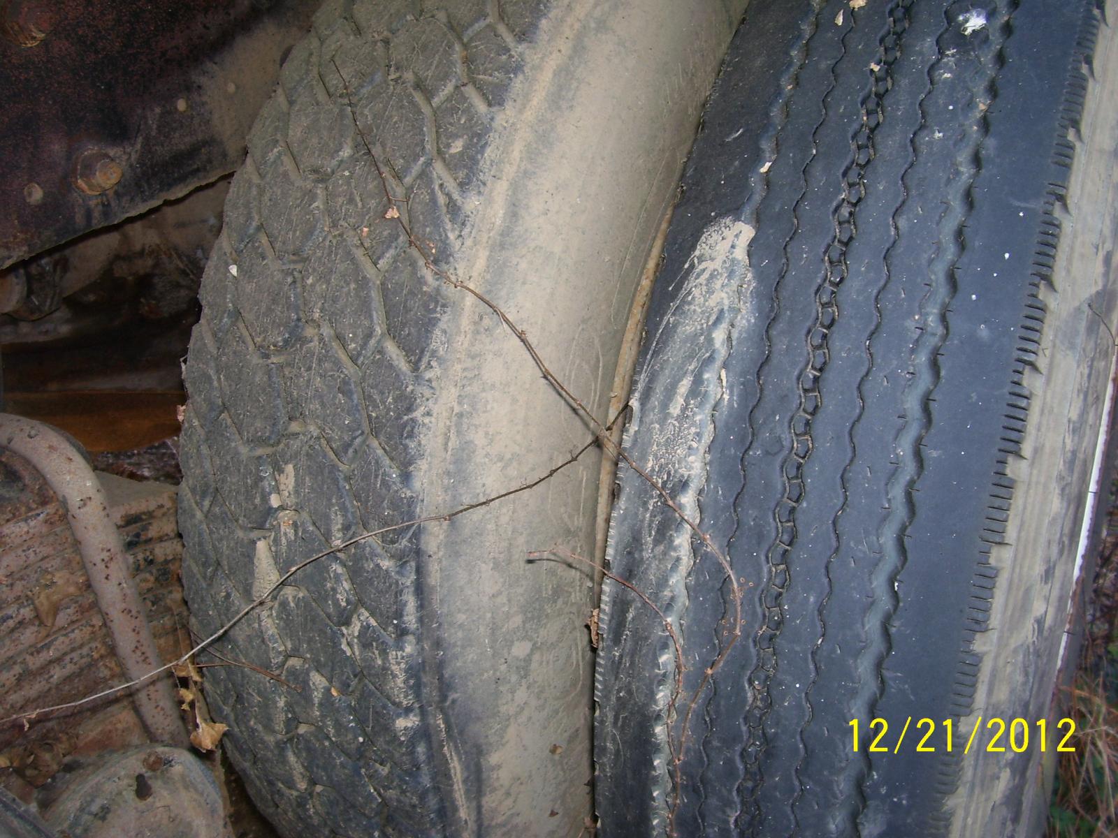

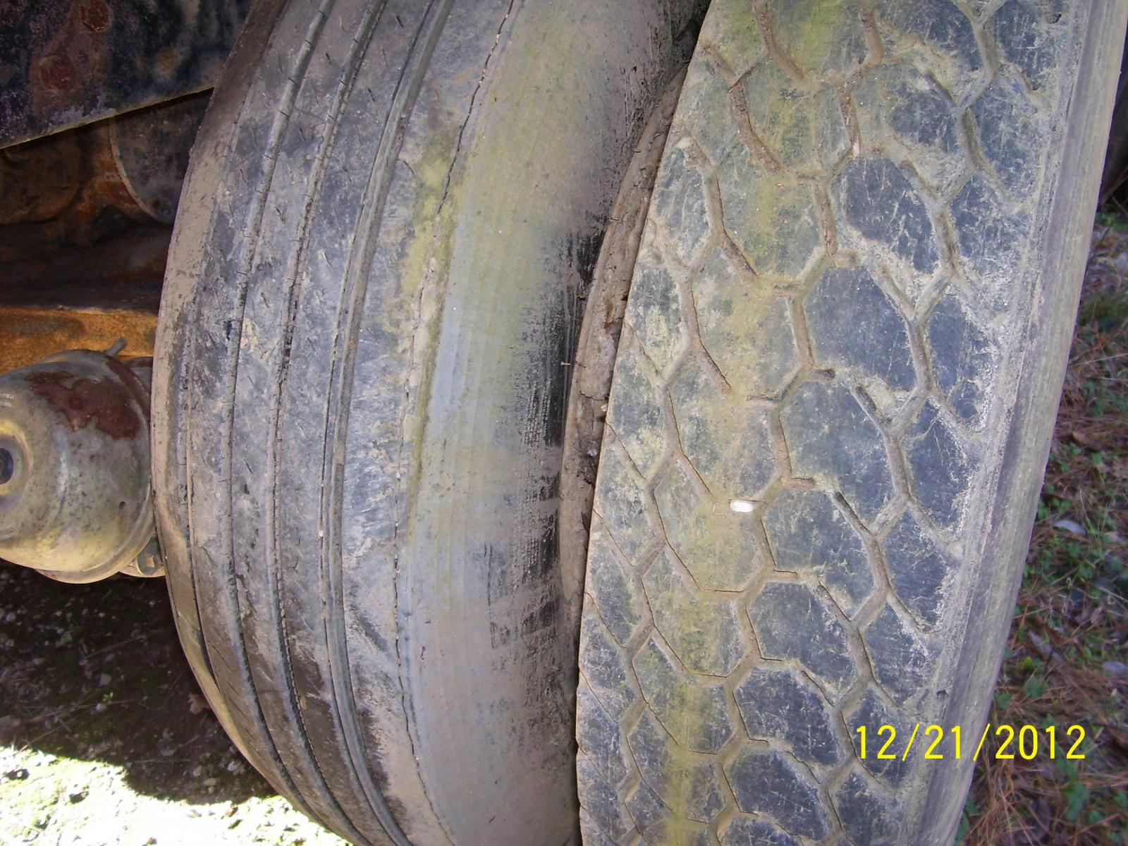

I'm looking to buy a 1985 R686ST tandem axle dump from a guy I know. He told me he recently replaced some of the tires with some new problems. Problem I see is he mixed steer tires with drive tires on the rear tandem axles.
Now I'm hardly an expert, don't really know nothing. Don't drive'em yet, just buy and sell'em. Seems like to me somewhere in the past somebody told me you wasn't supposed to mix tires. I looked at a couple of other places on line and several said it was okay to mix them, just don't put drive tires on the steer axle. Felt like I needed to here it from you guys also before I could be sure. I mean if I buy the truck I want to know if I'm going to have to spend more money on different tires cause that's going to affect my offer.
I posted some photos of the rear tires for you to look at and give me your opinions. Thanks

looks to me like he used up every oddball spare he had just making sure they had enough tread to pass inspection,As long as the tires are the same height,it won't hurt,but if you are buying it to resell,those tires won't help you a bit,unless of course you are putting it on a boat.
I don't thank it will hurt anything, as long as the drive tires aren't recaps and the stears are of course not, usally a recap will be a bit taller. But like the other guy said it will hurt you when you go to sell it, not something i would do, if it were me i would at least try to find some deccent used drives for it.
Yep, anything to make it roll was my impression. Thanks guys, that's gonna help me alot in making my decision. Now I know I "could" use the tires if I "had" to. Problem is, I don't want to. I've got better tires I can use to make it right. Now I know I can use them to get a better price on the truck cause it needs some work.

As stated above tire height is the issue if one is taller than the one next to it the tall one gets more weight and heats up faster, also you dont want tire height from front to rear axle to be off by much, if the front axle has 40" tall tires and the rear axle has 42" tall tires the rear axle is turning slower and if the power divider is engaged that leads to Broke stuff! One inch in height is a lot in rotational speed, just so ya know!
I think they're all 11R24.5 tires but I'll be sure and check them to be certain. I've only sold a few trucks but one buyer did want some tires changed before the deal was sealed.
