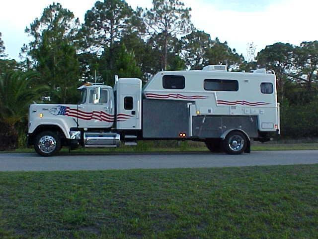

In 2006 while still working on the fire trucks I bought a 1986 RW613 tandem day cab tractor.
I removed the 38K tandems, stetched the wheelbase to 275" and put in a 20K Rockwell rear with air suspension and 3.54 gears.
Added a 3 man crew cab and built an aluminum body to carry an 11ft. camper and lots of storage.
I went thru everything on the truck from radiator to rear U-joints replacing everything that was worn. Also did a custom red and black interior.
The drive train consided of an E6 (4 valve) 350HP with dynatard which got from a wrecked truck, Spicer clutch, T2090 trans and the rockwell rear.
I used this rig to tow my 28ft. dragster trailer across county many times, traveling to Nostalgia drag races cruising at 65mph @ 1400RPM averaging 9 mpg. What a great truck!!!

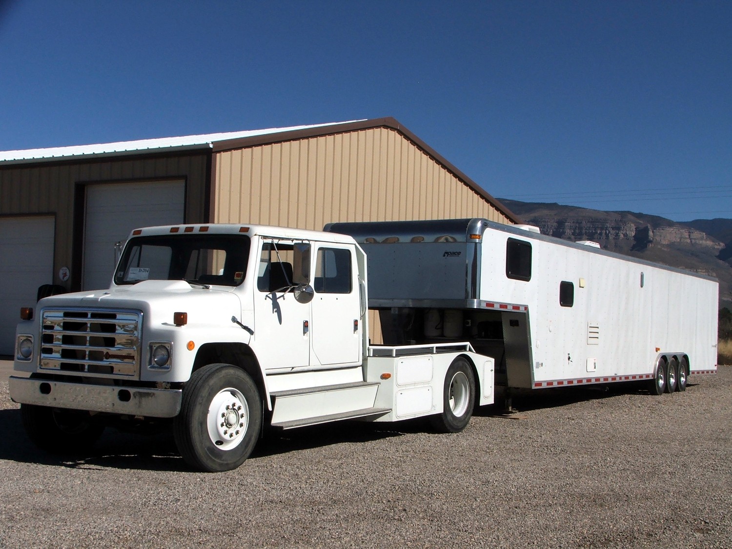

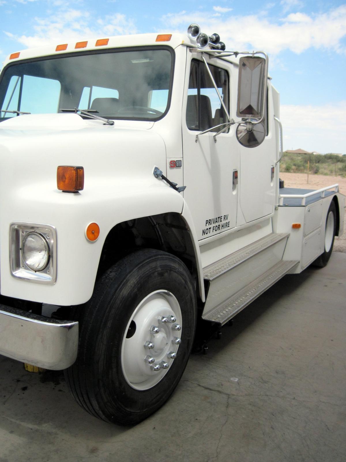

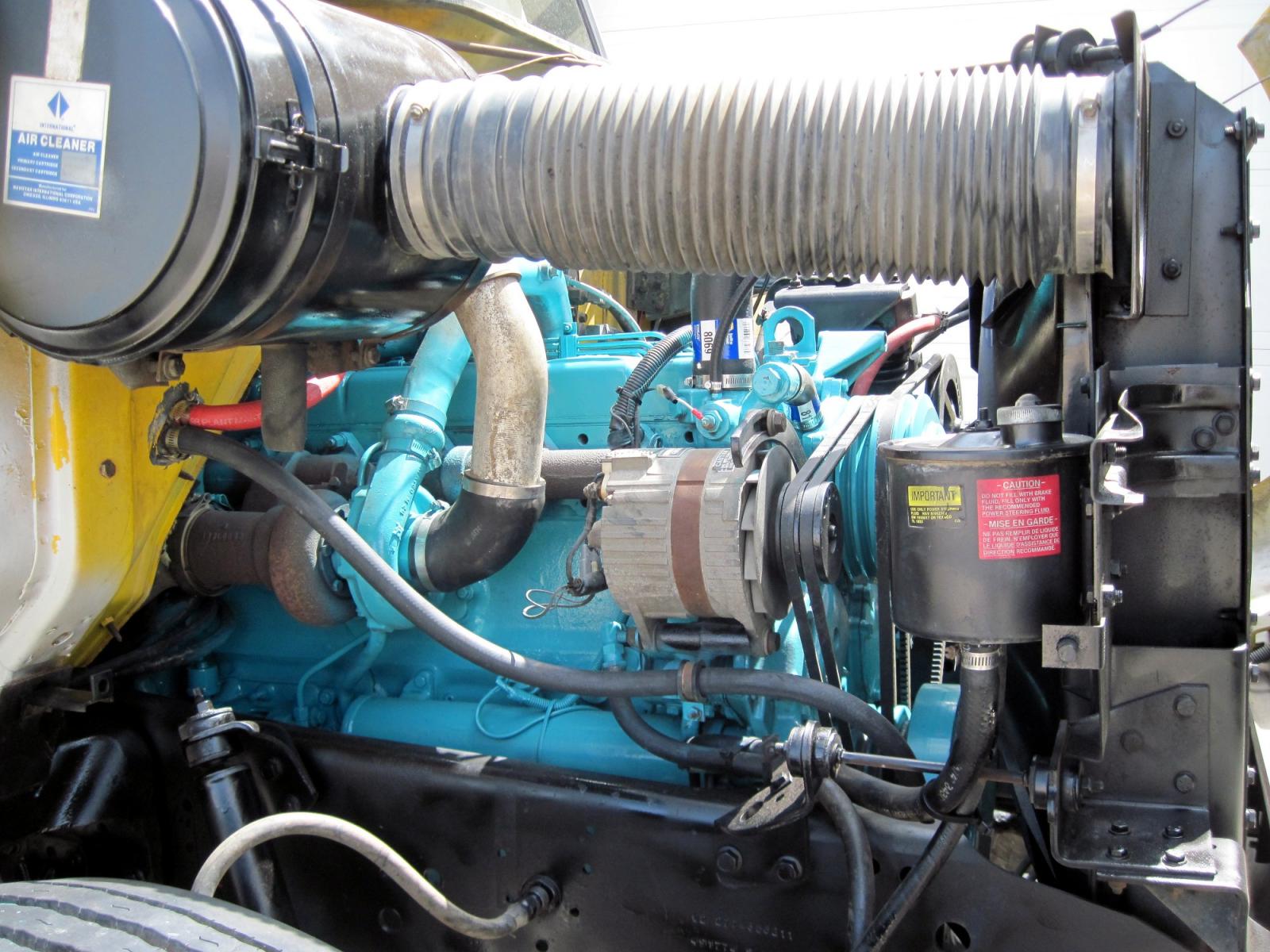

Hi everyone: It's been a while since I have posted. Have been very busy around here considering I'm supposed to be retired.
Was unable to find a decsent B61 to haul my race trailer so I settled for an 89 International S1900 with a DT 466. Truck only has 120,000 original miles.
Just finished detailing engine bay with all new hoses and new clutch. Next will be a ring and pinion change from 5.29 to 4.11
