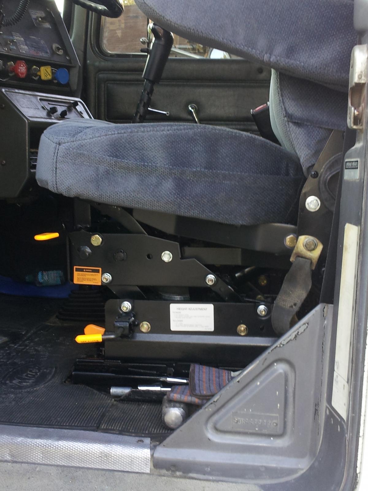

The Eldorado was one of the most comfortable (to me) & also the most misunderstood seat when it was introduced.If you tried to adjust like a Bostrom,you were going to get a crappy ride from it.Seems anybody who had to move my truck failed to see the little yellow lever that "lift to adjust" (in conjunction with the air valve). They have eliminated that,and hopefully corrected many a drivers view of that seat.I ran that seat in my truck for 7 years & replaced it with their "El Camino" seat,which I thought was a good one also!
we had both seats, look at my post on the eldorado vip seat and youll see all the headaches i went through to get one. They havent changed much it, just the air switches are on the left (3 of them) the height adjust yellow knob on front and the anti slider knob, just adjust the height all the way to the top then let all the air out of it, then the raise it just enough (prob 1-2 inches so you are still slanted then adjust lumber support and you got a solid R model with air ride cab and best seat in my opinion. Only way i could drive my truck is with this seat :)

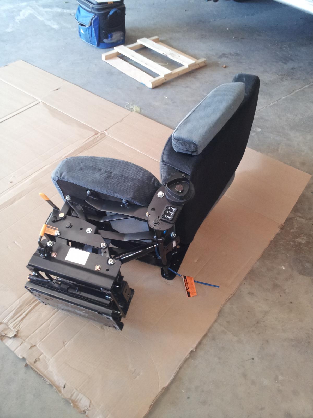

Here is a pic of the seat
That thing certainly looks alot more comfortable than my old bostrom. How bad did it set you back? Do they have one in gray?
