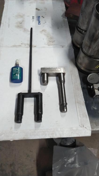

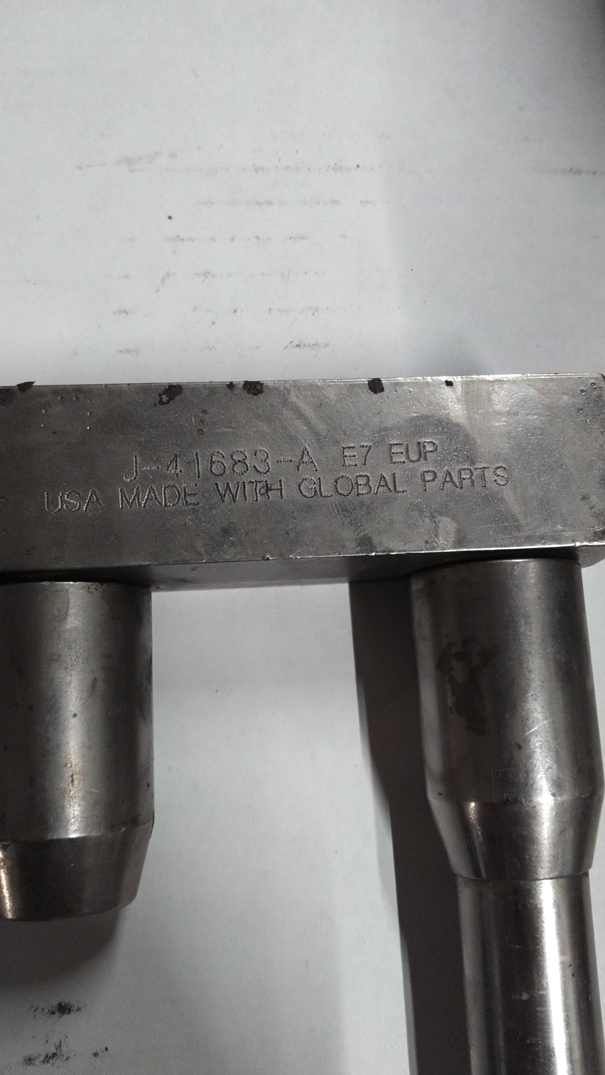

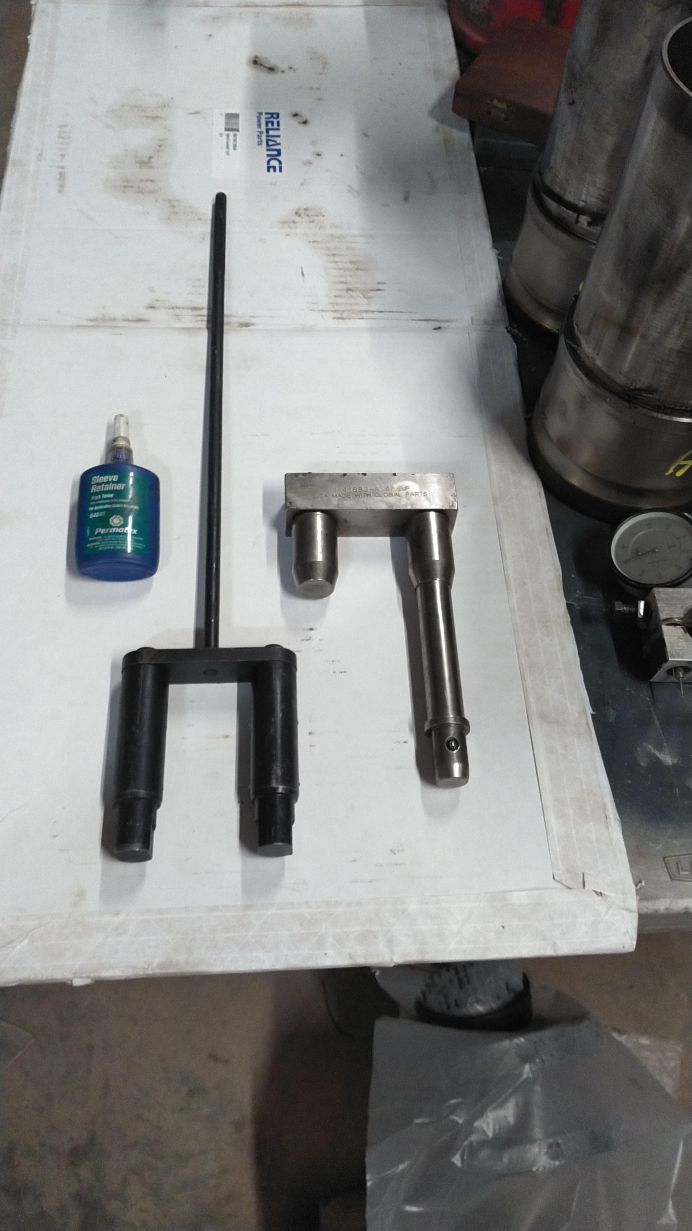

If you believe they have moved,,,,   Replace them !!  there are 2 essential tools for this job..  the long black one is a depth gauge and alingment checker.. It is used from the bottom with the pan down..  the silver tool can also be used to check them when the heads are off..  It is the tool you need.. it is also the installer..  there are 3 types of H-rings available, std.  and 2 that are oversized.. I think one is .002'' and the other is .005''..  they are for bores that had H-Rings move..  the 3rd thing you will need is the sleeve retainer fluid..
''Winging this repair will cost you a cam shaft and all the labor to pull the heads and do it right..   It only takes 1 miss-aligned H-ring...  Jojo
