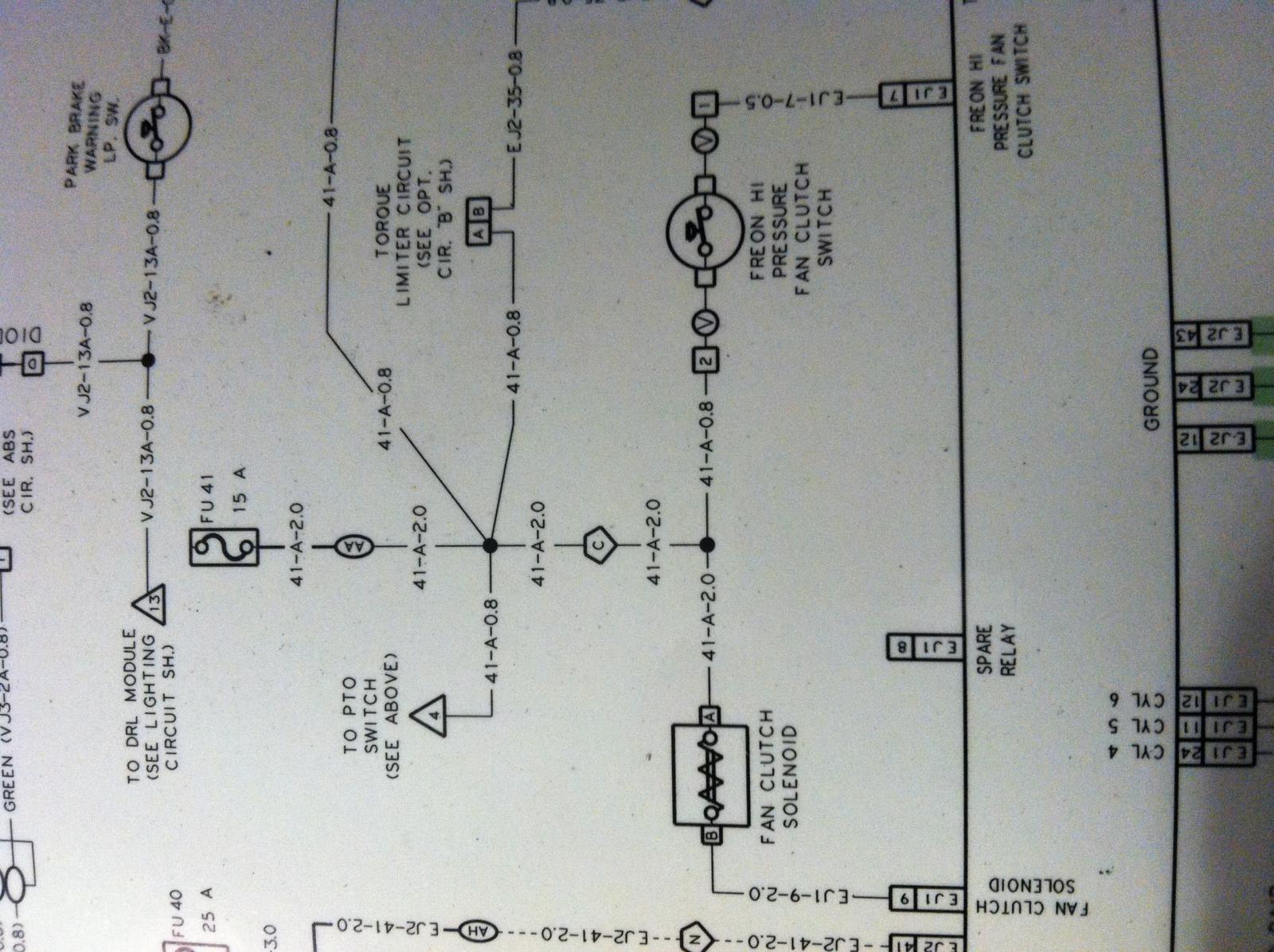

The ecu is what sinks the ground to terminal b at fan solinoid , the a/c high pressure switch is normaly closed and is forced open when you have high a/c pressure in system , when it is forced open the 12 volt signal to eecu is disconnected , when ecu sees this its keeps the eecu from sinking the ground to the terminal b at fan solinoid and engages the fan fuse 41 supplies 12 volts to the high pressure switch coolant temp switch = when ecu see high temp turns fan on this is a ohms reading to ecu .

So are y'all saying it is a sensor issue or a wiring problem. I know a lot about the mechanics of the truck but I get stumped on the electrical side of it. Do one of you guys have a scamatic on how the power/ground is sent to the solenoid? Please help as I would like to get this taken care of soon!!!!
