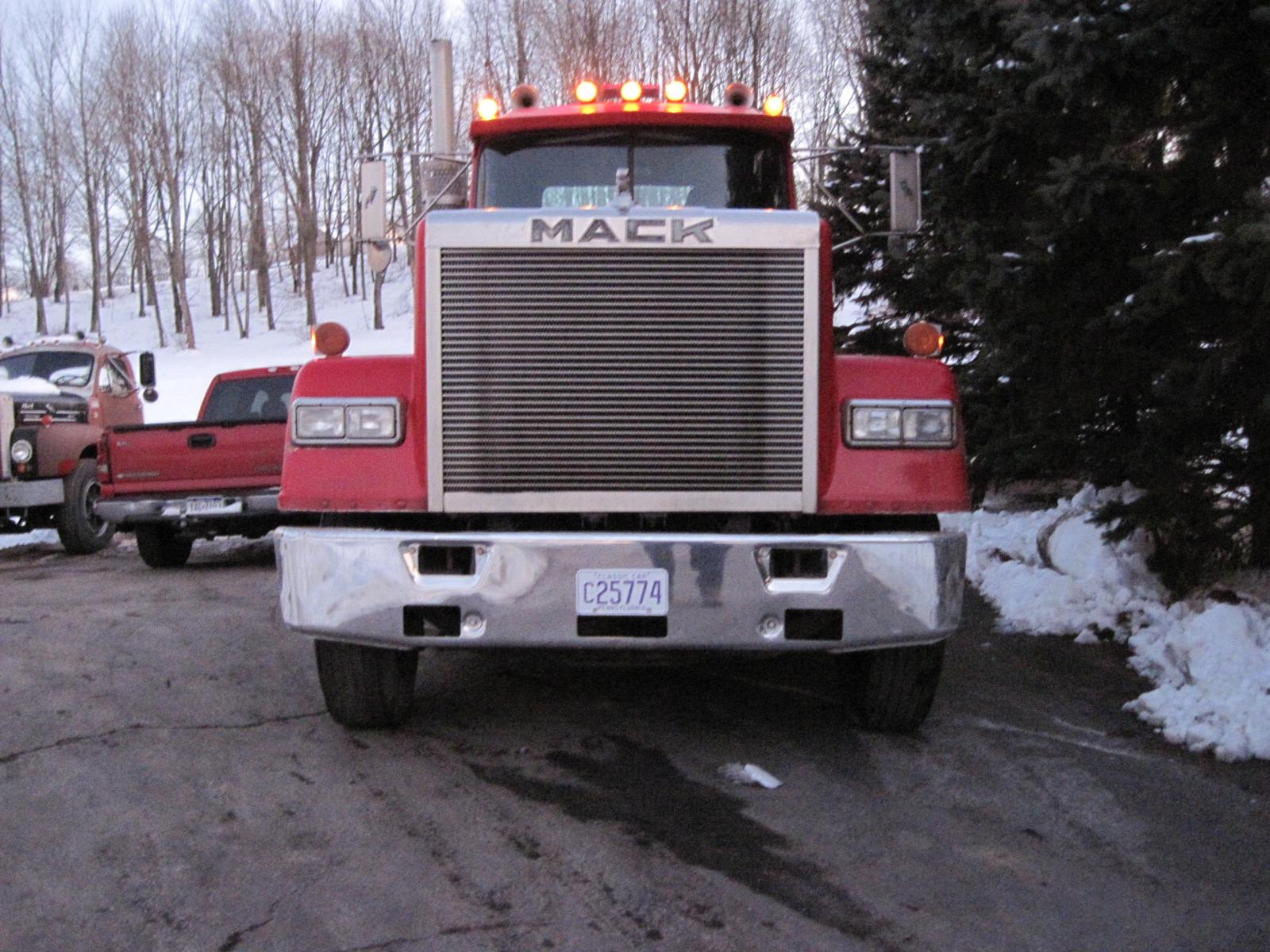

I notice in a lot of my pictures that people have the classic license plate on the front? I cannot find anything in the regs that mentions where to put the plate...any reason to put it on the front?
Thanks
Also, a classic truck needs an annual inspection, does a normal car inspection shop do this? Do they issue a normal car sticker? I cant find any pictures of classic trucks that have a normal inspection sticker in the window...
Thank again!

There are no instuctions where to put the plate, so we followed the pattern of regular truck tractors, after all, you can still pull a trailer. Good question about the inspection, never thought about it, but we always had a commercial inspection mechanic do it.

daveigou,you bring up a good point.You say that we can still pull trailers,I was always told that once you put antique tags on your tractor you could not pull trailers anymore.I have the antique tags on my 79 R-model but I still pull trailers anyways.I just keep my toes cross when I get stop.My insurance company is ok with pulling trailers as long as it not for work,play only.Mike Durkin

We had used the same logic that since they were tractors the tag went on the front, but I had a state cop come up behind me on 422 while driving my father's B85. She asked over her PA where my license was. I pointed to the front of the truck. She replied that it should be on the back and drove off. It is still on the front of the truck. Since then we put the license on the back of the truck if it has a bracket, but on the front if it doesn't.
As for inspection, I doubt a car mechanic would inspect a Superliner. They would probably not be equipped to pull wheels and such. My father takes his to the truck garage. I'll text you a picture of the sticker. He likes your New truck. So do I.

I was told by the Indiana DOT that that I could do my own annual inspection on my truck and trailer, but must have the forms. One is to be kept on file the other kept in the truck.The sticker was an option. I have done this for over 14 years with no problems yet. I travel the midwest and east. If you are serious about safety who knows your truck better than you ?

We just got the Antique plate for the binder day before Christmas. MV-11 form says no trailer hauling with an antique plate, but if it is to shows and the like, I'd bet there'd be no problems. Hagerty insurance was quoted around $100 for the year with $10K coverage(I've got 5 cars on that policy). The plate was $75 for life!

Don't know about PA but NY issues a pair Historical plates and requires an Annual Safety Inspection for them. Over 10,000 GVW in NY an inspector needs a Special Endorsement to do it. An improperly issued sticker can be picked up if the Officer has an attitude. The sticker is revoked on the spot and a $1000.00 fine for improper inspection can be given
My N.Y.S. inspectors license as issued is Good for all vehicles 10.000 and under, Antique included. I needed a class for an Emissions Endorsement for the NYMA, a class for Motorcycle Endorsement and a class for Medium and Heavy trucks with Emissions Endorsement. The NY inspector needs a Heavy Truck Endorsement to even do Antique Trucks.

MV-11 dosnt say anything about trailers...it says and I quote "...Although buses and trucks are eligible for Antique and Classic plates, buses MAY NOT be used to transport passengers and trucks MAY NOT haul cargo."
I interperet that as not being used for commecial purposes...depends on the lawyers I guess if push came to shove!

This is a gray area. Cargo is a commercial term. "items transported for commercial gain" Like it's been discussed in other topics for licensing and registering of antique trucks in Pennsylvania it's a gray area but drive and maintain the truck as you would a commercial vehicle. That means also having a CDL and if you're hauling a trailer to have a class A. I say this because if you were to be stopped by DOT or PUC at least you could argue in your behalf as being operated as a professional and property licensed driver. As far as the location of the of the license plate per PA CODE "§ 47.2. Location.
(a) Single plate. A single registration plate shall be located on the rear of the vehicle so as to be illuminated by the license plate light required by 75 Pa.C.S. § 4303(B) (relating to general lighting requirements), except that the registration plate of a truck-tractor shall be located on the front of the vehicle.
(B) Two plates. If two registration plates are issued for a single vehicle, one registration plate shall be located on the rear of the vehicle as prescribed in subsection (a), and the other on the front of the vehicle.
Source
The provisions of this § 47.2 adopted August 19, 1977, effective August 20, 1977, 7 Pa.B. 2361; amended April 17, 1981, effective April 18, 1981, 11 Pa.B. 1327; readopted September 8, 1989, effective September 9, 1989, 19 Pa.B. 3828. Immediately preceding text appears at serial page (95331).
§ 47.3. Manner of attachment.
Every registration plate shall be securely fastened to the vehicle:
(1) So as to be clearly visible.
(2) In a horizontal position.
(3) At a height of not less than 12 inches from the ground, measuring from the bottom of the registration plate.
(4) So as to prevent the registration plate from swinging."

Doh, I have my front plate on a hinge(like all the cool trucks used to). But I'm an Outlaw...............LOL!
I put 33K plates on my truck originally(knew I would be over 26,001#), and it was like $375/yr? Way more then I wanted to spend. $50 got me historical. DMV was not too happy to do it, but I told them all my buddies have theirs. They reluctantly agreed, but told me "I better not be running commercial with it". Well duh.
