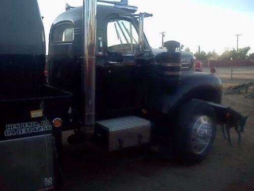

The only issue I see with someone putting a B onto an R chassis is the fact the front axle is too wide and the tires stick out. Livable, seen a few like that. Just not my cup of tea.
The ones I've seen have jacked the cab up a few inches to clear stuff.

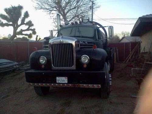

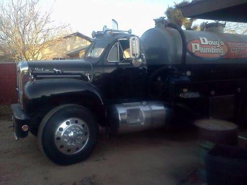

Ha,Ha! When I went to our local Mack dealer for parts (for the BCR),the guy at the counter new nothing of the BCR kit and told me they should have made a RCB kit to convert R's into B's! Seriously folks,there was a honey wagon at Macungie a few years back that was a B mounted on an R chassis, I believe.It was on eBay a while ago, and it had ended up in Californy,I think?.post-510-0-36246700-1357015819.jpgpost-510-0-22048500-1357015849.jpgpost-510-0-77310000-1357015903.jpg Kevin All did one HELL of a job on that B-75 he sold to Kevin Stark.That one is built on a newer chassis,I don't know what model it was on though.
Matt Pfahl's B has a Super-Liner front axle under it,and it doesn't look too bad.
yup, he said it was a pain in the ass to put in tho cause the holes for the springs are about a half a hole off. it can be done. i remember the honey wagon at Macungie a few years back to. not sure if its the same one or not. the one i remmeber had a Pete battery box set up on it.
