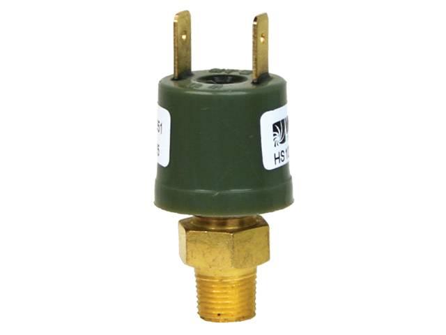

aka trolly handle, depends where your from, the switch is plumbed into the brake treadle valve should be near it some where close under the truck it should look something like thispost-10018-0-17684800-1357229221_thumb.j

A hand valve (Trolly Brake, Johnson Brake or Johnny Bar) is fitted on the steering column or the instrument panel so the driver can apply the trailer service brakes independent of the towing vehicle’s brakes. When the hand valve and brake pedal are used at the same time, the trailer will receive the higher pressure. Using the brake pedal or hand valve sends air pressure through the trailer service line. This will activate the brake lights also, that is why I asked if the lights come on with johnny bar applied, if it does then you have to track down that issue if it does not come on then it is probably the switch or connection.

Yeah bulbs first, then brake light switch but if there is no power at the brake light switch its a fuse/ circuit breaker or relay and yes there is a fuse or circuit breaker for the brake lights on your truck somewhere.
