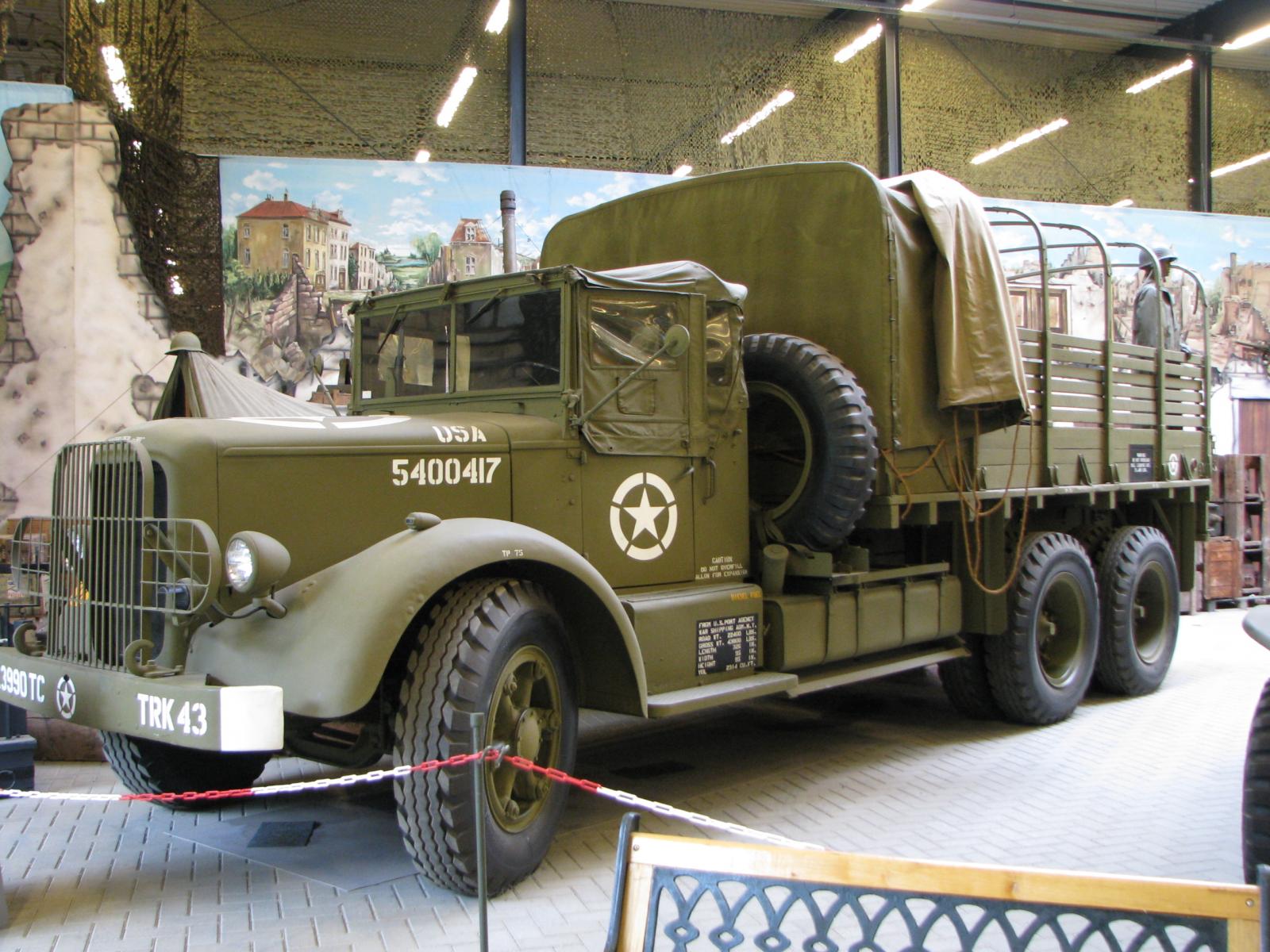

am I the only one who don't know what's the model of this truck? :blush:
This is ex-army NR-14 of 1945.
I hope it would look like this one day

It's :mack1: of course.
Model NR, produced during WW2 from 1940 until 1945. Most were supplied under Lend Lease to Great Britain, Middle East, Australia and other allied countries. Some also came to Russia, probably 700 units. The one I'm working on is from that bunch. Only one survived as I know. NR model was basicaly the same as L, something like LGSW or LJSW. I'm trying to relate them by some units and weight ratings but it's a reason for one more thread. As you know commercial truck's production was interrupted on Mack from 1942-1944. So interruption of current L series was filled of similar kind NR and NM militaries.
