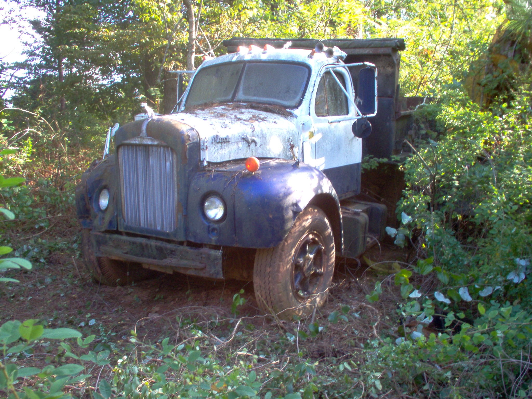

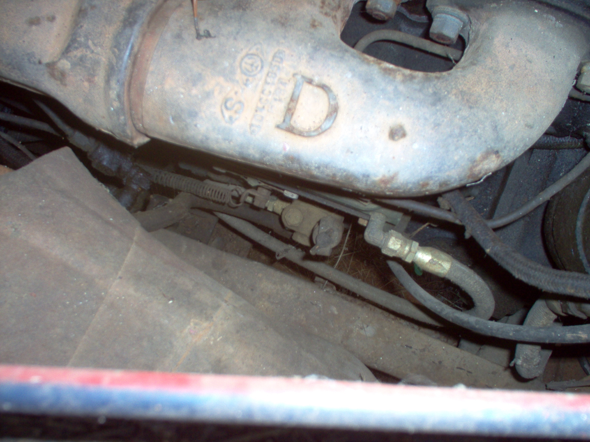

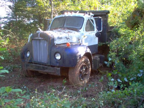

I have a 1958 Mack Dump Truck with a six cylinder Diesel engine. It has two battery carriers, one on each side, behind the saddle fuel tanks. I believe I had two batteries in each carrier, for a total of four batteries. I do not remember if they were 6 Volt or 12 Volt. I am going to try and attach a picture of the truck and of the engine, so you can tell me what the model number of the truck is and if the engine is a diesel. I could not attach my pictures, because I do not know how to give them a URL.

Looks like a B-67,a diesel.There is no VIN tag inside the passenger side door?The VIN number will be on the frame on the R.H. side,between the front spring's rear hangar and the air line to the brake.Those used 4-6 volt batteries,2 in each side in series.
