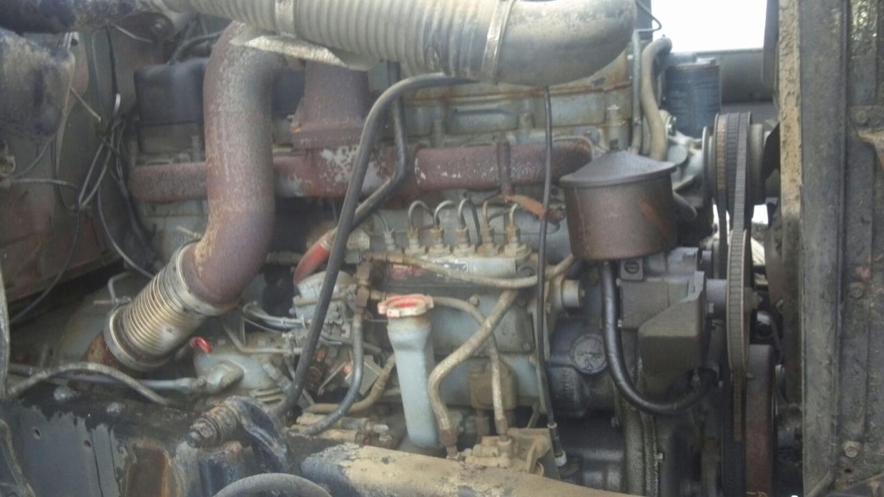

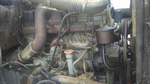

If it is a '300' it would be an 'Econodyne', I think it should have a two piece cast aluminium intake manifold and radiator mounted charge air cooler. It's got the old pressed manifold, looks like a '237'
Around the mid 70's Mack shortened the engine ID's to things like T673C, T675. If it is a '300' I think they came out about 1980, it should be an 'EM6 300' or an 'E6 300'

If it is a '300' it would be an 'Econodyne', I think it should have a two piece cast aluminium intake manifold and radiator mounted charge air cooler. It's got the old pressed manifold, looks like a '237' Around the mid 70's Mack shortened the engine ID's to things like T673C, T675. If it is a '300' I think they came out about 1980, it should be an 'EM6 300' or an 'E6 300'

Since this truck was reportedly a 1970, then there should be an "old" designation on it, like ENDT-675. They did start dropping off the END part at some point. In fact, mine is a '70 with the original engine (S/N verified off the build sheet), and it has already had the END prefix dropped. So, that started a pretty long time ago.
Oh, and it DOES, indeed, look more like a 237 than anythiing else. Doesn't it?

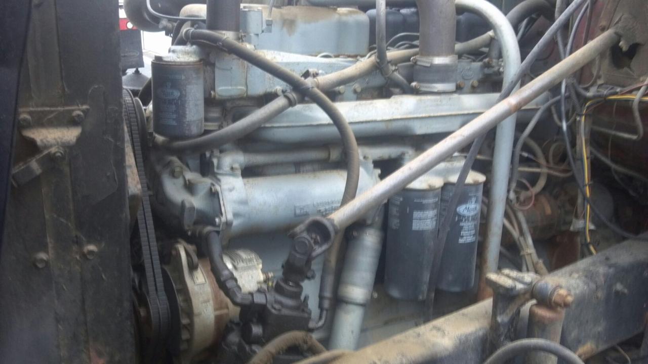

It certainly looks like a 237 to me. you might have to take off that steering pump and bracketry to read the engine number. It looks like its only got 2 oil filters and the small coolant filter, the tin intake manifold and the way the turbo is mounted looks to be an early design. It certainly wont be a 300 without some sort of intercooler..

It looks like a 237hp .If i recall the highest horsepower of a non-cooled engine was 250hp.This was later in the seventies ,though.Its an old though late 60s-mid 70s with the steel intake,dual oil filters,head studs(not capscrews) and the what I call a 6BB pump. Heck it might even have a push type clutch.
