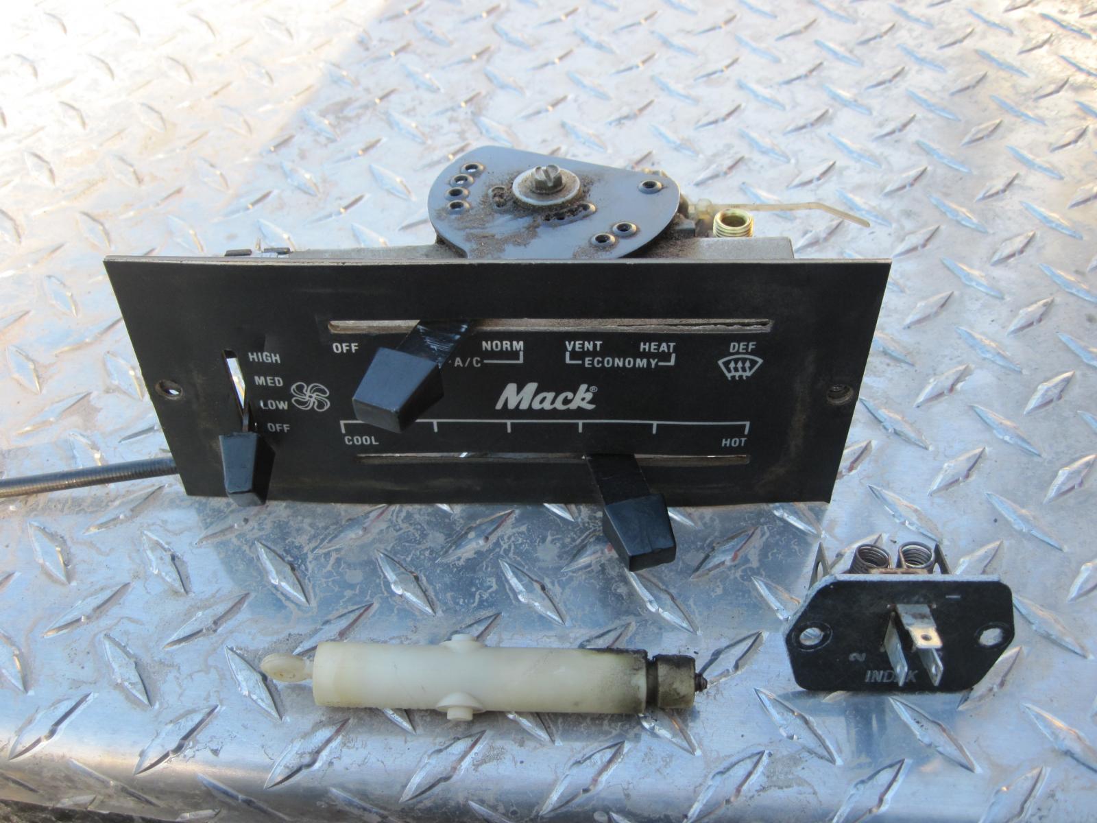

Worked on the heater today...fan only runs on high, air switch leaking, can't control heat etc...went all in and got a new heater module, a couple of pistons and the fan resistor...when I was finished, of course, had to do a shakedown run...about 60 miles!
post-6773-0-23543600-1358644578_thumb.jp

I got a question about the controls on the r model for heat and ac. When everything is off it makes a faint hissing air noise the whole time, the only way i can get it to be quiet is to shut everything off but have it on defrost mode but then the hood scoop pops up and has to stay up. when i use the heat controls for vent and heat i get the hissing noise that is faint. When i use a/c though the sound is gone. What part can cause this?
We had/have the same problem, your gonna need a new control panel for about $150 and probably the little air cylinder

My truck leaks air when its not in the off position, and I cannot get air to blow out of my defrost when selected, however the Compressor does come on. If I change the "Mulit Position Air Switch" will my defrosters work? I do snow removal with this truck and it sucks to have no defrost!
Check to make sure you have air going to the cylinder and if you don't its probably the "Mulit Position Air Switch" and if you do it is probably the mini air cylinder
