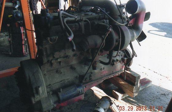

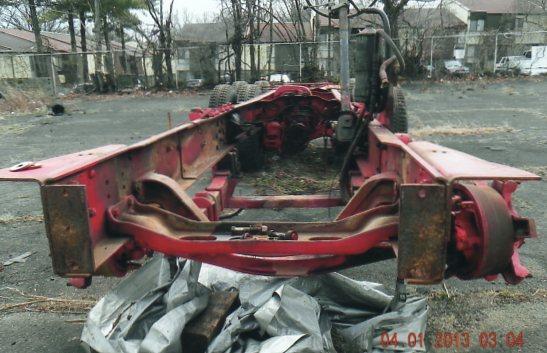

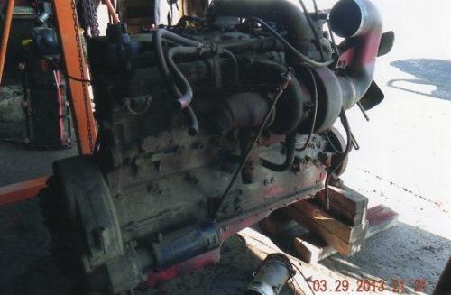

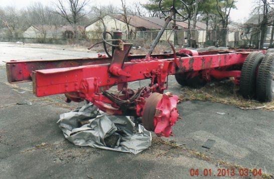

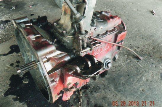

Here are some shots of my latest efforts to get this old girl back up and running.First one is the motor(cummins nt335),secord is the main trans,and the last 2 are of the frame.I druged it out of the shop to be blasted this week.I'm thinking of doing the front half first then removing the rear tires and doing the back half.I am not looking forwarded to removing the back tires,may have to get the hoist out to help.1200x24's are just to damm heavy to be moving around anymore at any age. Will keep you posted on my progress.Thinking of painting the motor with the Cummins pale brown paint,any throughts?
