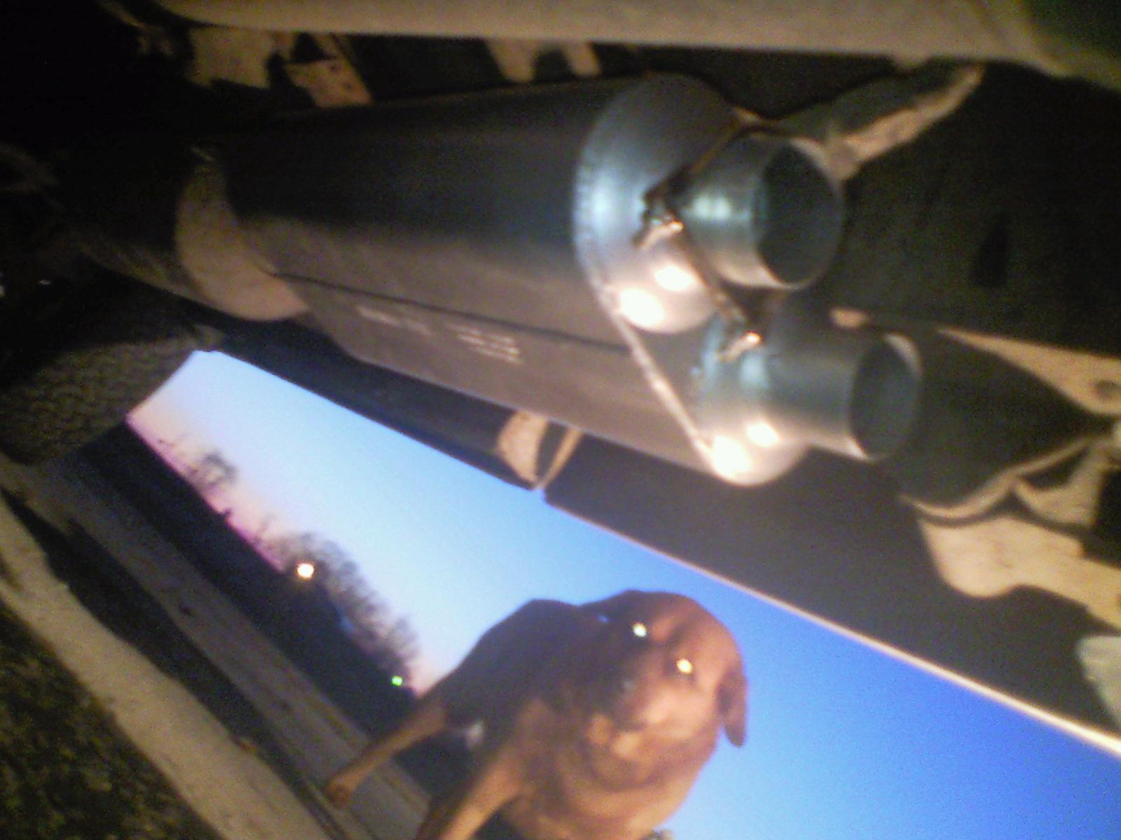

I got tired of patching and rewelding the old muffler back in place, so for the last month or so, the exhaust hasn't had much restriction to it. The big 460 was breathing out into a single 3" pipe, to what I THOUGHT was a catalytic converter (which apparently has either been hollowed out or is actually just a resonator built to look like a cat)...to a 3" pipe exiting the resonator....then about an 18" gap where the muffler USED to be (before it fell out) back to the Y-pipe that split the exhaust into the dual tailpipes. That was it. To say it was loud was an understatement.
Anyway, I bought a Flowmaster 50 Series HD muffler....single 3" in w/ dual 2.5" out. I had planned on cutting out the y-pipe, and tying into the existing dual 2.25" tailpipes...but one was side was missing a tip & I couldn't find an exact match for the one that was still on there....and when I got working on it this afternoon, the tail pipes weren't in as good of condition as I had thought. So, they came out.
I'm thinking instead of reducing the 2.5" outputs on the muffler to 2.25" tail pipes, I'll just run dual 2.5" tail pipes. The old tips were about 18" long and 3.5" wide...probably going to look for something similar. Debating about doing that all myself or taking it to a shop....was quoted $185 from as shop where I was pricing tips yesterday to run the tailpipes from the back of the muffler to the rear of the truck...so if I do that, it'll have to wait until I've got $185 extra to spend.
It IS a LITTLE quieter now...at least I've got a muffler on there. :whistling:

Well I have tried to run my own exhaust a couple times and always ended up at the exhaust shop letting them do their thing. I know an extra $200 is hard to find these days but in my mind its worth it, they have the pipe, the bender, the hangers and the welders so its done right and it lasts longer because of that fact. I say good score on he flowmaster I've had em on several vehicles, they sound great and they hold up pretty good, id go with the 2.5" tailpipes and just get some clamp on stainless 3" tips from summit when you have the extra cash the rolled lip stainless tips make for a clean finished look.
I've never been too concerned with what it looks like....especially an exhaust which is under the truck and rarely seen by anyone. Besides, every exhaust is gonna look the same once you hit that mud hole. I just want it to sound good & not be too restrictive....engine's gotta breathe to make power.
10-4 I have always had 2.5 or larger dual exhaust on my gas trucks till this one, I bought the one I have now new in 2011 and I havent been able to make it all loud right now its quiet and comfy to ride in.
stay 2.5 inch, also just get a couple 90s and flair tips and exit beside the tire, not much $ and will look good, even on an off brand Ford (had to throw that in there :whistling: )
