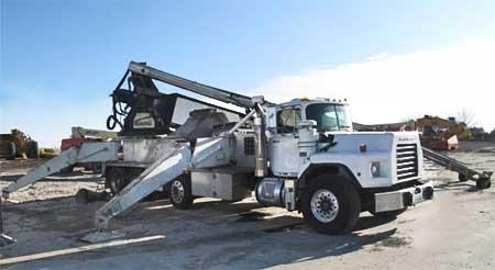

Im having an issue with my 1999 Mack RD688S truck. I hop into the cab and turn the key to ON and wait for the 6 clicks... after the 6 clicks, I proceed to turn it to the START position. Well, the problem I am having is every once in a while when i turn it to the START position, it will make a click sound from inside the cab (relay) Then i will loose all power to the cab. No radio, no lighter, no buzzer, nothing. I'm not sure what is remedying this problem... what I've done to get it to start in the past was clean the battery terminals for one time. I bypassed the battery shut off switch (Bolted it together ... no longer has a shut off switch), and Wiggle the harnesses around for the other times. It just randomly will come back to life and start buzzing. Its very frustrating. the batteries have all been replaced recently, and I confirmed individual voltages on each battery.
If anyone has any thoughts, i would sure appreciate it. I really dont want to take it to Mack and have them fix it. For reference of the model, a picture has been attached of the truck
