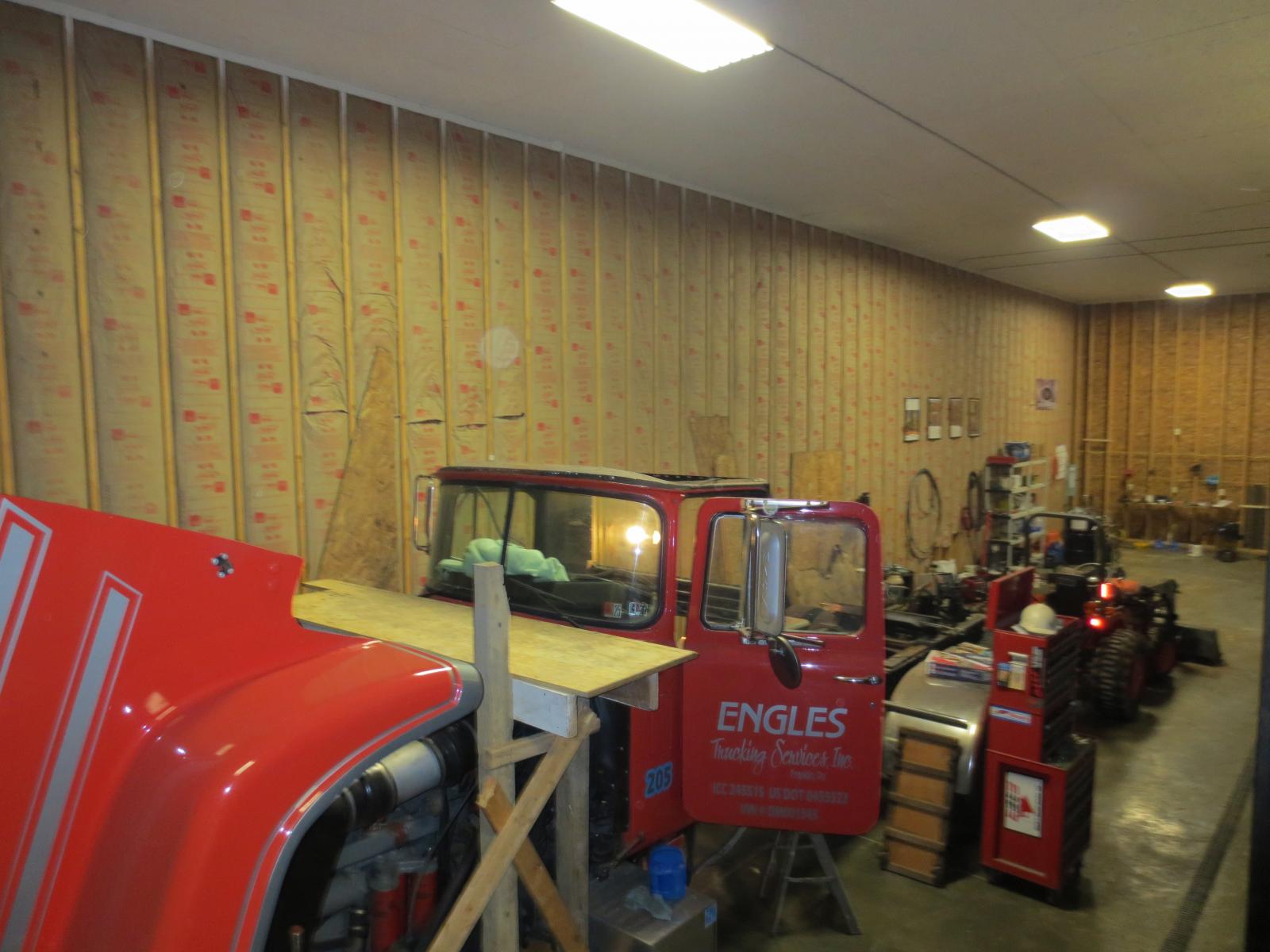

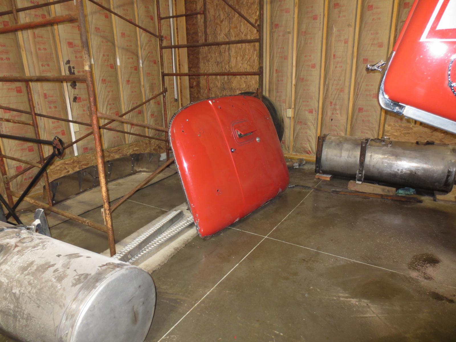

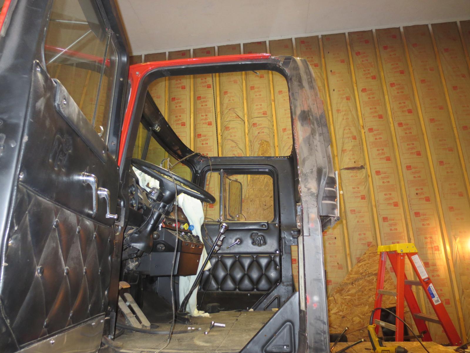

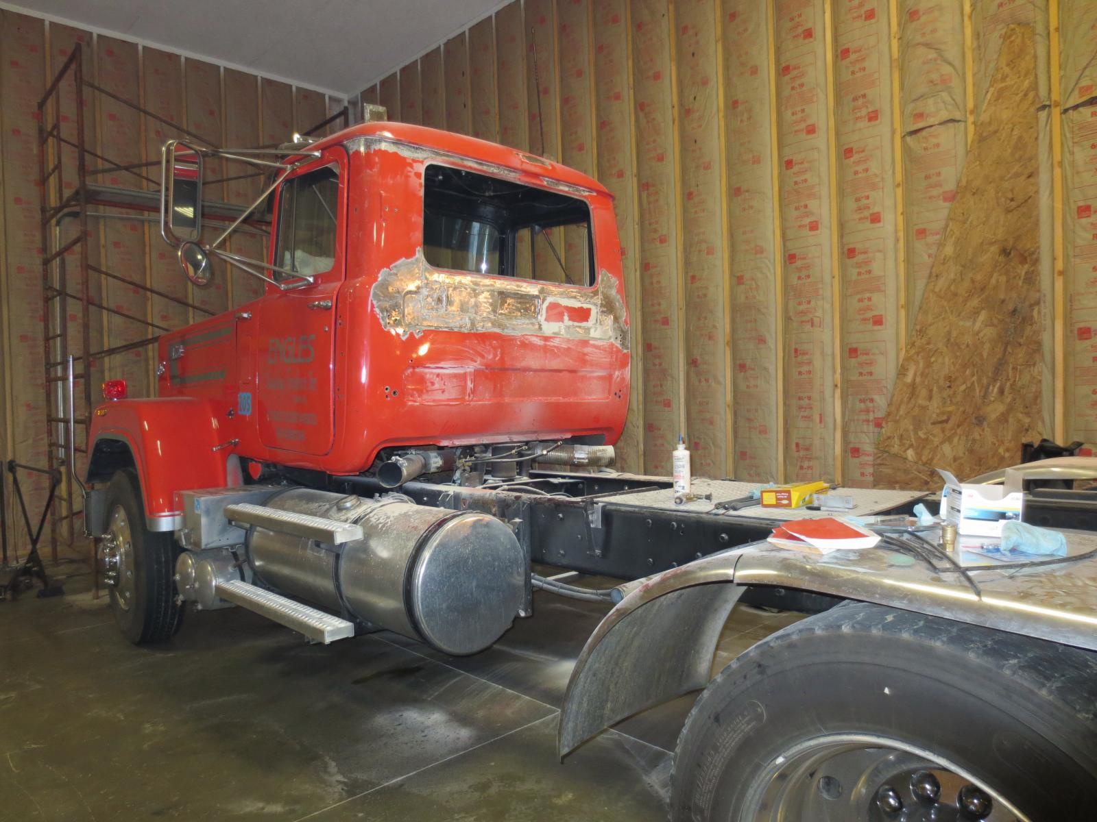

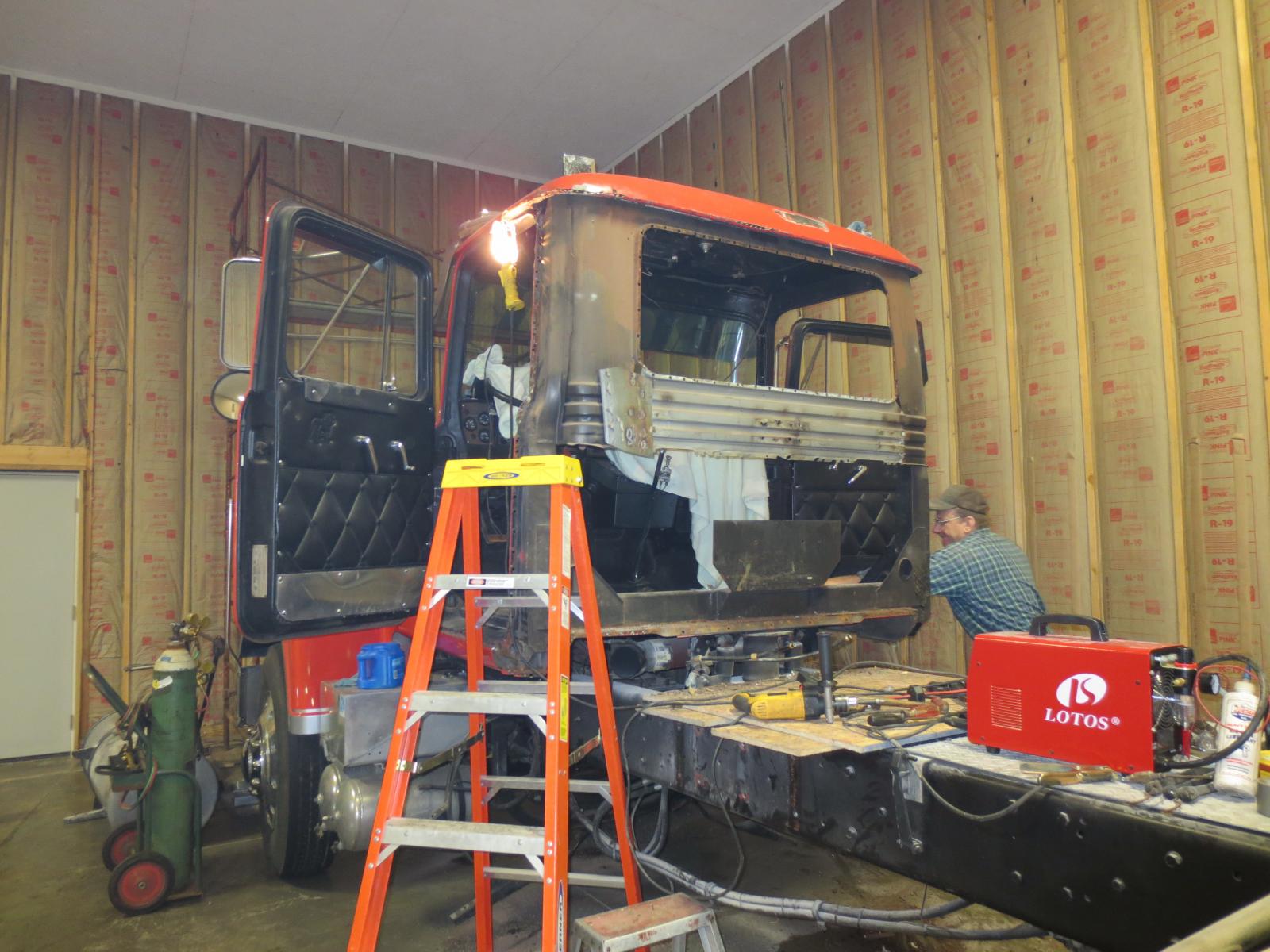

Ended up removing the roof today. figured it would be easier to put back on. roof had some small dents and to many extra holes in it so i figured i might as well replace it to. its only money!!!! Superliner convertable??attachicon.gifmarch 10 2013 001.JPGattachicon.gifmarch 10 2013 004.JPGattachicon.gifmarch 10 2013 006.JPG
I like the door panels, is that a level 4?
